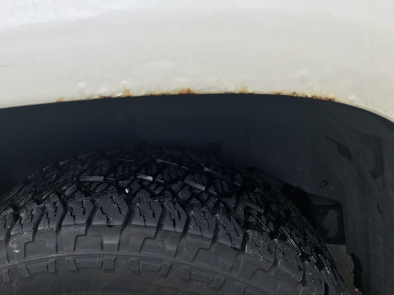

I have rust bubbles and discoloration on the left rear fender. I have zero experience with rust. Is this worth trying to get repaired? I'd love to keep this '09 LTZ but if it's going to rust out I'll plan on upgrading.

I think you will find very mixed opinions on this subject.
While our brethren to the North of the Mason-Dixon will probably look at that pic and say "What rust".... those of us further south would look at your pic and say "she's eat up with cancer and it's only gonna get worse".
I guess it all depends on your location and financial situation as to what you want to do.

If it's mine I fix it now and move on if I like the vehicle. Other folks would be quick to send it down the road and move on to something else. It all depends on what you want to do. I wouldn't put off fixing it for too long, though, because it'll just get worse and more expensive to repair with time.

At this stage it'd be an easy fix for a body guy to repair.

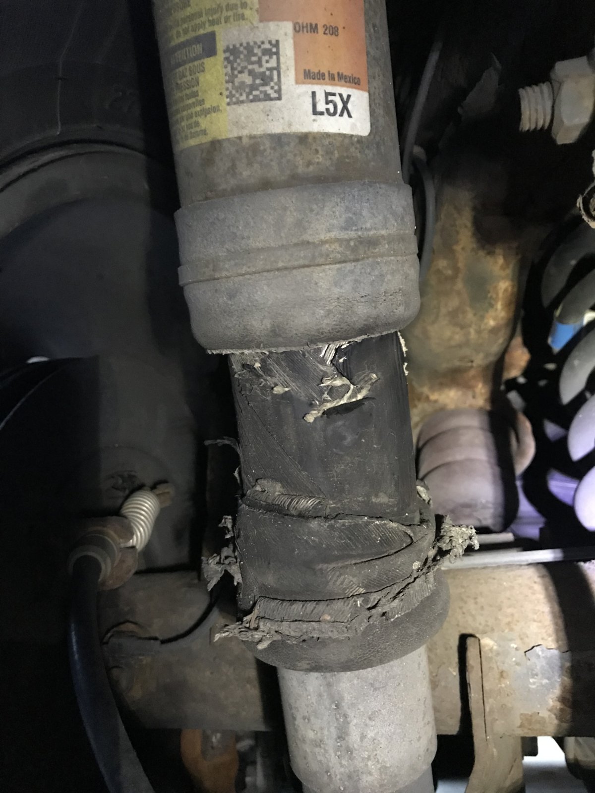

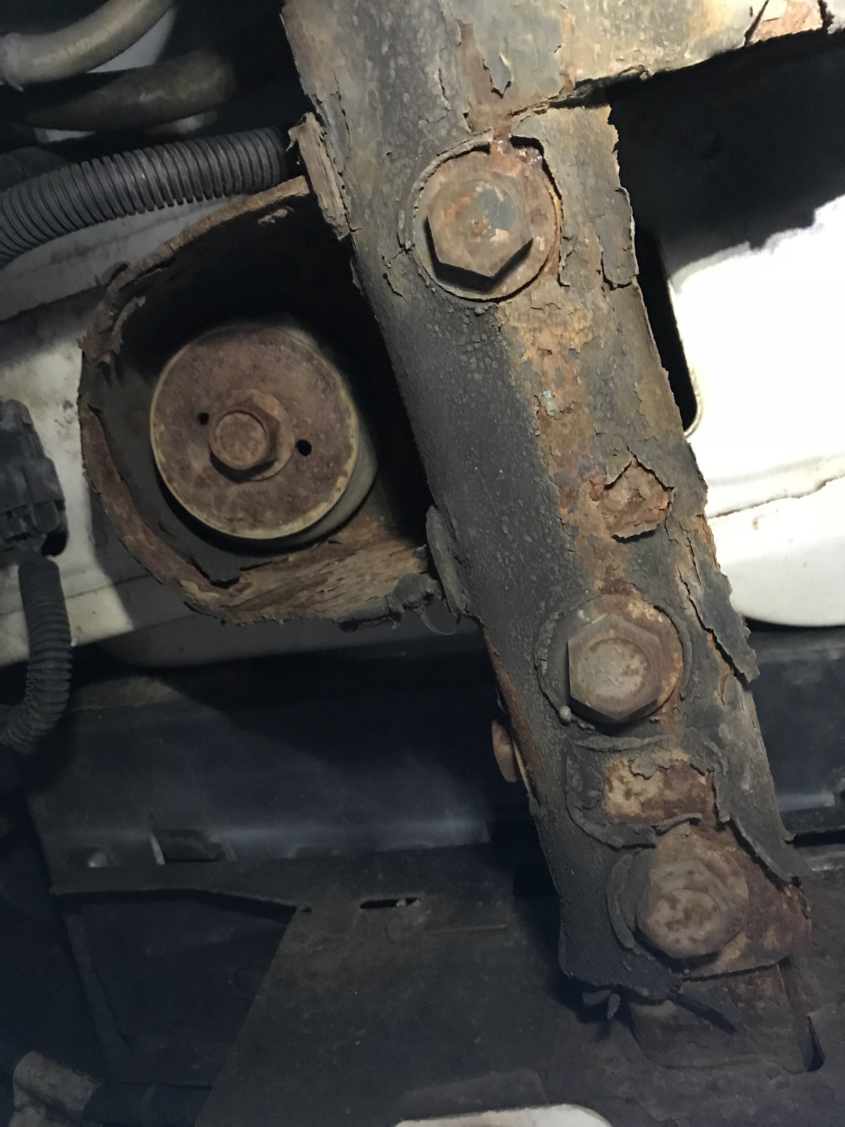

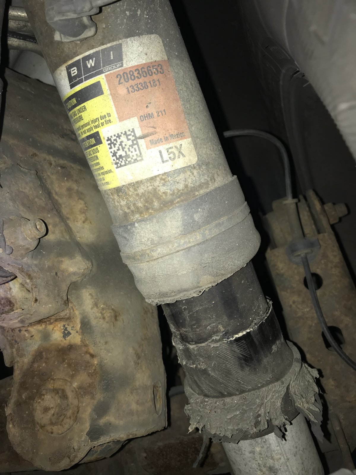

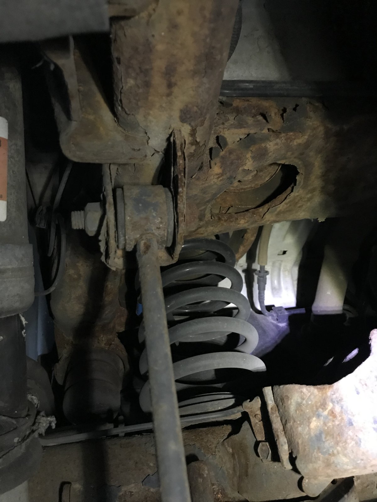

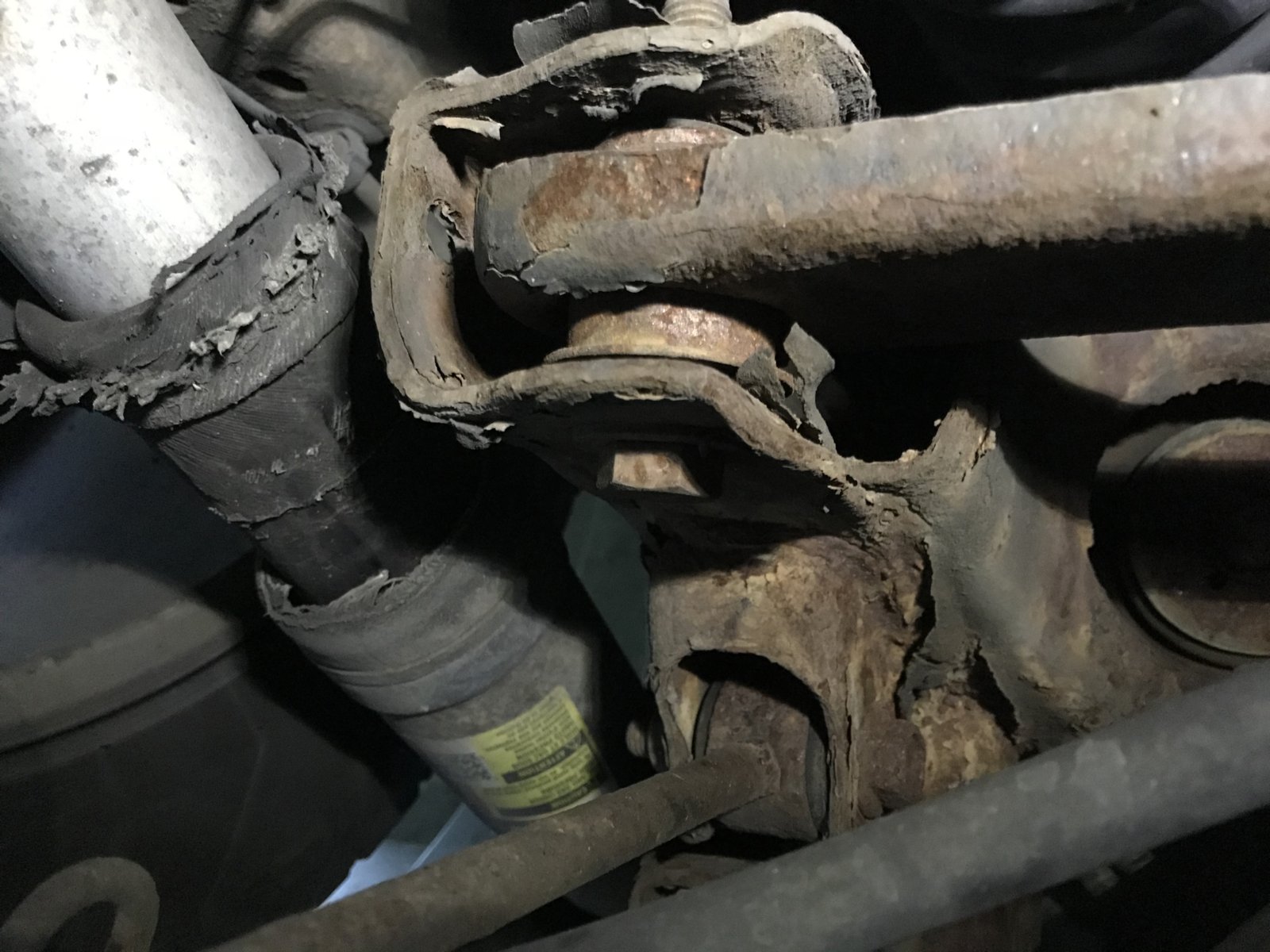

So I just went out and took some pics of under the rear. It looks bad but it seems like its just the coating thats coming off. Still worth keeping or a can of worms? Thoughts?
I know the rear shocks are shot, or at least I do now lol.

No thoughts on the underside rust?
What year again? Thats a truck thats used in a heavy salt area....it’ll scrape off and you can recoat... but it may be worth getting rid of...depends on how much money and time u want to contribute...all the southern guys are gonna flip out over this one.... normal northern truck tho...

Looks like an Ohio car

Yeah it came out of Northern Canada. I have it in the Seattle area now though and I don't have to worry about salt, just being wet 8 months out of a year. So I'm hoping I can get the fender repaired and the rest won't get worse.

To me it doesnt look horrible, And if you try and sell before fixing the fenders at least, any buyer is going to lowball you to deal with it. I would clean up the fenders, white probably wont be bad to blend the paint.

If your buddy can fix it cheap, make sure he does it right. Fixing it twice wouldn't be cheap. Also, I'd scrape any rust from the undercarriage, put some Por15 or similar on there to neutralize the rust, and then spray undercoat. Should be good after that.

I can do all that with body on? I'd love to do a body off frame restore but its not feasible at all.
I do have an air compressor and rotary air tools with wire wheels to be able to really get a lot of the accessible rust off.

Well just got back from having the rust repair quoted. The guy looked at it and said he might have to cut out and reeled a new quarter panel in, repaint the trip-coat so worst about $4k. At that price I would do it no problem. He did notice it was bondo-ed before and repainted so he started going over the whole truck.
He noticed the right rear quarter panel and rear bumper had been repainted as well, and what he described as a "real ******" paint job. He showed me the front right fender now has rusty coming through on a corner, the front bumper has been repainted and the hood doesn't align with the fenders.
He said his shop is slow and really needs the work right now but he couldn't tell me in good faith to spend the money to have it repaired. He said I would honestly be throwing my money away with this vehicle and suggested I sell it as soon as possible and get into another one if I really like it. He offered to inspect any vehicle I might be looking at buying free of charge.

I think that is a pretty honest assessment... when the guy tells you he is slow and could use the work but then tells you it's a waste of time and money... that says a lot to me... at least about the guys integrity if nothing else.
