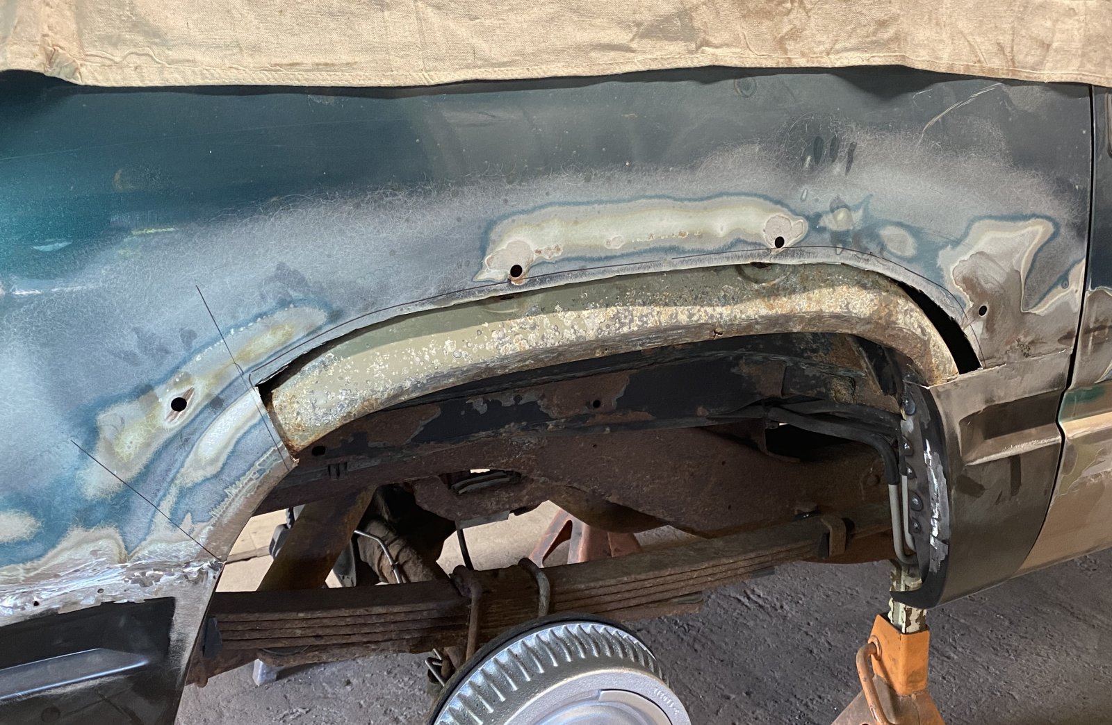

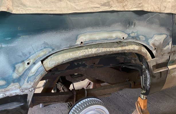

Ounce of prevention is worth ten pounds of cure when rust is involved.
