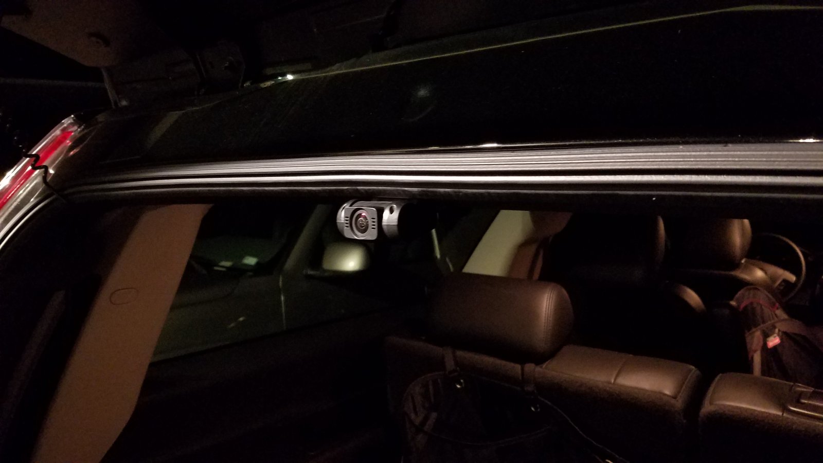

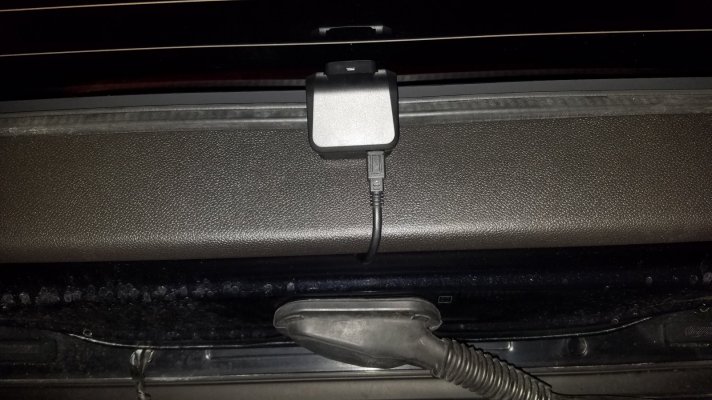

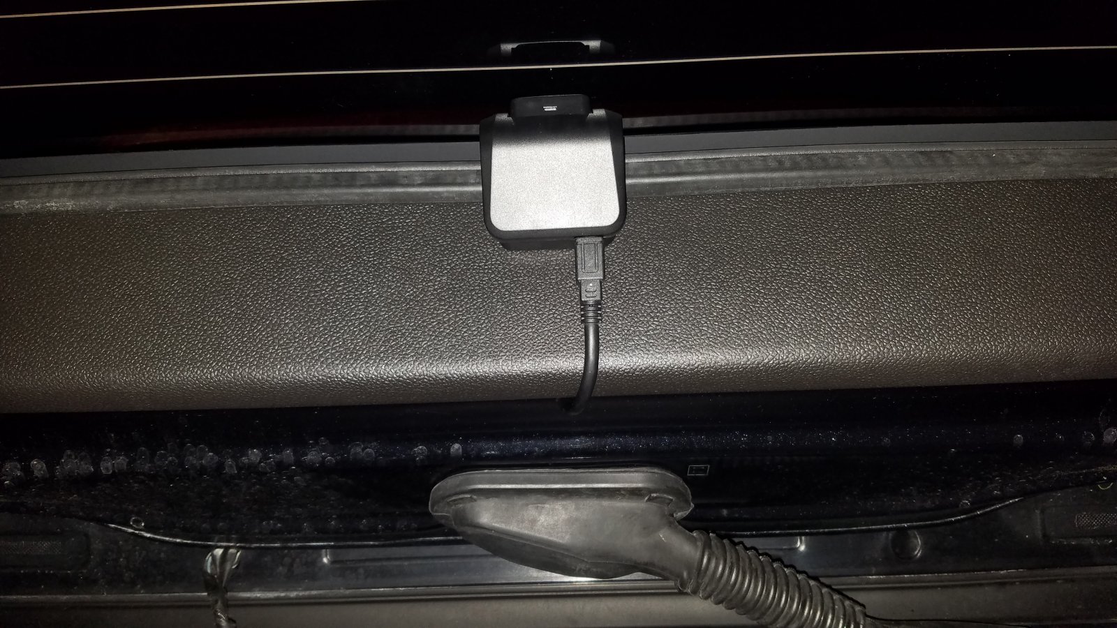

I have a dual camera dashcam that uses a thick usb cable for the rear camera. I ran mine on the passenger side because I've heard that it may interfere with the key fob/tpms receiver which is on drivers side in the rear wheel/hatch area.
I ran it from the front cam which is located behind the rear view mirror, up to the headliner behind the windshield which was easy to tuck into, down the A-pillar (make sure you run it BEHIND the airbag), down under the door sills and under the side panels where the carpet runs under them, into the back cargo area then back up the D-pillar and across the top trim piece.
The way my rear camera is, I would've needed a spacer to hang it down low enough to see out of the rear glass from that trim piece, so I ran the cable through the rubber boot that has the wires going to the hatch. From there I just filed a small half circle in the plastic trim for the cable to come out of and run to the camera which is mounted to the plastic window trim.
This way, there's no extra cord looped hanging down to take up slack when liftgate is opened and doesn't get in the way when the liftgate is up, it goes up with the lifgate. It only hangs down a bit into the opening when the glass is opened, but I hardly ever open it. Been installed like this for a bit over 2 years and never in the way and actually forget that it's there most of the time.
Pick with liftgate open.....
Pic with just hatch glass open...

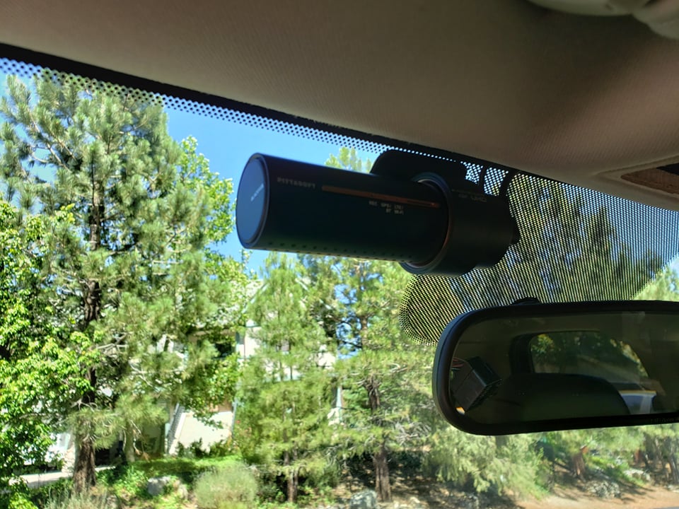

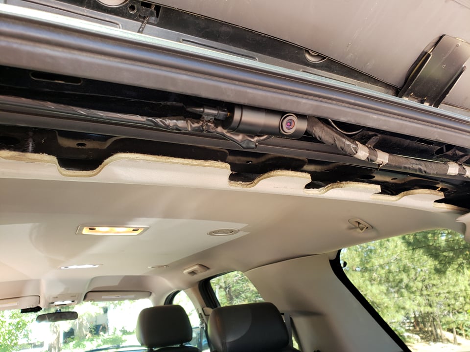

I am running the Blackvue DR900X-2CH, Ran the power wire to a fuse in the side dash fuse block the, Acc I had to run a wire from the engine bay fuse block to inside the dash make sure on the A pillar to run the wire behind the airbag. Ran the rear camera wire through the headliner easy to do when when you remove the dome lights I used romex ground wire with electrical tape. Only Hard part was running through the rubber boot on the deck lid.
