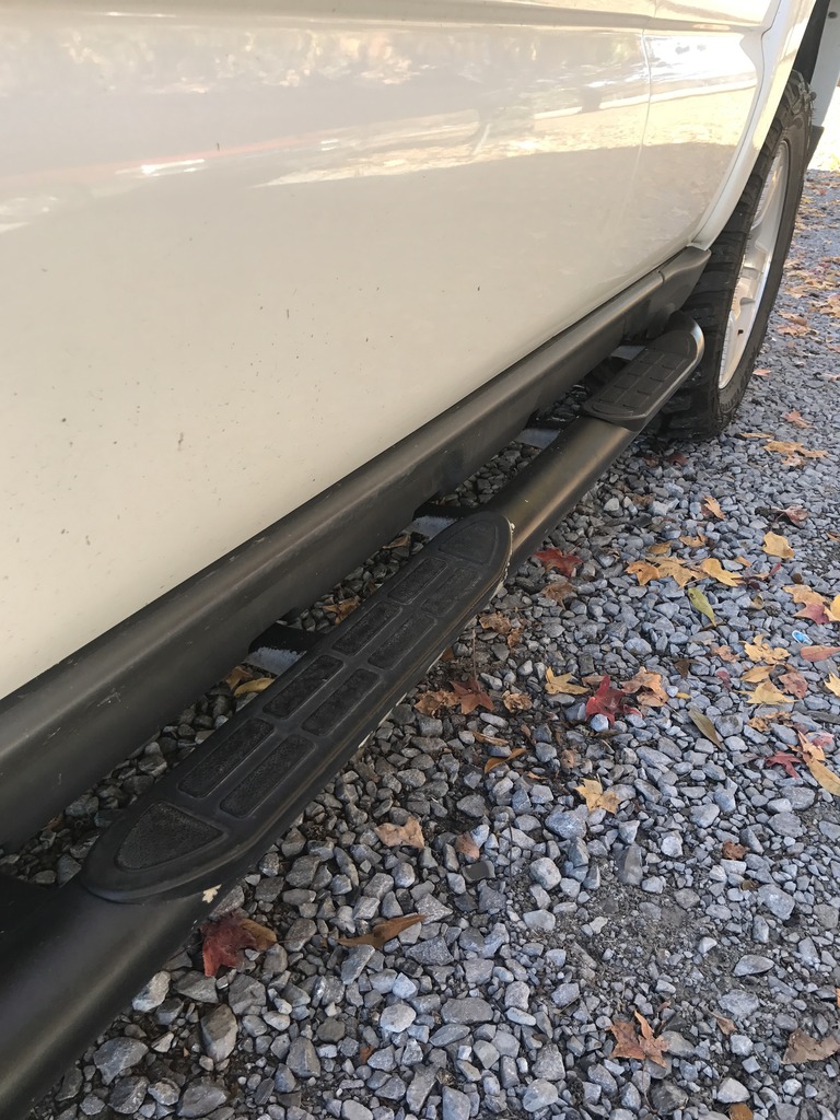

I'm wanting to sand these down and paint them with something like a spray on bedliner or something to stand up to rock chips. How do I get these plastic foot steps off?

I don't have these, but have you tried to just pop them out? Might have tabs underneath holding them to the metal bar, from inside. Try sticking a thin flat bar or flat head screw driver between the plastic and metal and prying it up, little by little. Just be careful not to break the plastic step pads.

Inside Clips and high strength adhesive hold them suckers on, try a heat gun before prying, have gorilla glue handy for reassemble:Caffeine:
