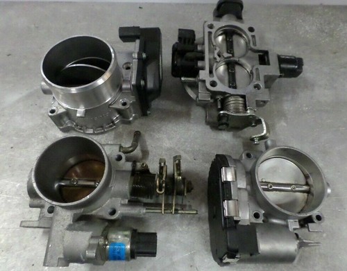

I think i might have figured it out. Was going to redo the grounds since its only 91 out, mild for our summers. Decided to remove the throttle body for a deep clean, saw it was a Dorman. I know when you put in a new throttle body accordimg to my service manual, your supposed to do a relearn. So before anything else i followed the steps, and immediately the slow speed idle fluctuation almost dissappeared, and the rpm drop at braking only drops about 100rpms, and a couple times not at all. That is almost normal. The more i played around, the more the idle and braking acted up and got worse.
Its one of the few things i wouldnt normally replace, especially when tested good. I think the throttle position sensor in the new body might be bad or set incorrectly. I ordered a new ACDelco body and will get it next week. Ill report my findings after install and relearn. Worst case scenario it will be all gm original parts.

Canceled throttlebody order. This morning a friend of mine let me put his 2008 Avalanch tb on. Relearned it, went and drove, does the same thing. Put mune back on, relearned and same thing. I do notice that the idle thing starts when its 100 degrees or higher. Being annoyed, took it to a second dealership, explained it, and they tested it, said they have no idea, and they said they have a handfull of customers Tahoes with the same braking problem. They said mine was the worst yet, same problems, no idea. They did also state a lot of customers have come in and suffer from vapor lock.

This is almost always a throttle body issue. What is the percent at idle? Even after cleaning and old worn out throttle body can still do this.
Anyway, if you don't want a new throttle body, have a tuner raise the idle 50 rpms.

I have a tuner that i can look at load, thought about that but never tested it, will check it out tomorrow. They said too late to cancel throttle body, but i can return it once i get it. Might just keep it, especially i trust an AcDelco unit better than the Doorman. Had issues in the past with Doorman items.
