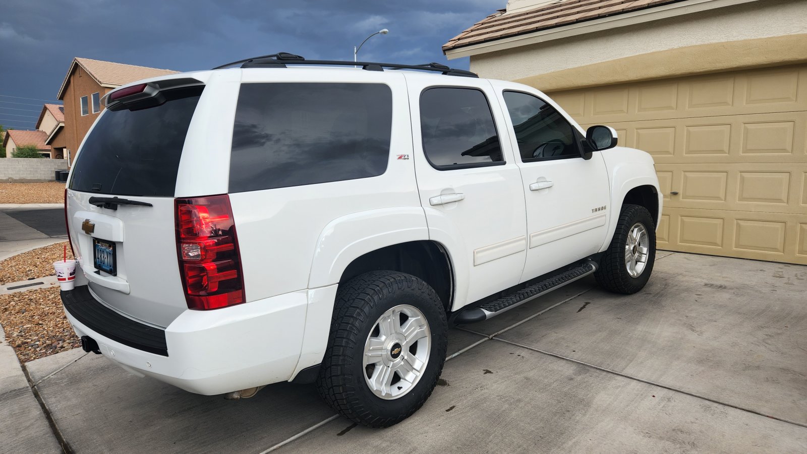

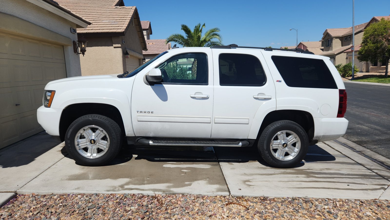

Pics of the truck, please.

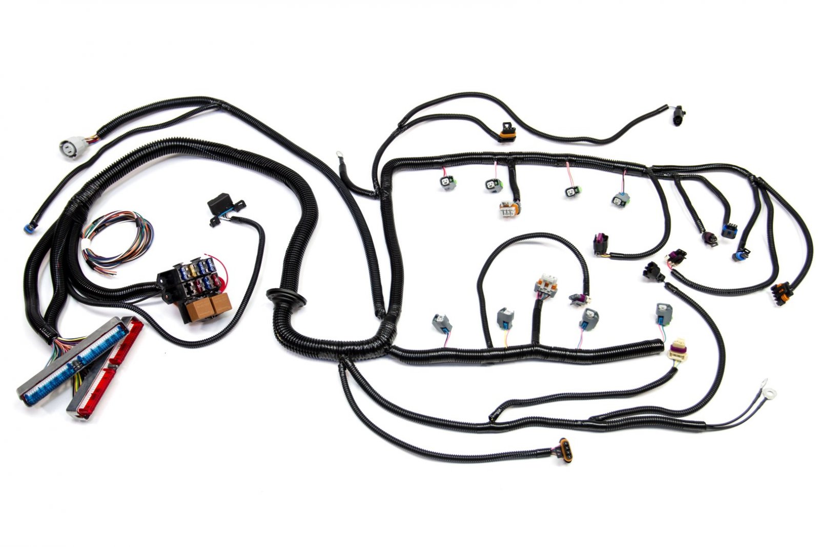

i already tried a new throttle body on mine.. nothing changed
i suspect it could be electrical related.. i.e dirty ground wire to the injectors... but i'm circling in on something to do with the injectors you can see it has 3 ground points... 3 points of failure

i read your post here, it reminded me about some damaged engine wire harness loom (in the rear area of the engine) not wires just the plastic tubing that was brittle and breaking apart
i was able to replace some of it with genuine GM tubing
it's a good reason to suspect ground wire issues
