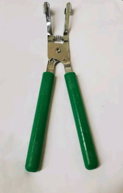

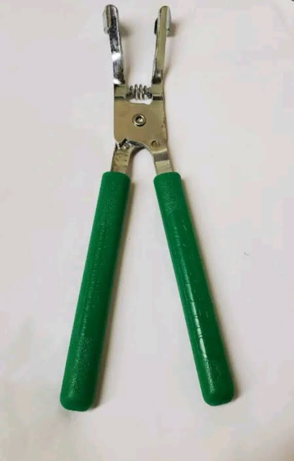

I just replaced my wires with OEM's what a pain in the A$$ to pull the old wires with the heat shields. I haven't really had an opportunity to drive it to see if changing the wires helps any.
