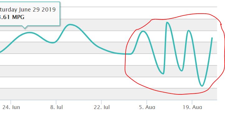

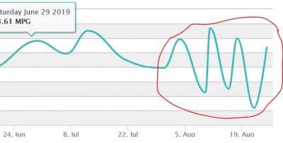

Fuel consumption has increased in the city see my fuelly log

yes the issue does exist
abnormal fuelly log (should be smoother between the city and highway ) as i always try to fill up before doing a highway
Per the june and july fill ups

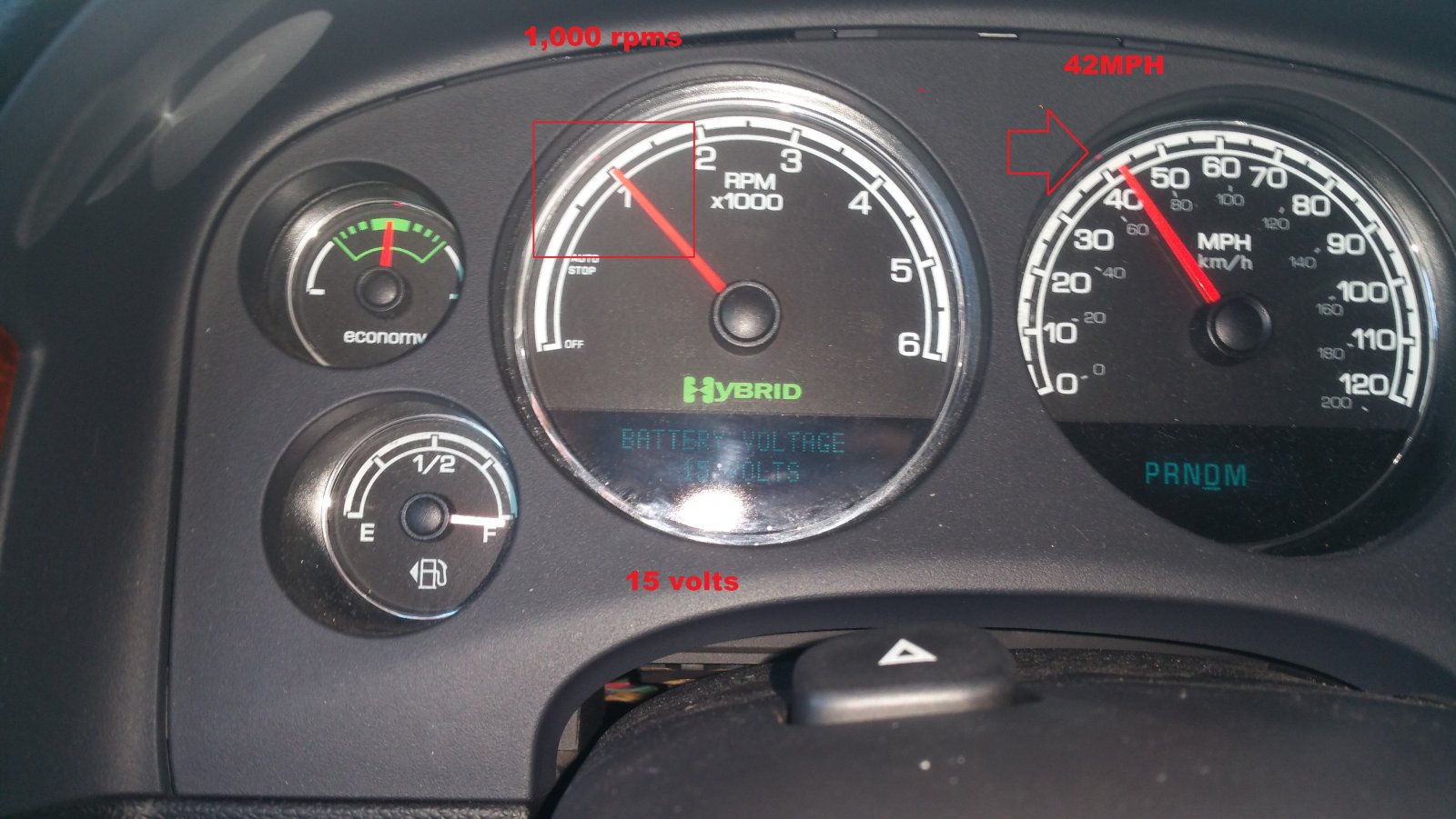

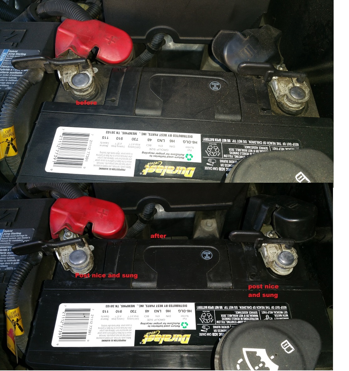

Turned out to be a Poor battery connection..
(BAD design they updated on the 2010 model)
basically the 12Volt battery went flat 11.9volts with the engine off. after just a few seconds and 12.9-13.1volts with the engine running..
There was some petroleum jelly :manos: on the terminals
an Electrical insulator :slap:
The idle misfire :Grenade:is gone...
Auto Stop lag is gone Tested with both A/C units on..
it's reporting 12.9volts with a mutimeter now " engine off"
14.8-14.9 voltsDC with the engine running any RPM(High voltage DC to DC 185amp converter)
