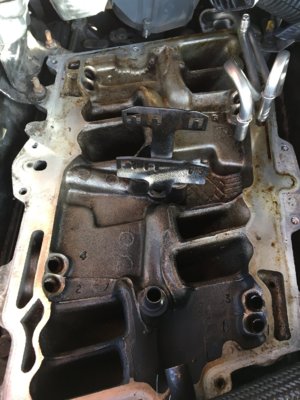

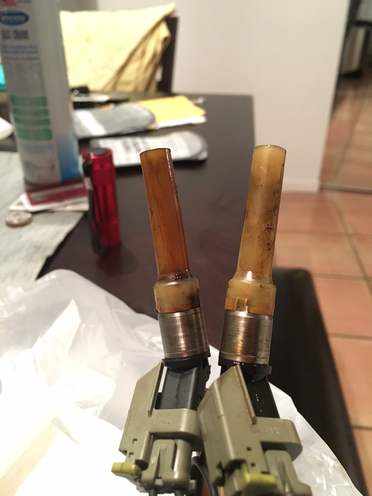

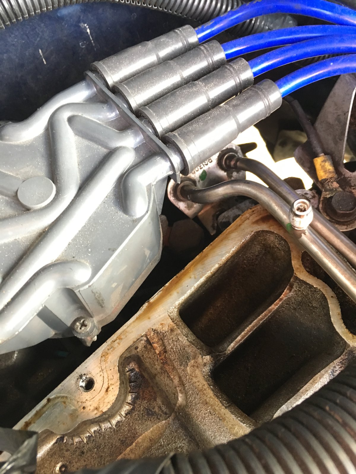

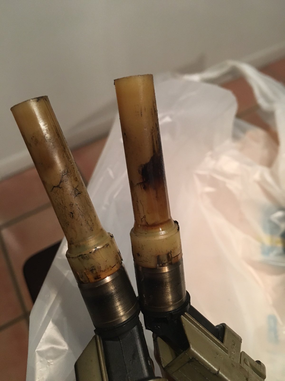

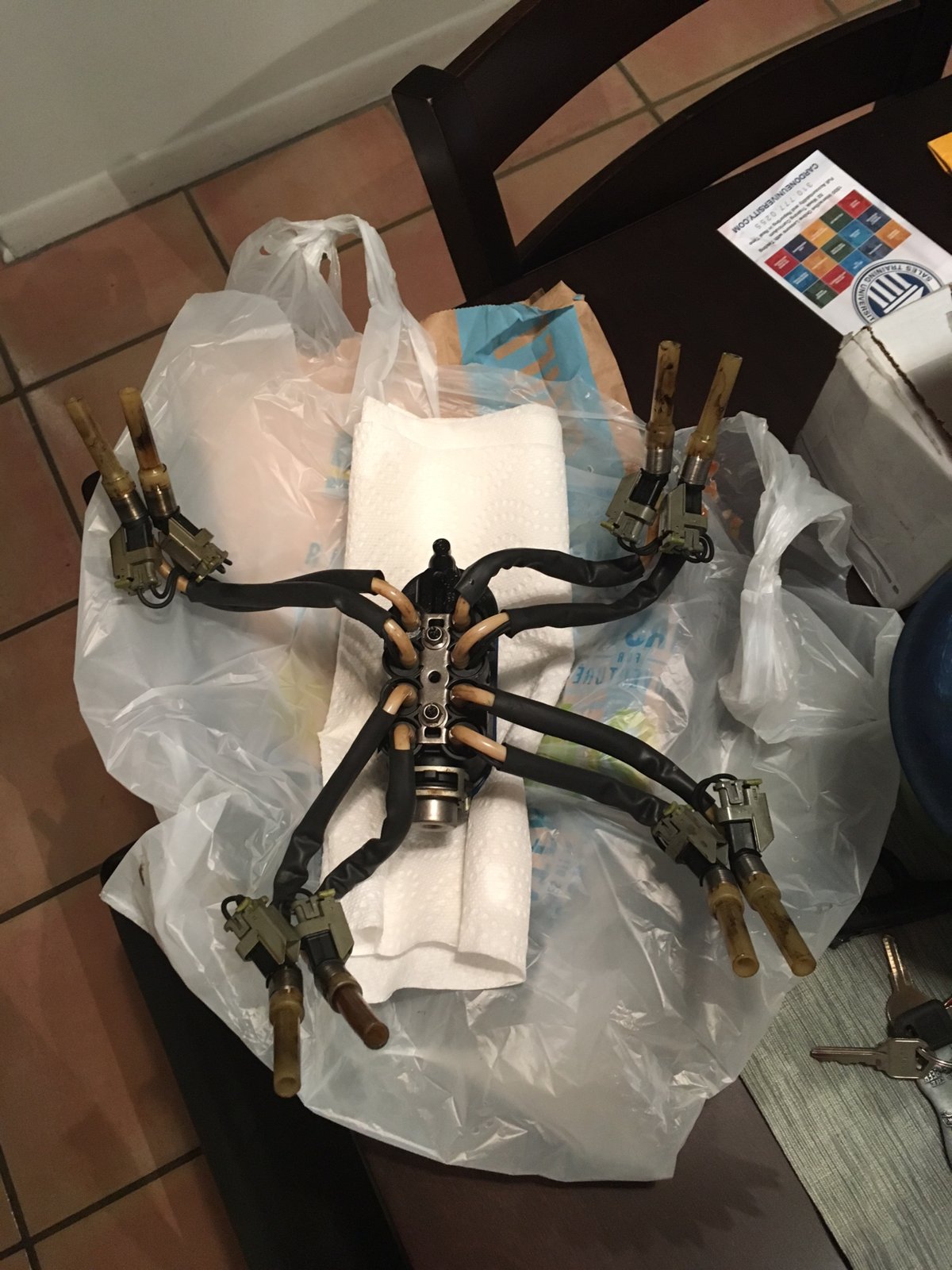

Today I decided to start over from square 1 with my misfire and pull the MPFI unit out and put a new one in, thinking that I may have screwed up the install somehow. When I pulled it out, the injector housings were very oily, and Cylinder #4 was especially brown which you can see in the pics (picture #3; this is also the cylinder that misfires the most). The Data Logging pic shows the Misfire History; however, I have seen Cylinders 6 and 7 misfire under Current Misfires, but they must not be enough to register the history. My question is would the oily injectors be the cause of the misfires, and if so, where is all this oil coming from? Bad EGR? Keep in mind, this MPFI unit has under 1000 miles on it, and I have not put the new one in yet.

I'll throw this out there, maybe it will flip a switch: worse misfires are coming from front half of motor, with the exception of cylinder #8. Also threw a P0141 code O2 Sensor Bank 1 Sensor 2 code the other day, but has never come back on since.

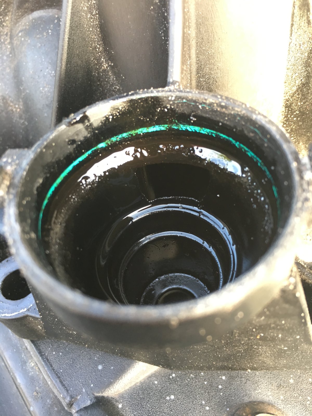

I do not have a catch can installed. Can I buy one or do I have to make one? Does it go under the valve that the pcv connects to on the plenum? I blew air through both that connection and the pcv and there are no restrictions.

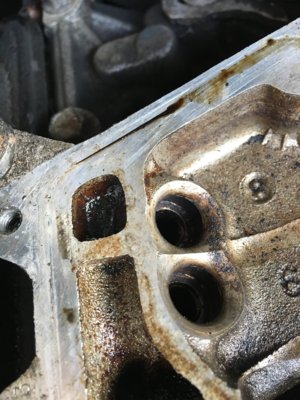

However, these two are coated with oil! So it's sucking too much oil through the PCV into the plenum? Next thing is, what causes that?

Wow, I do not know what would cause all that but you would really benefit from a catch can setup. You can buy them from Ebay although the cheap ones on there will not have a baffle system, or https://catchcans.com/. Install in line between your PCV valve and the intake. The can will catch all that oil getting by your PCV valve. Some people have used the inline oil separators from home depot. Search the forum for catch cans and check this thread for ideas. http://www.tahoeyukonforum.com/threads/get-a-catch-can-before-any-mods.49716/
