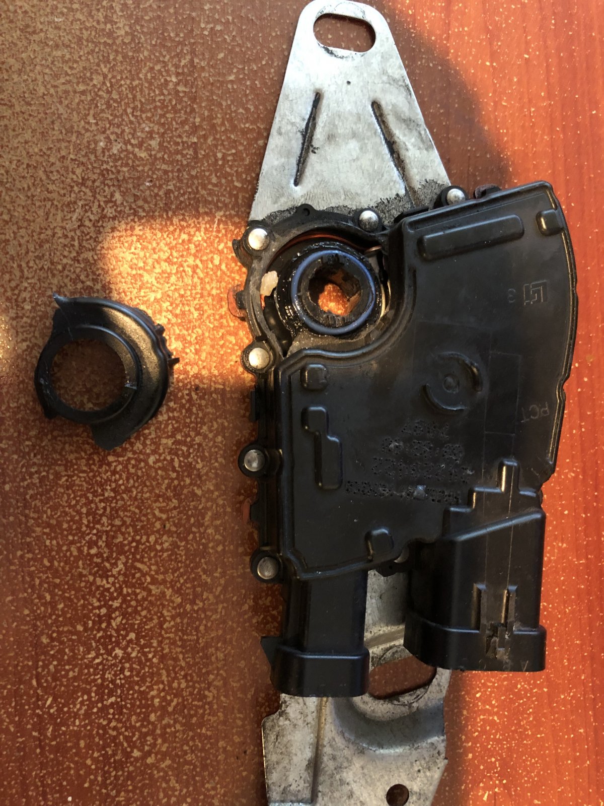

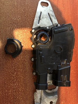

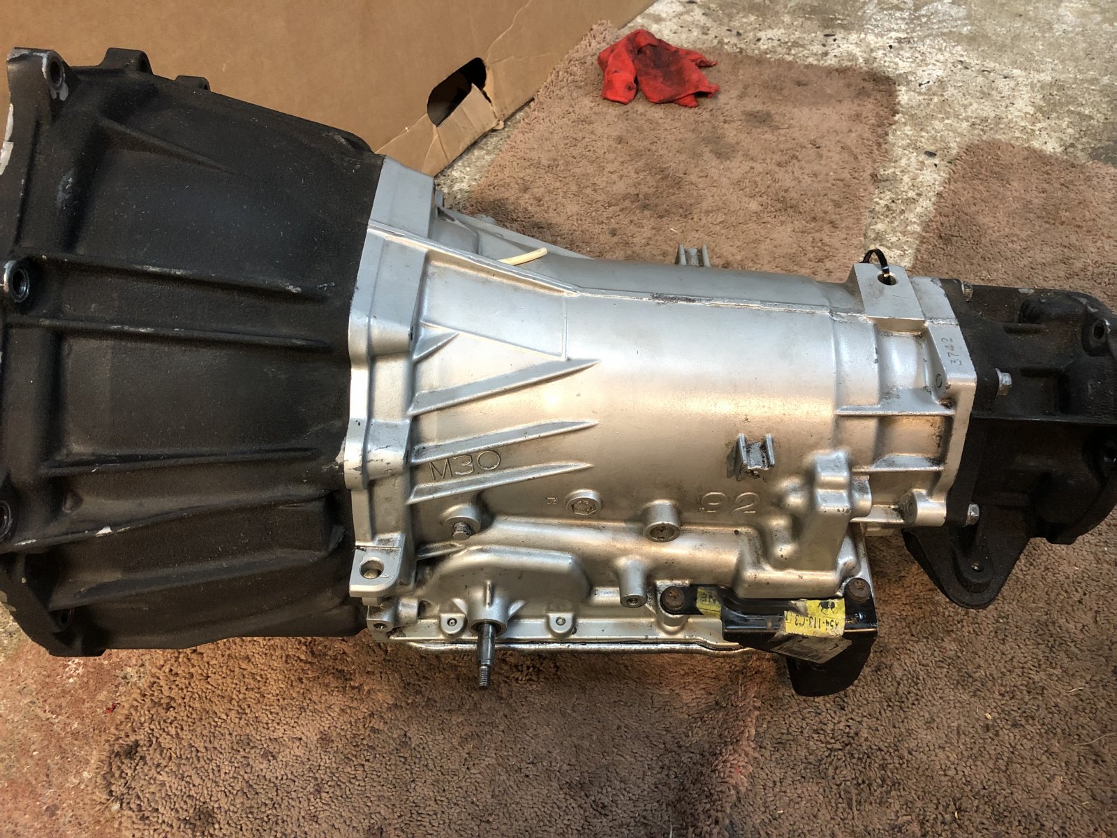

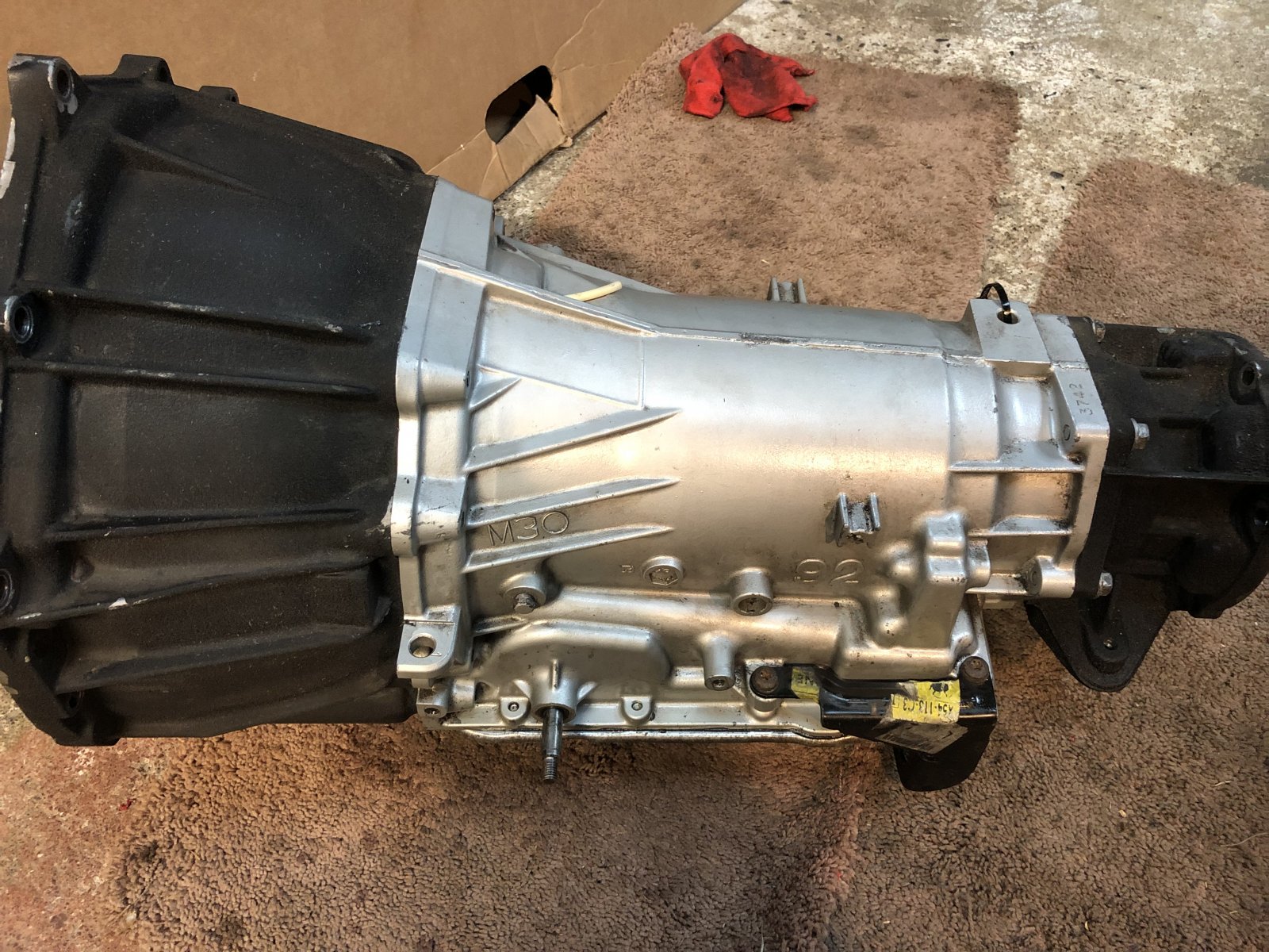

I decided to install the parts onto the trans today in preparation for final assembly into the truck. I’m glad I decided to buy some used torx plus bellhousing to trans bolts off eBay. Those things really like to strip. Got that on, then the case extension at the rear and the shift cable bracket. Things were going well until the neutral safety switch. Both times I’ve removed this I’ve broken it putting it back on. Did it again today. $39.43 Amazon Prime. Stupid switch.

Does the plastic just get brittle? Genuine GM?

AC Delco switch. If you’ve ever pulled one off you’d know they’re a *****. Not sure why, the plastic just grabs at the shaft and it’s a real tight fit. I tried wiggling this one on after being sure it was lined up but no matter how I tried it would only go halfway so I tried tapping it on with a hammer and it broke. I’ll try grease next time I guess.

That's funny because I couldn't unplug mine lol. It slid of off fine. I just left it and plugged it up to the new trans. At least it won't disconnect.

Yeah that’s the other thing with them. The factory puts some kind of glue inside the connector that makes it a ***** to pull apart. I had to replace the switch another time when my front driveshaft came loose after breaking a u-joint and destroyed it. I don’t remember what method I used to unplug it. So now that I remember that time, this will be my third replacement switch.

maybe put a socket over that neutral switch and tap it on that way?, they are flimsy crap metal and plastic
