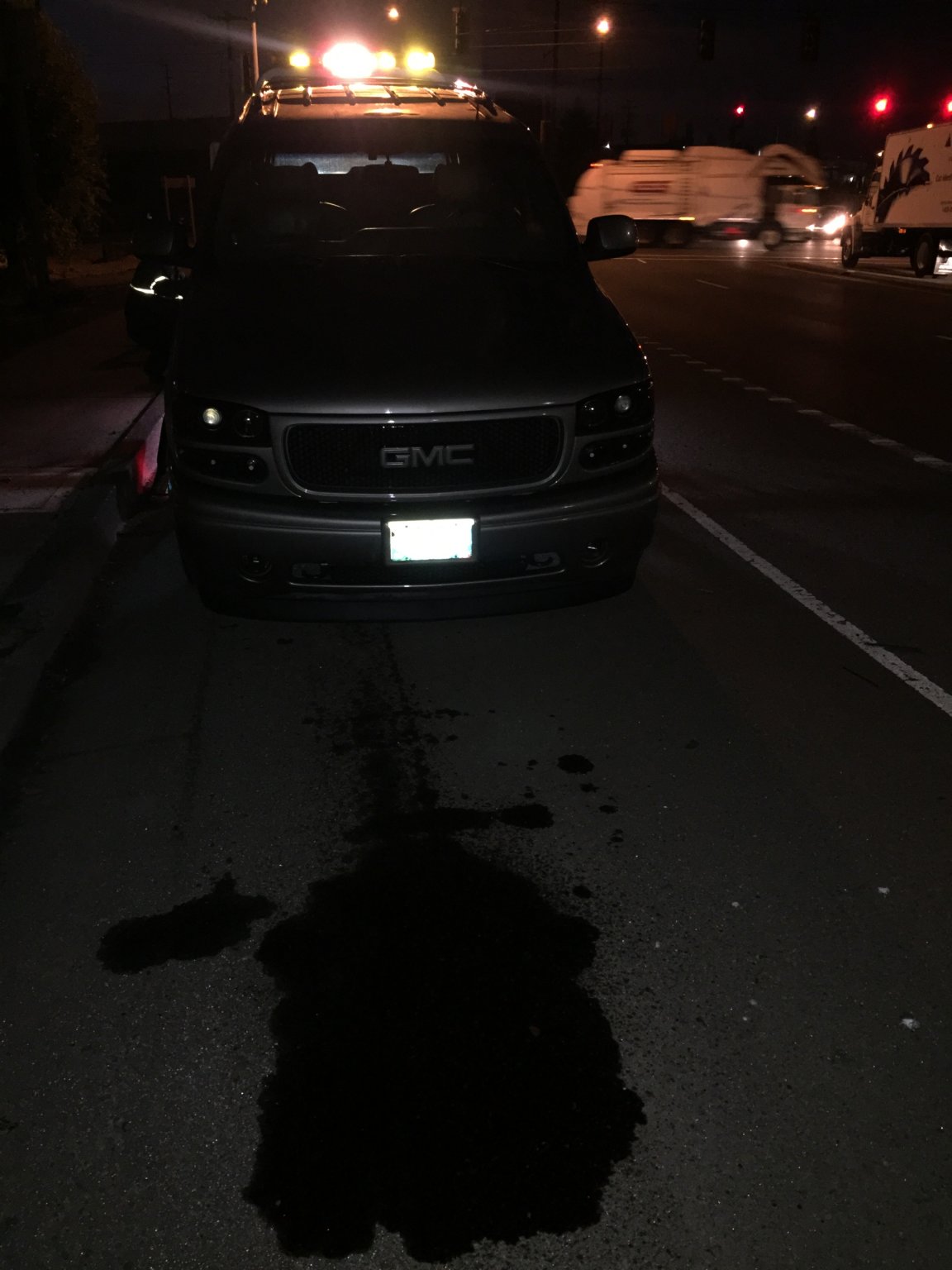

On my way to work this AM, a tranny line came off at the quick disconnect where it goes into the tranny. Luckily some dude behind me let me know (he thought my radiator blew) so I pulled over before I damaged the transmission. I replaced the line ( not fun) and now Im testing it out. I had to add almost 5 quarts of fluid. It was everywhere under and on my truck. I hope all is good now.

Man super lucky and that it wasn't on your road trip the other day. Phew!!

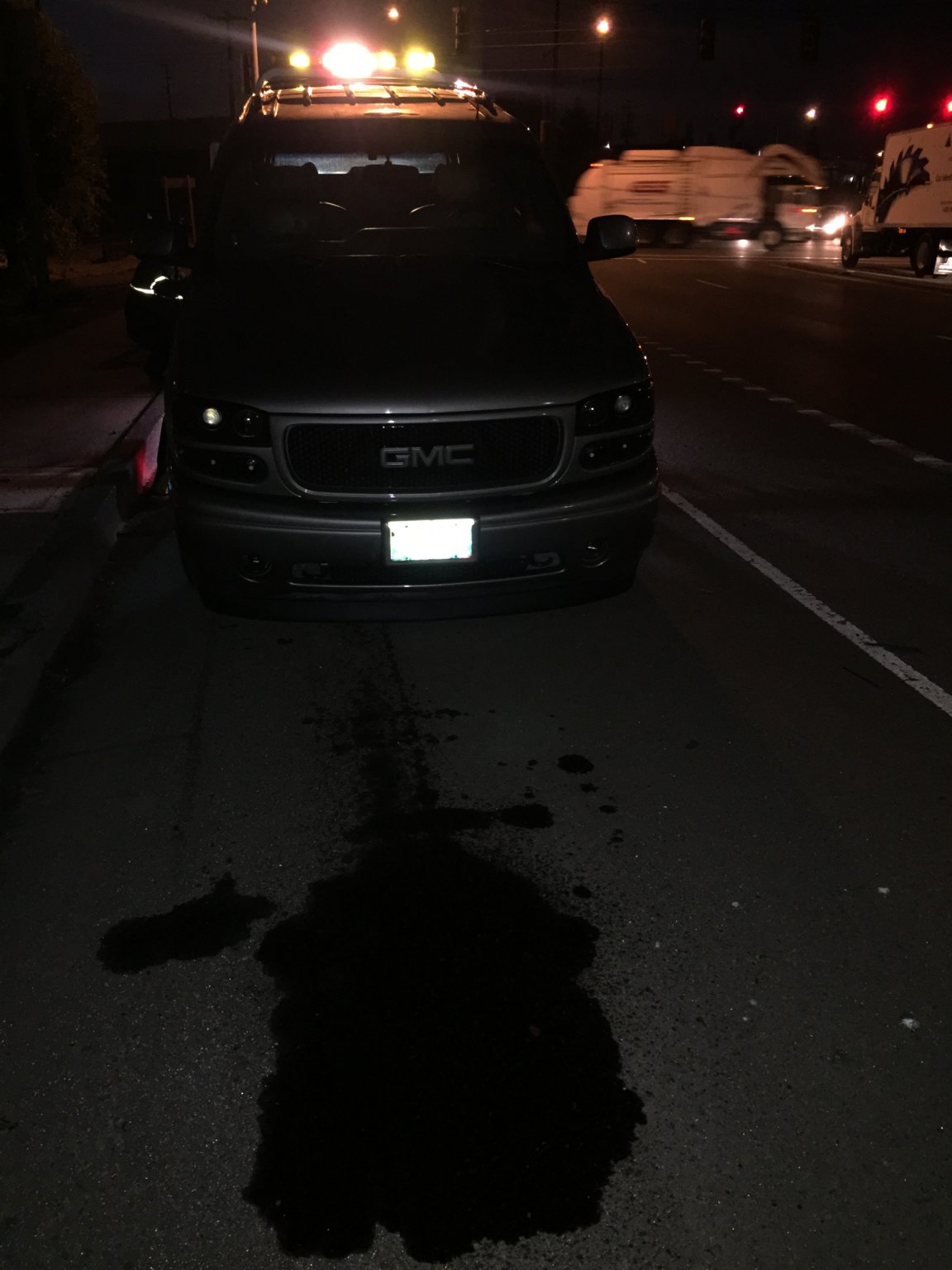

Free under coating. X2 on you weekend drive like Fosscore said. That would not be fun.

Yeah no kidding about the road trip. There was a lot of that drive that had no cell service and nobody for miles. Small towns few and far between with MAYBE a gas station if you're lucky. That's if you can find a way to get a tow. Lucky lucky. I still don't know why it came off; the tube was a bit bent where it went into the tranny though. I'm thinking the shop that installed my Corvette servo might have pried against it since it's right next to the servo.

Also lucky it was just the line and not a gasket , or hole in the tranny.
Nice easy fix and glad all is good now ;)
I know. First I thought it was the radiator then I saw all the tranny fluid and saw it was coming from near the trans itself not from up front. I really started worrying then. Then soon as I got it home and on jack stands and saw it was a line I breathed a huge sigh.
