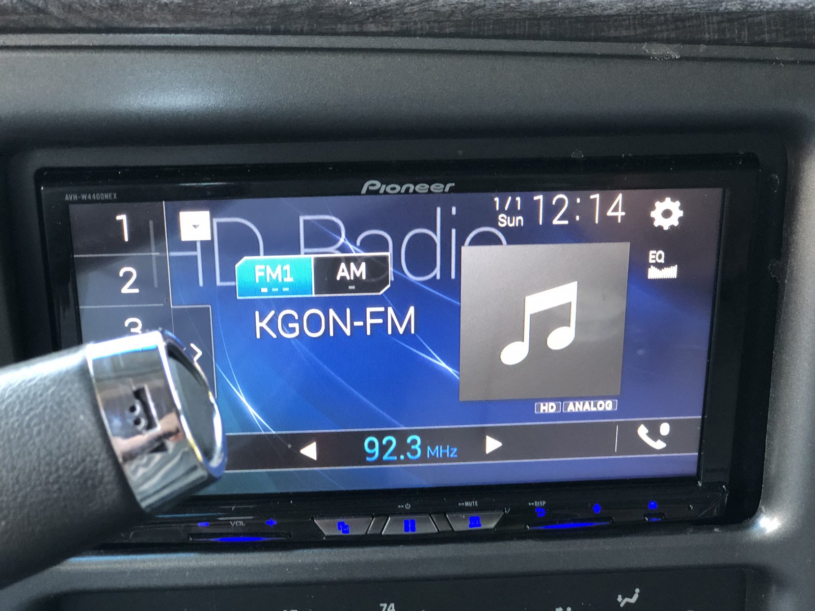

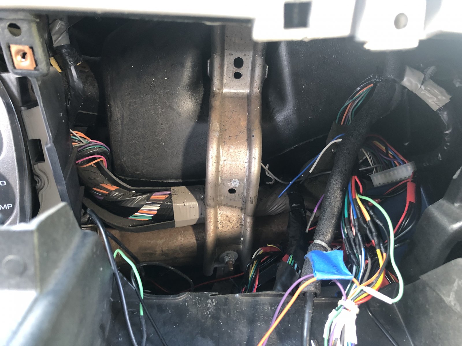

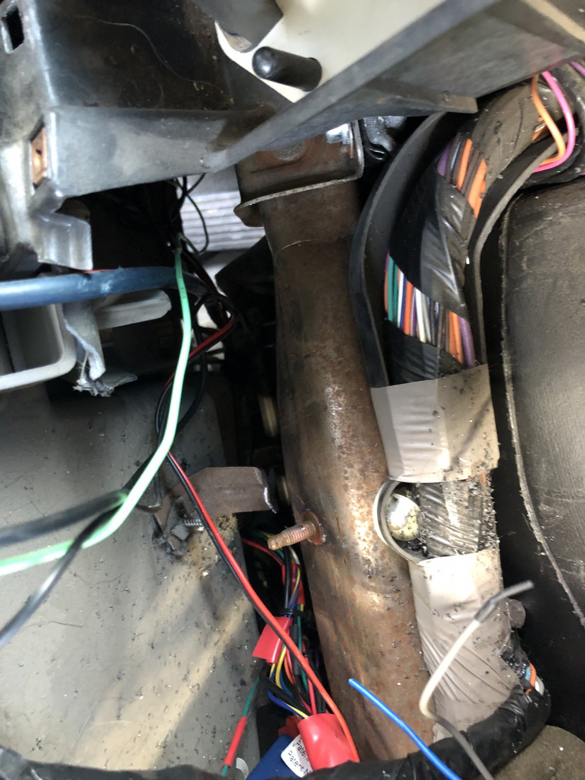

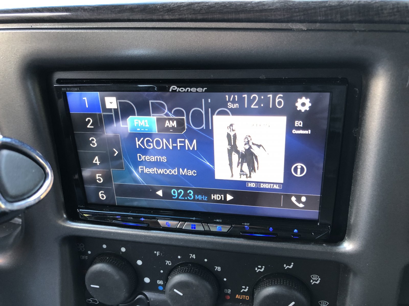

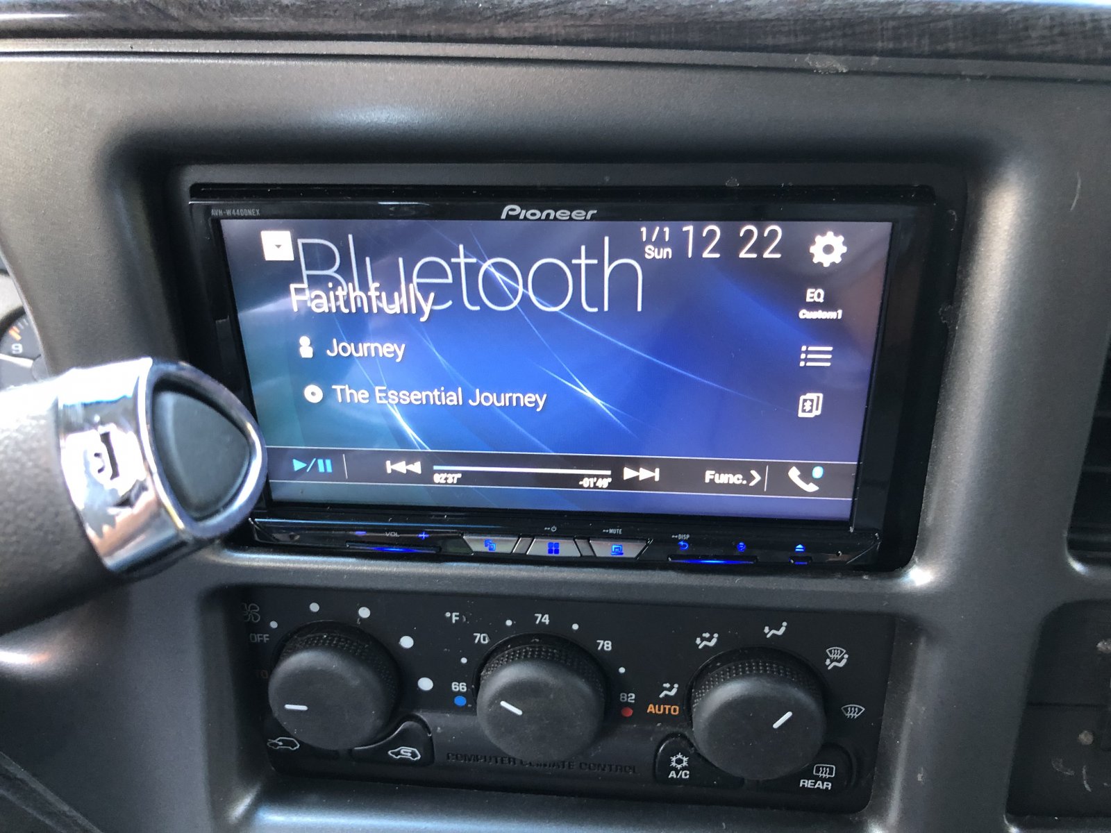

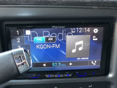

Bose hybrid as I like to say. Lux amp running JVC 2 ohm door speakers, tweeters and D pillar speakers. Sub output from HU running Soundstream 250 w mono amp to a 10”’ JL sub in an MTX Thunderform enclosure behind the rear panel. It has great imaging due to the Lux amp and great bass. And this HU just made it sound even better. All done. It was pretty easy, just cut all the wires off the Sony plug and color matched them to the Pioneer plug, plugged in the cam, usb wire, remote plug for the SWC adapter, sub and had to install the included mic since the plug was smaller. I ended up having to cut the brace behind the radio cage too, this units was deeper. Then had a bit of a time setting up the wireless CarPlay but it’s working now. I’ll add a pic of The Beast for the splash screen. It has an HDMI input too so I’m gonna add an outlet as well as 2 usb outlets

Oh yeah I forgot to mention, the wireless CarPlay is instantaneous as in it’s paired with my phone and playing Pandora as fast as it can play an HD FM station. As soon as the system boots, it’s CarPlay.
same radio I have. I like it. The CarPlay connects via wifi
Good to know! Now I know what I'm REALLY missing.

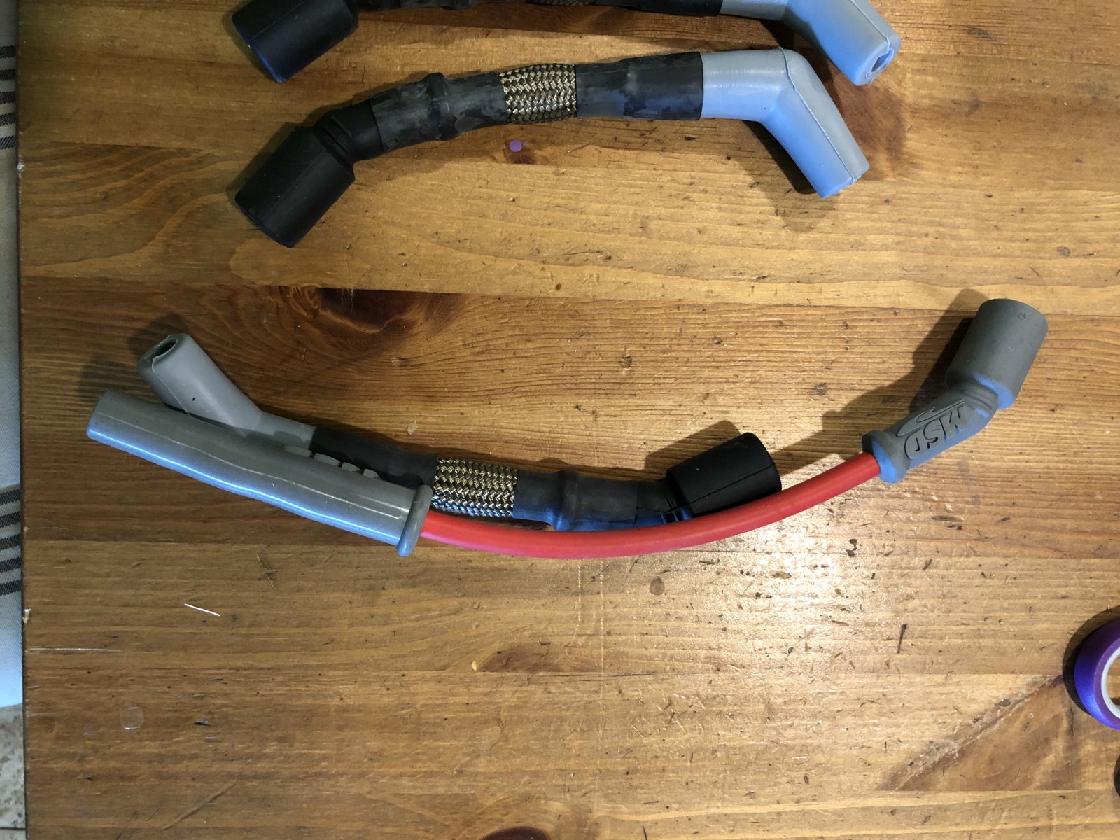

I got the plug wires today. They're super beefy and look to be the perfect length. They seem to be made by B&B Mfg/ OML Racing. I tried to look at their catalog but it seems they want you to have an account. I'll report back after I install them.

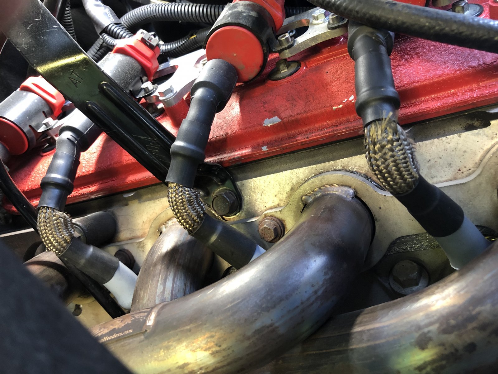

EBay. I can’t get the link to load, but I just searched for LS engine plug wires. $118. I just installed the passenger side, seem to be just what I was looking for with my headers. You can angle them away from the header pipes since they have the angled boots and they’re the perfect length. No more touching due to being too long.

Item 351925993115. Inside edge? They don't touch anything on mine. I have headers so I'm unsure if they would fit with the heat shields since I don't use those.

I know there are 2 different styles of coils. The 19005218, and I think 12558693. The plug wire sets are made for the specific coil. I have the 19005218. I think the wires are (supposed to be) shorter, but seems they’re still going to be too long with headers. There may be other differences as well, I’m not sure.

Yeah there’s long wires and longer wires. I think the long wires would fit both. As far as the stick heat shields, they won’t fit these wires because of the angle at the plug boot.

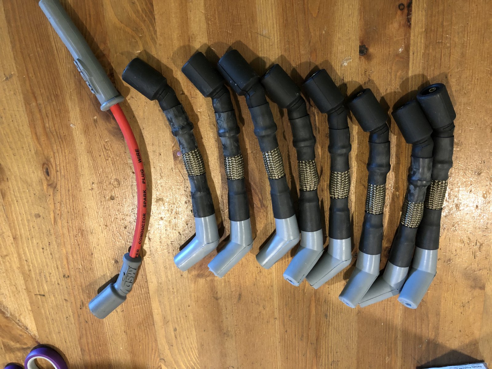

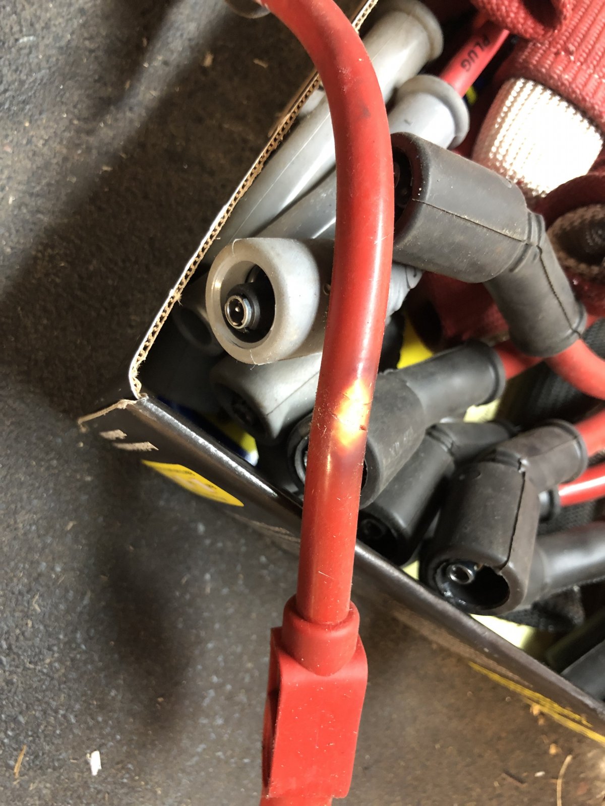

52,954

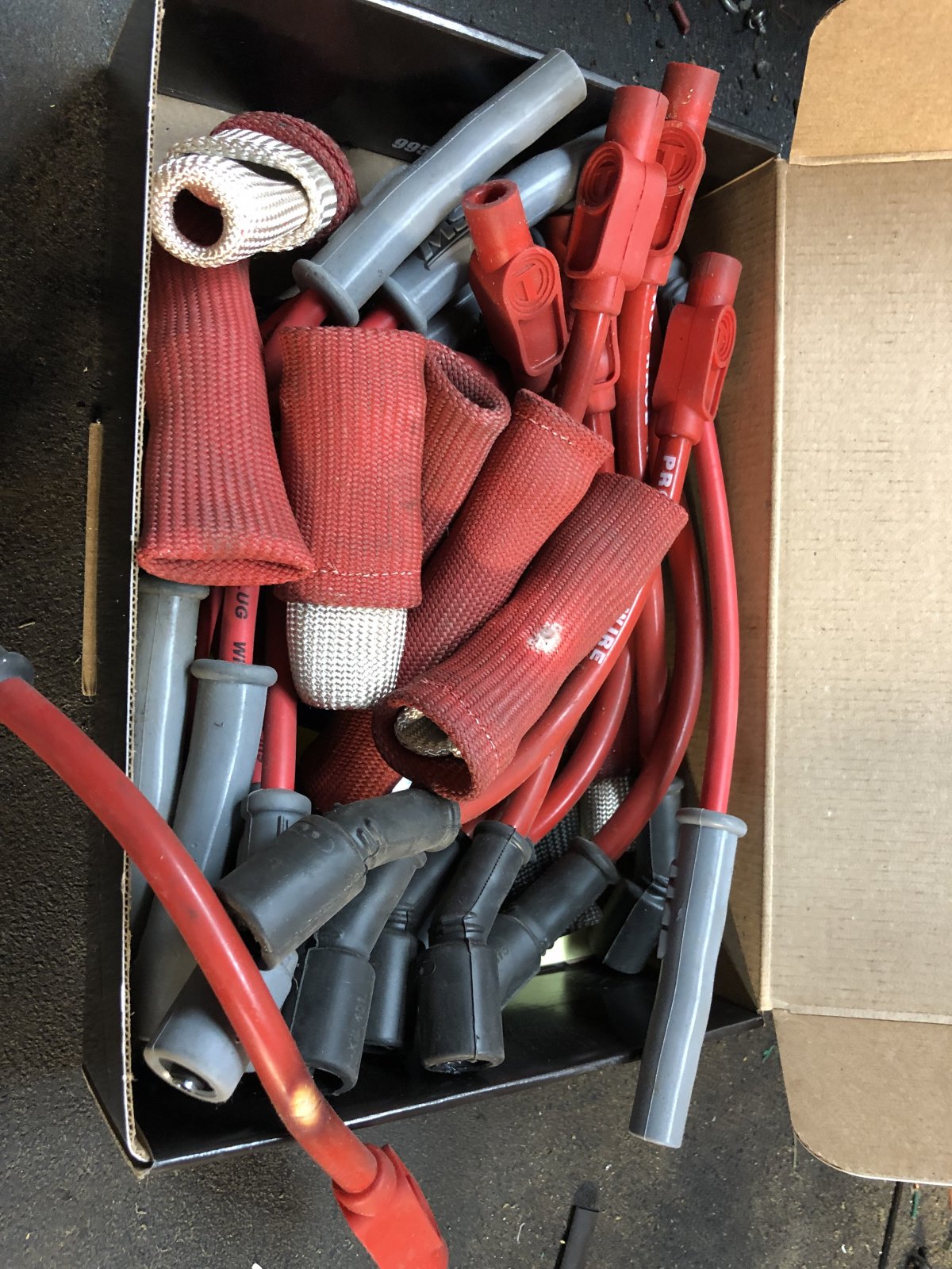

I pulled the passenger wheel and liner tonight so I could get to #8. I see that some of the heat shield pulled out of the heat shrink when I bent and twisted one of the wires into the best position but I really don't care- I was able to adjust them by twisting them in a circular motion on both the plug and coil until they were centered from the header pipe on each side. here's a pic of the burned Taylor wire as well as my $250 box of useless wires. Actually, I have a complete set of MSD wires if anybody with stock setup with heat shields is interested, no burns and barely used. I just pulled them in order to install the Taylors. They're not the best for headers but should be great for a stock exhaust. And they're red for an extra +10 HP lol.

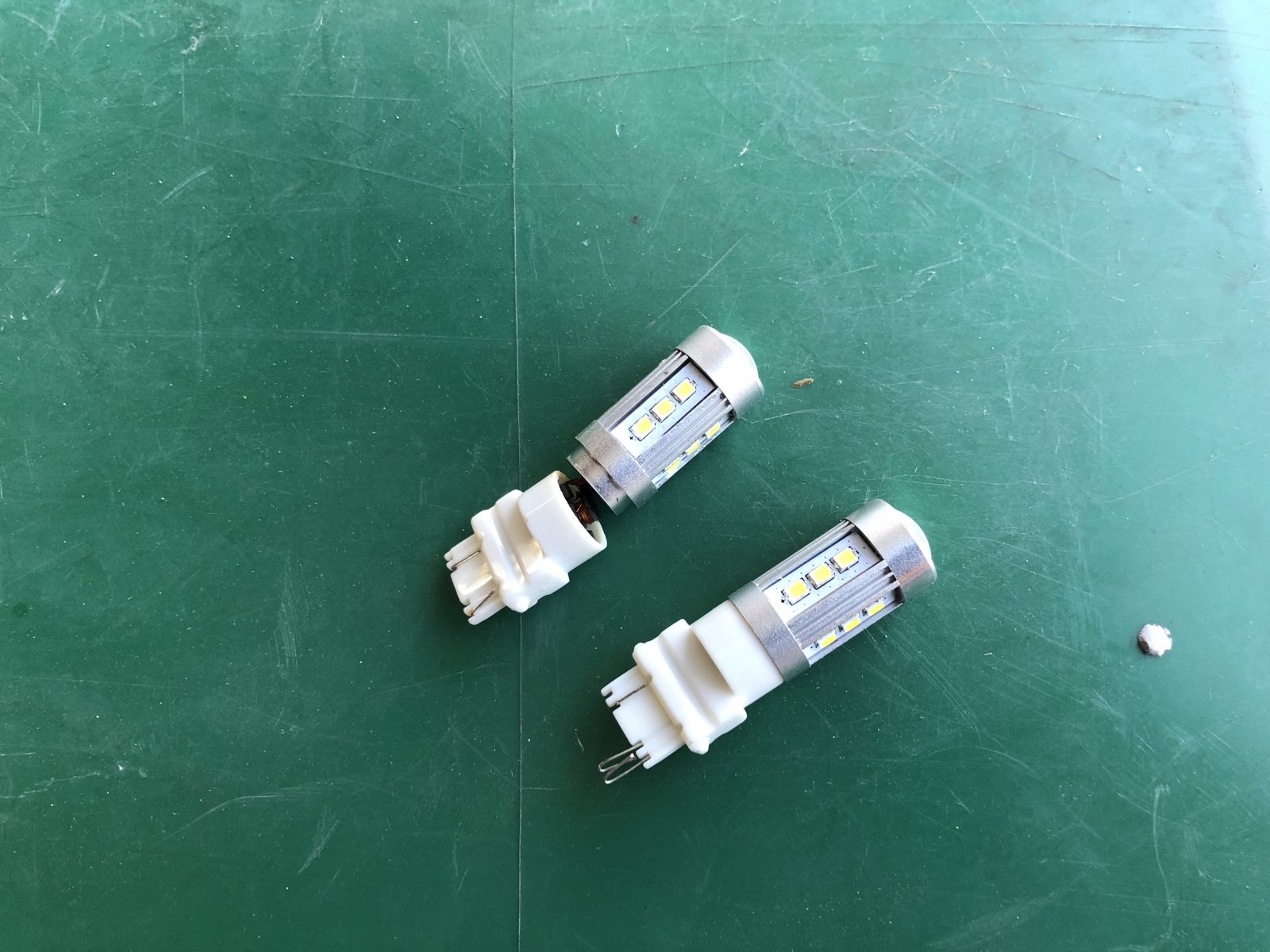

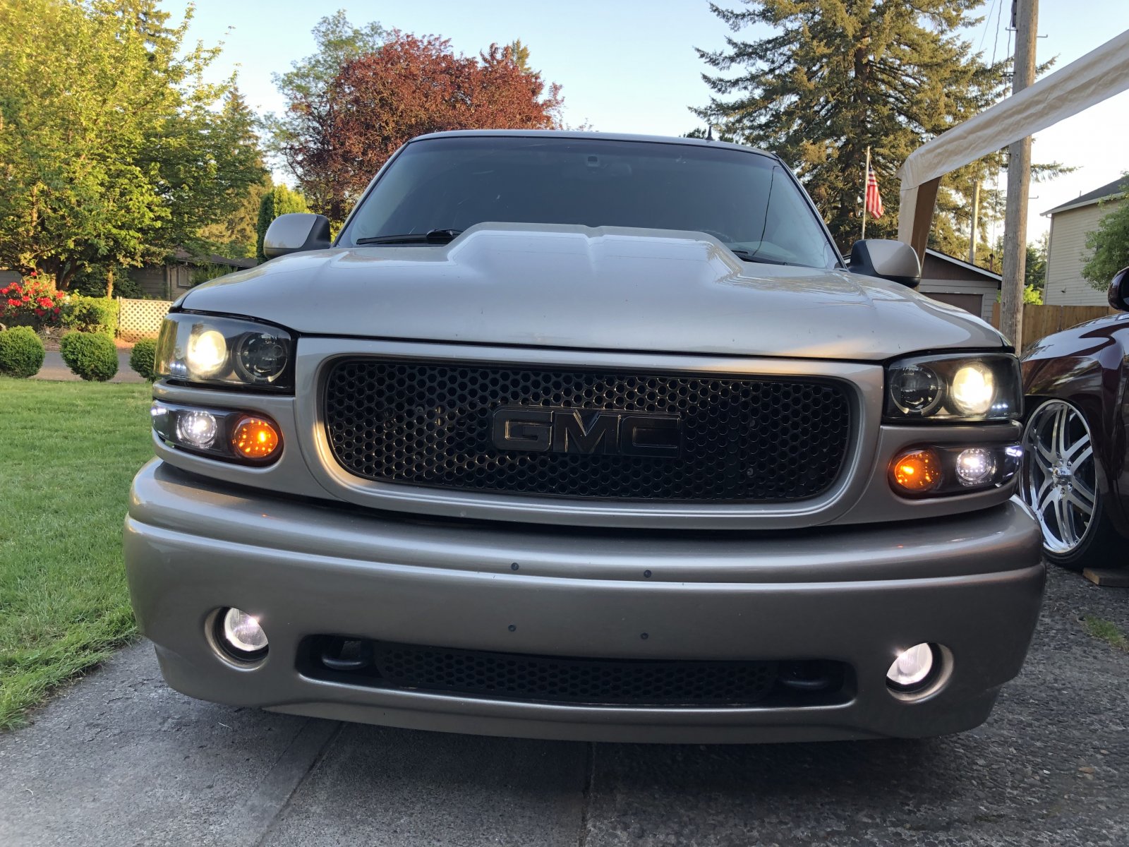

I also noticed one of my DRL's took a shit on me so I was going to replace it with an extra I had until I noticed the other one was flickering too. I'm tired of spending money on DRL's that don't last. I had a set of Acme projector amber switchbacks that I bought for The Machine but didn't work out so I swapped them in. I got them from TRS so maybe they'll last. And it's a nice little change.
