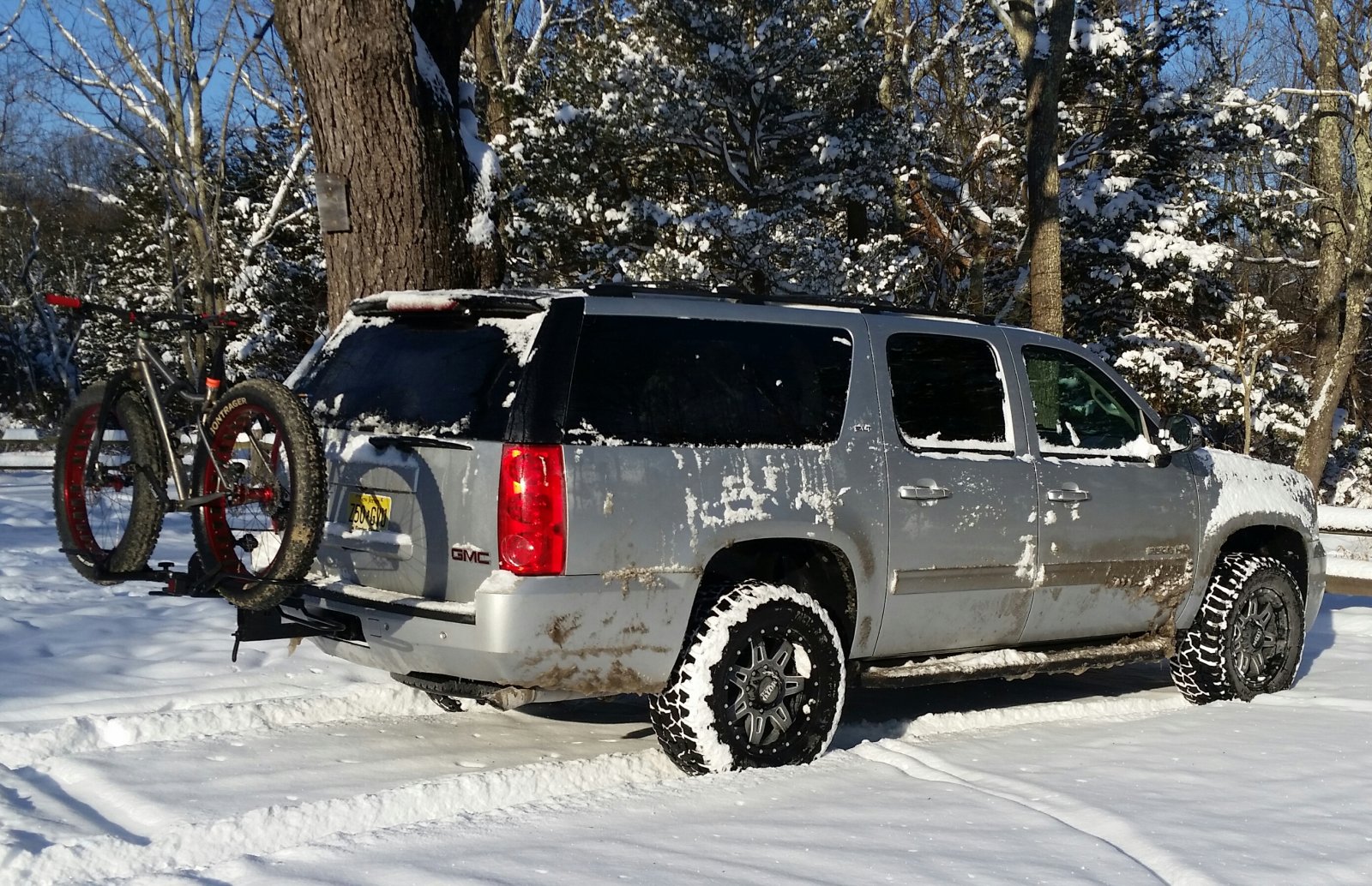

With careful trimming I fit 305/60/18 stock, wheels were 9" wide +18mm offset.

Got any pics ?
For some reason I'm missing most pics on my phone. There are a bunch in my build thread, of the trimming as well.

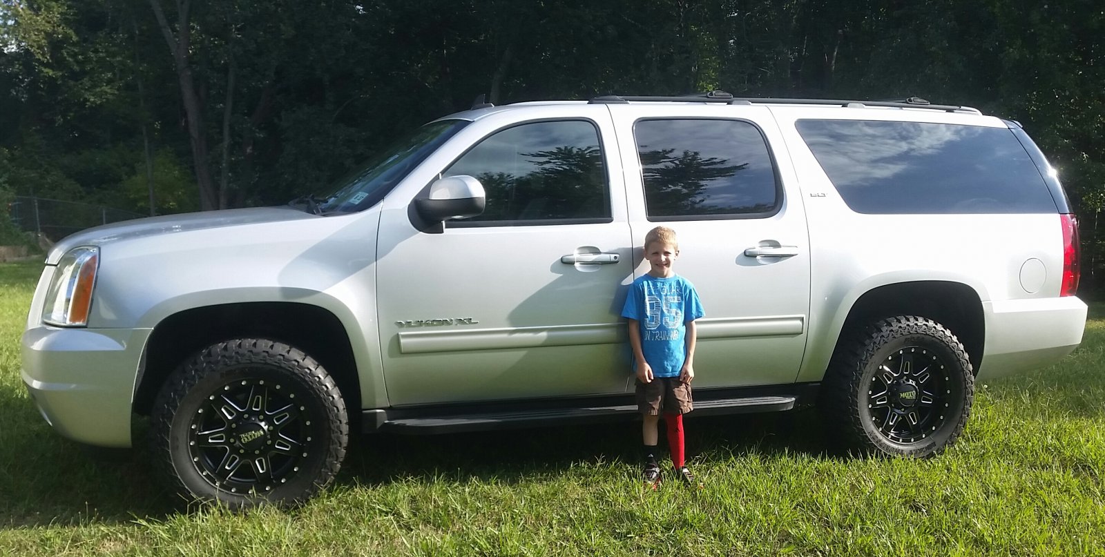

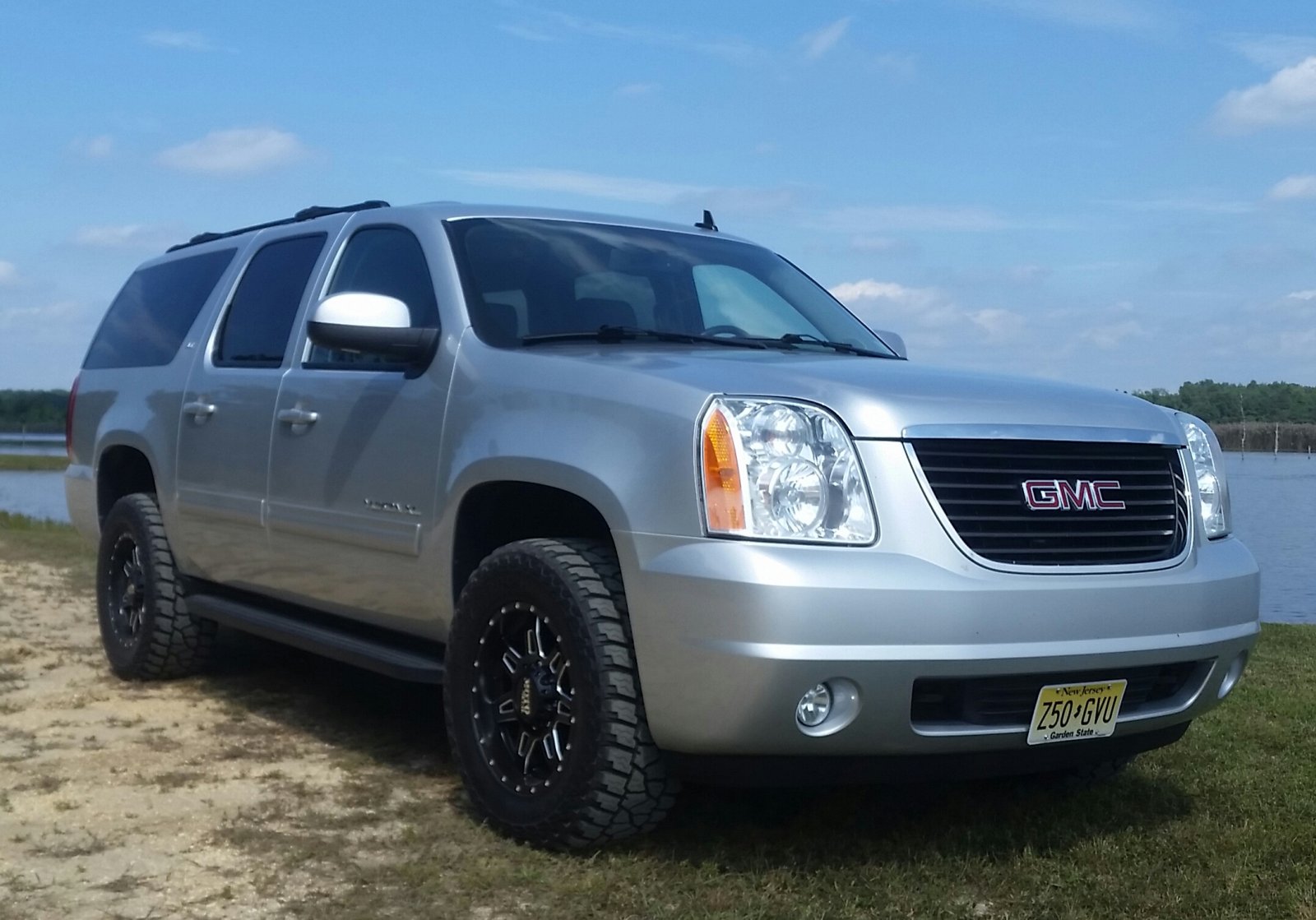

Came out perfect IMO. Right at the edge of the fenders
That’s pretty much the look I’m going for. I looked in your build thread and you described the trimming but I didn’t see any pics. How involved/extensive was the trim?

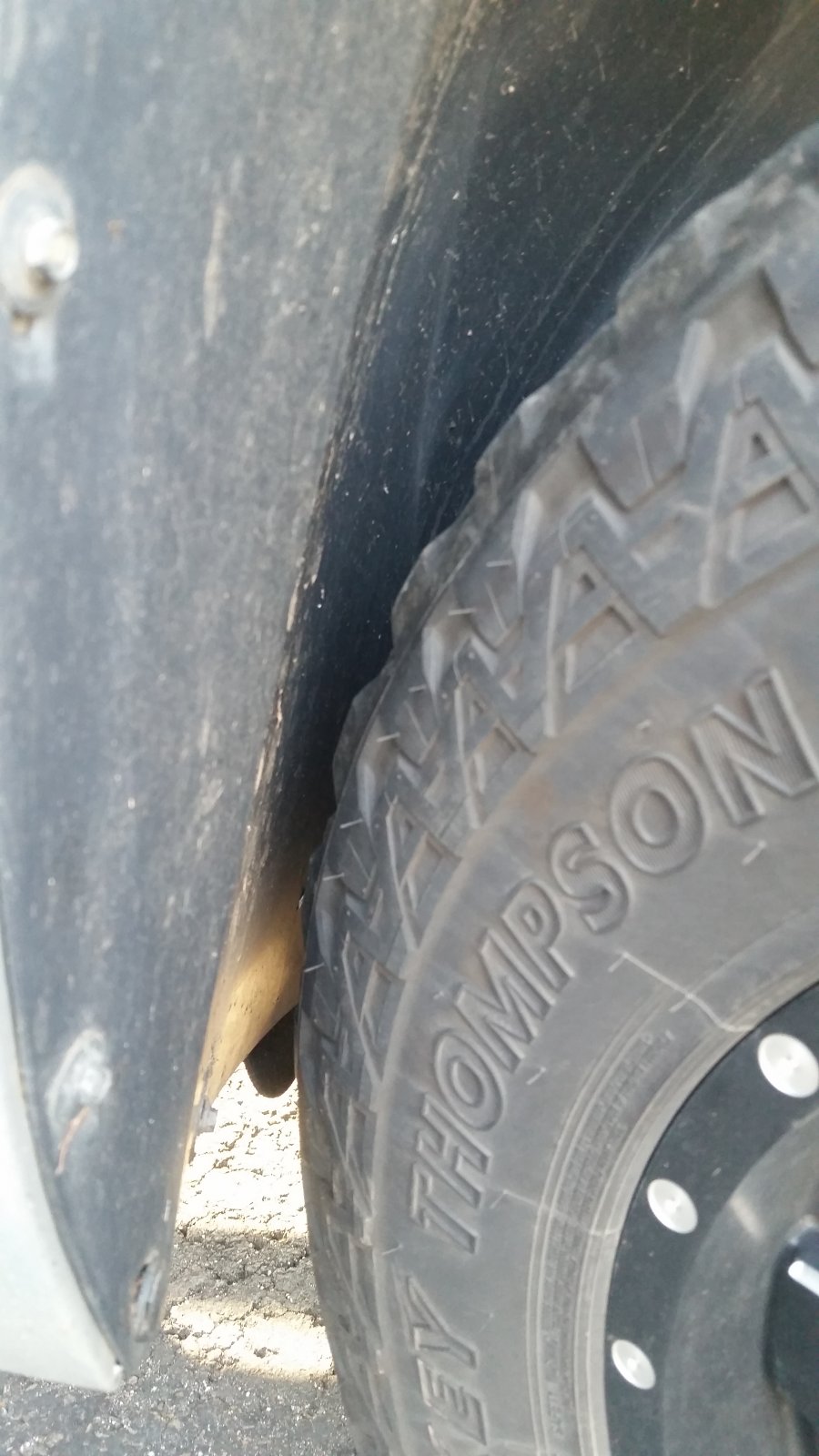

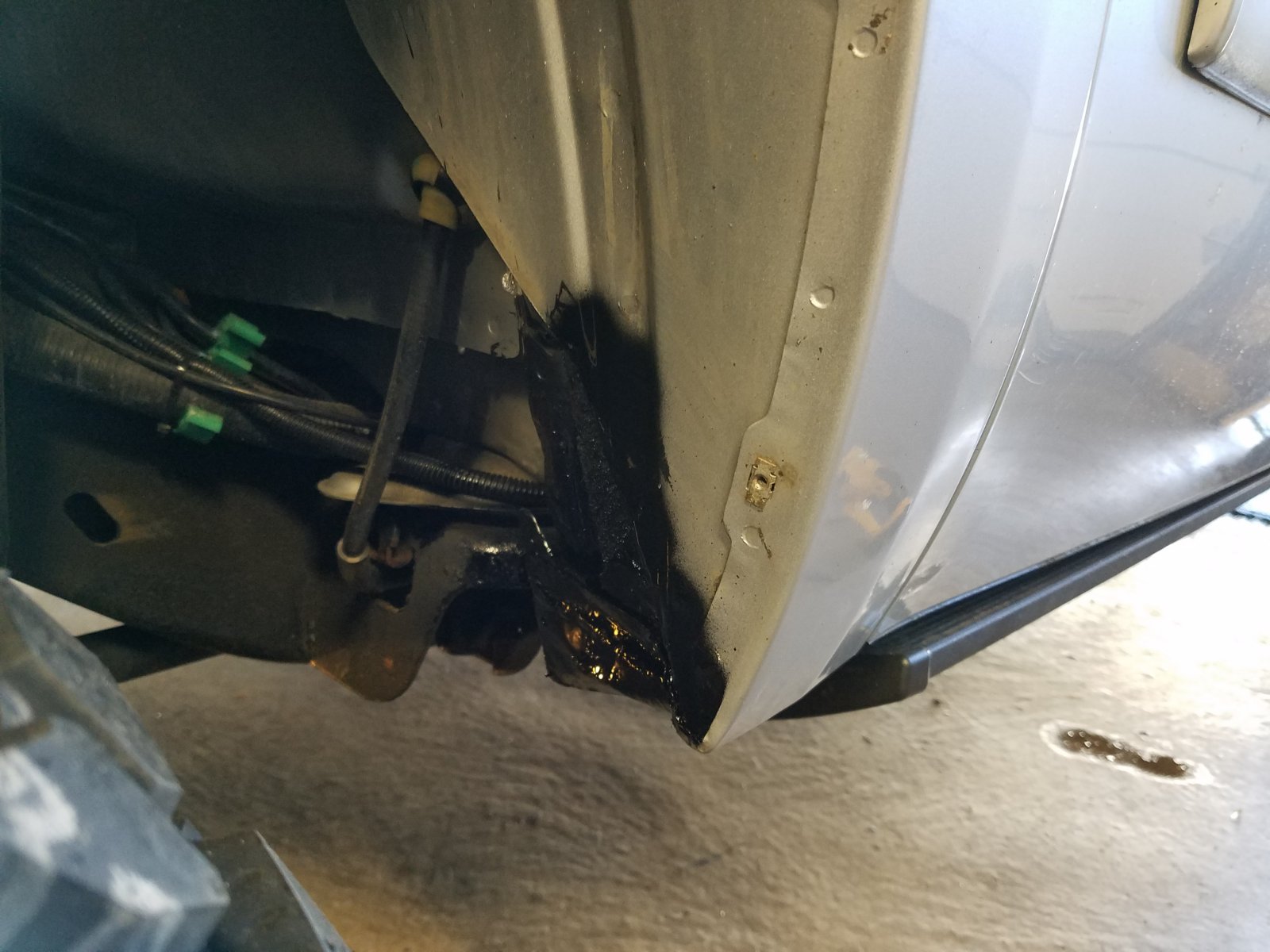

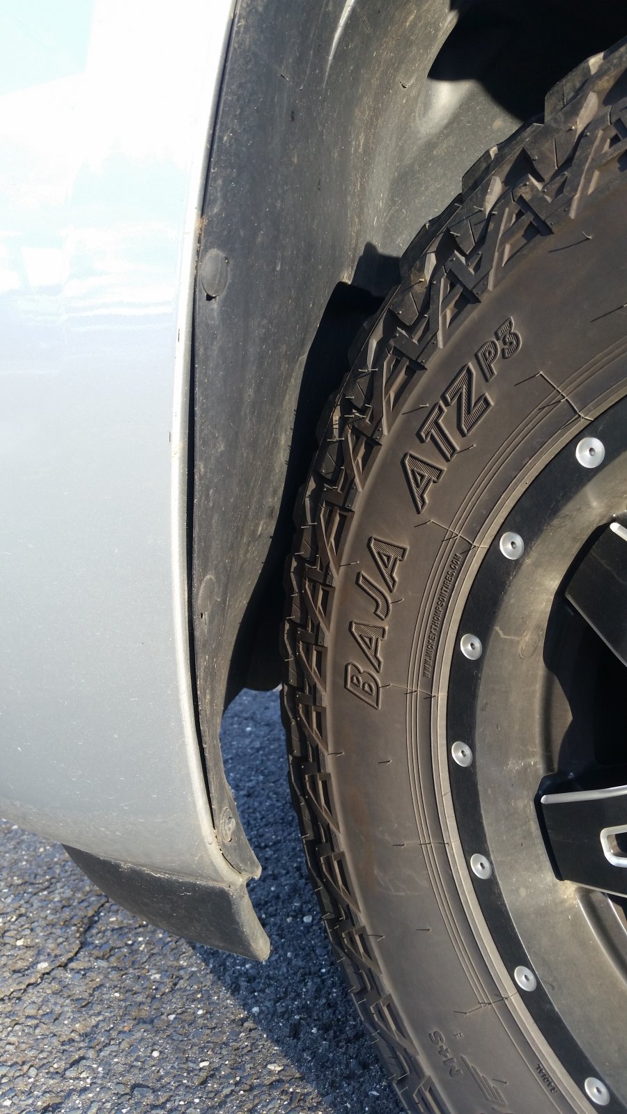

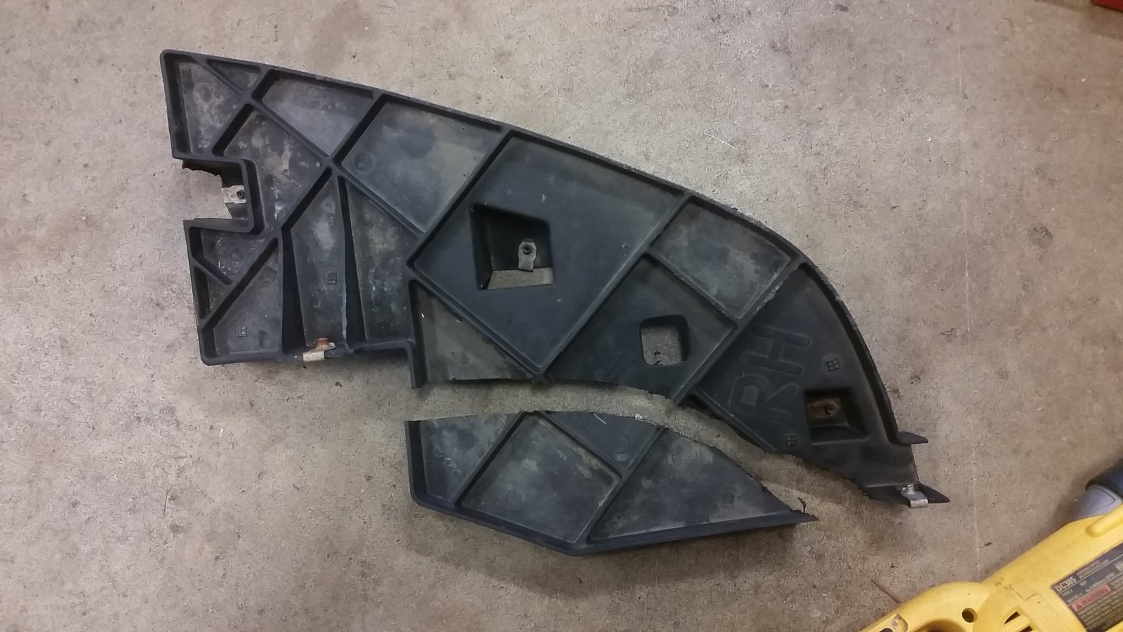

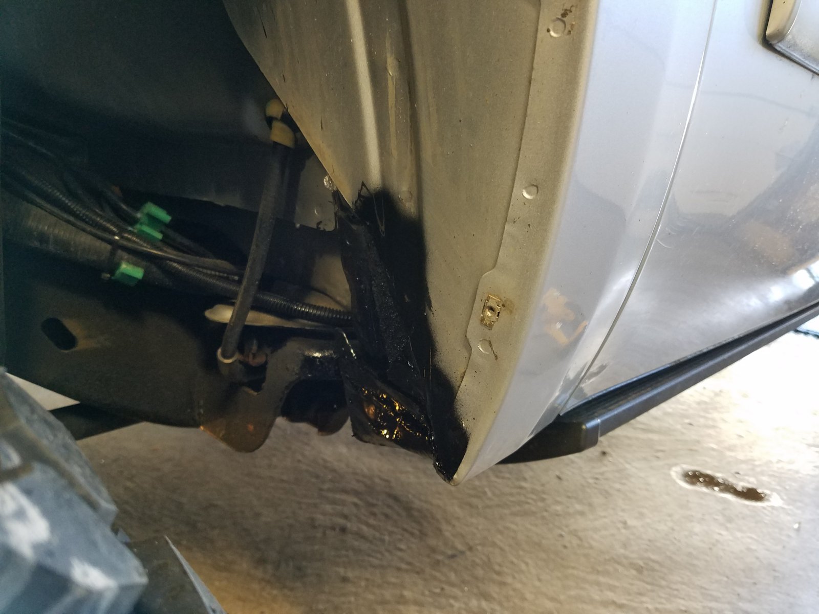

Front bumper supports cut, then reshape the liner with a heat gun, zip tie to hold it back
Pic of passenger side
Pic of driver side complete
Norcal fender mod for the firewall side of the wheel well
Self tapper to hold the liner back

Hope you don't get much snow or slush in your neck of the woods. It would take much to booger up you turning radius with that little clearance.
Matt_
Jul 10, 2016
445
485
Clearance is not any different than stock. Add bigger tires, trim and reshape liners to get clearance back. Stock tires damn near touch the liners at full lock.

Only issue is I’m not really looking to cut up my truck. I’d trim some plastic but definitely no and metal.What’s the biggest I could fit without all the metal trimming ?

It's not hard to do and isn't visible once the liner is on. You basically make one "cut", then fold the two flaps of metal up onto the firewall. No structural or cosmetic changes. I smooth all edges and put a few layers of oil based epoxy for protection. Have done this on every GM truck I've had.
