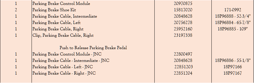

Ed, they have them in GM OE and ACDelco Professional grades and the other difference is for trucks with the push to release option (JNC) versus those without run different lengths.

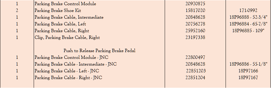

Here's the list I made for mine which might be the same for yours.
Ok, thx a lot for the quick response swath, greatly appreciated! Mine is indeed not a JNC so I presume that your 09 XL is the same as my 08 which would be the 25952160 or the 18P96885 - 109”. Rock also lists 2 others at 100” and according to their data, both the 109” and the 100” fit both the std length and the XL‍♂️ I will double check the part # with my dealer as he will search by vin before I order.

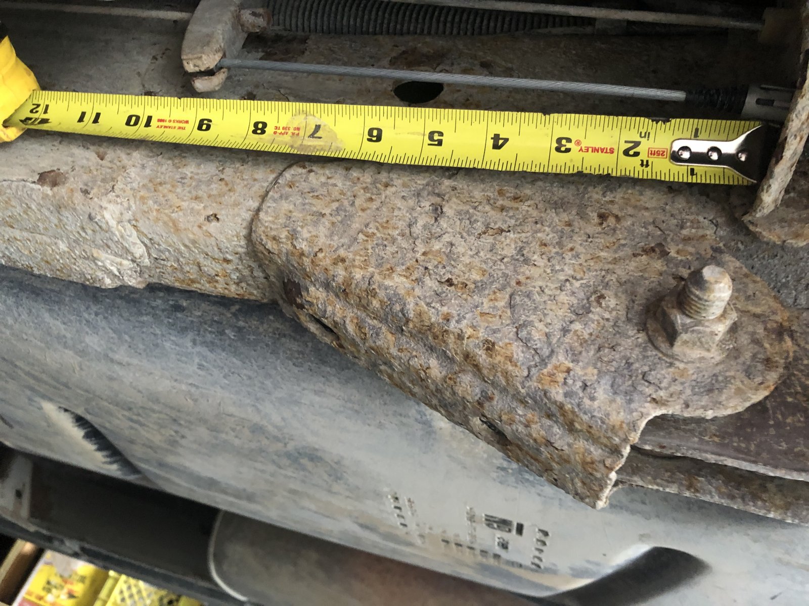

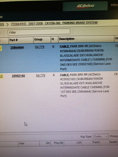

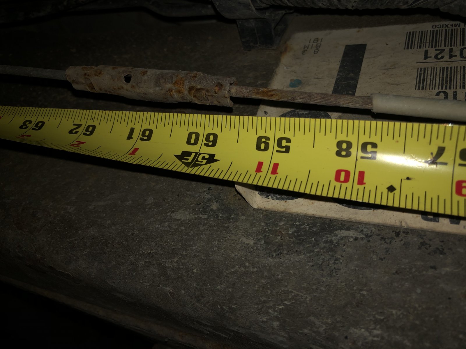

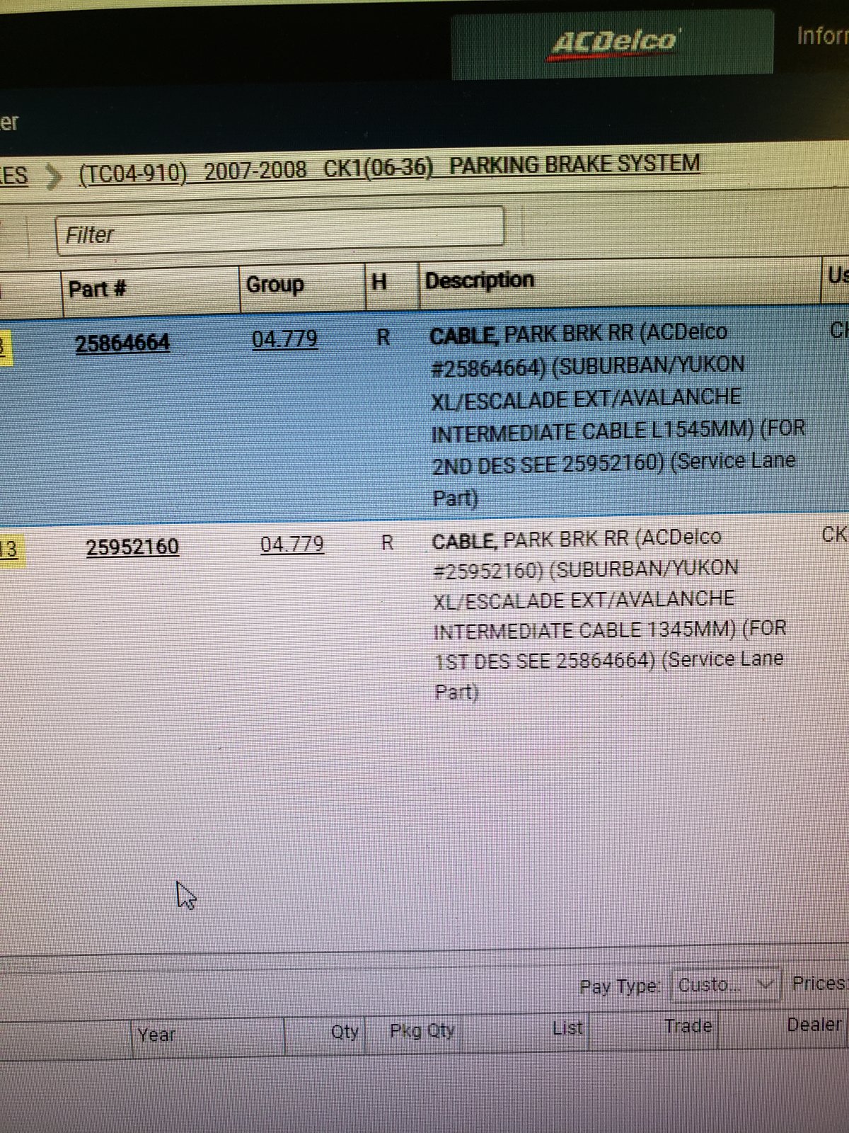

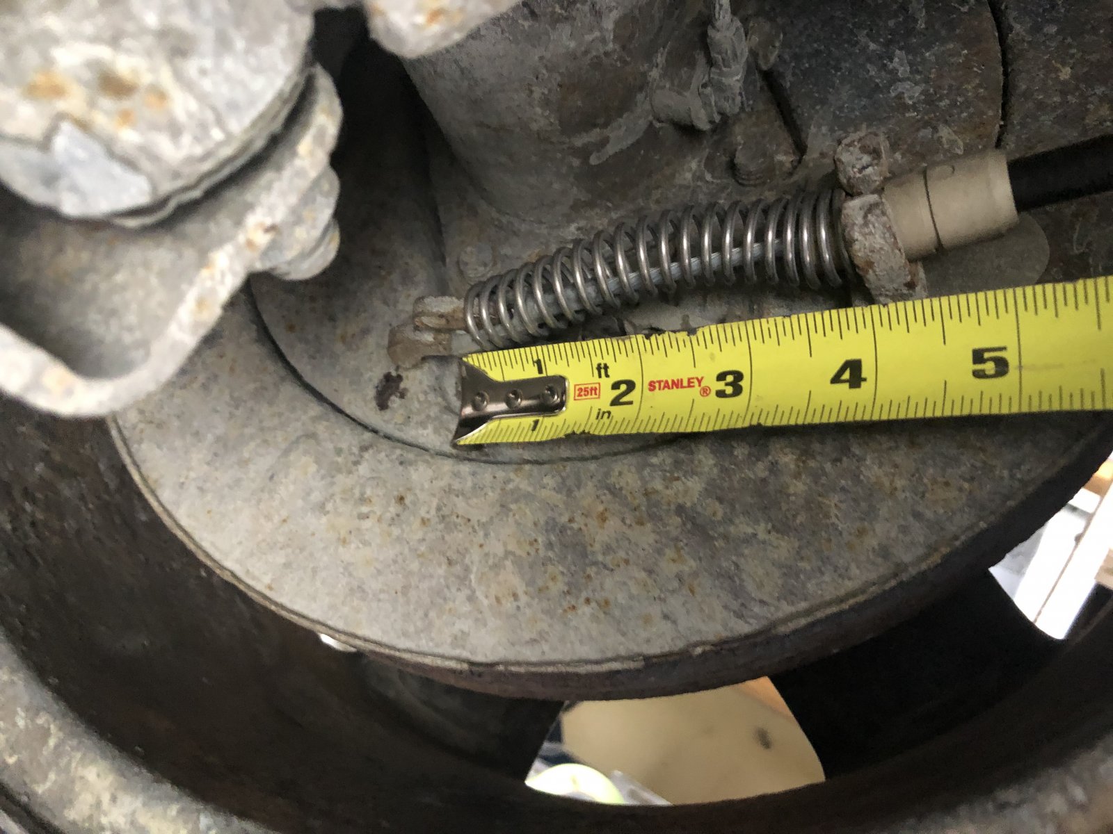

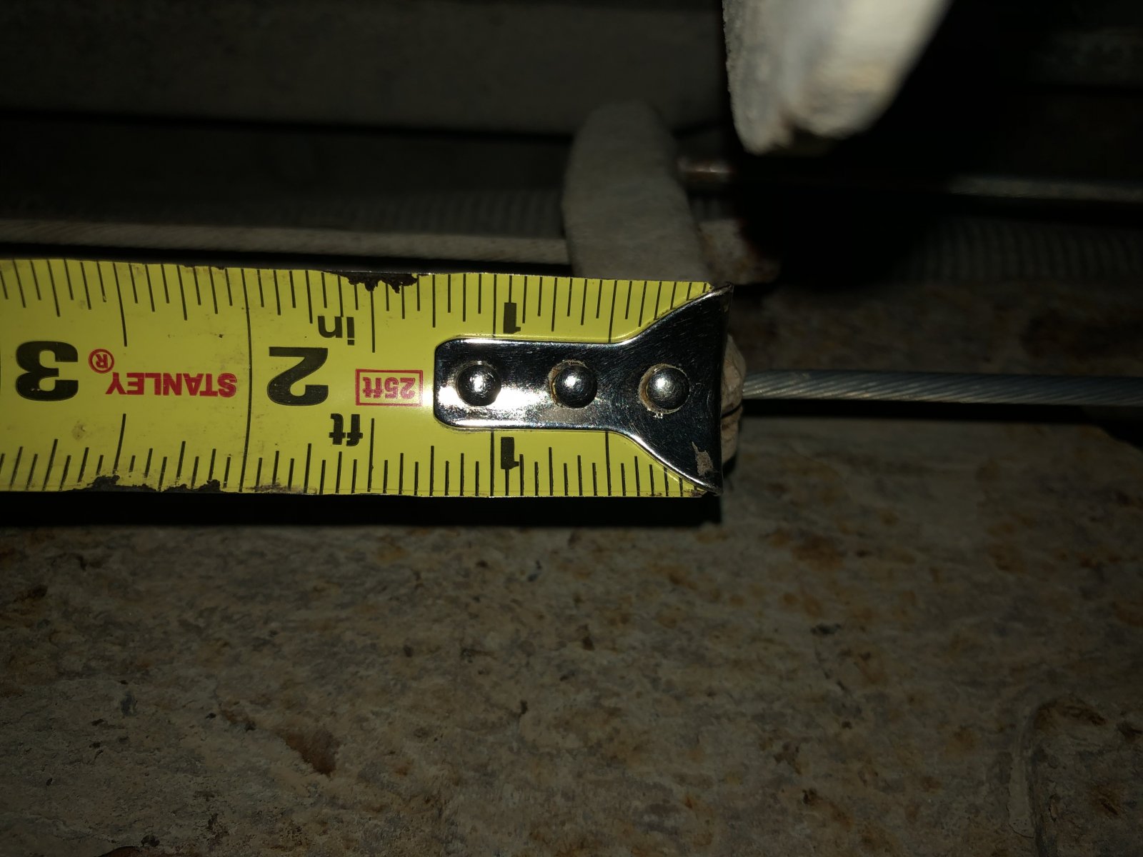

So, I have determined that there are in fact 3 designs of parking brake, the JNC (push to release) and the 1st design and the 2nd design. Mine is not JNC so is it 1st or 2nd? After checking with my dealer and suppliers, I was unable to determine by vin however, the suppliers provide a vital clue. Along with the cable (length left or right) they also specify the length of the intermediate cable that it goes with. In my case, the intermediate is 1545mm (60 5/8”) and as such is the “1st“ design and therefore the right brake cable for mine is the 100 3/4 which is GM 25864664. I wrongly ordered the 2nd design 109” cable and discovered that the jackets are identical on both (87”) however the overall length of the cable is 8 1/4” too long. I presume that difference is all at the forward end of the cable as the wheel ends on both look the same (same spring). Some pics hopefully clarify for my XL, 60 5/8” for the intermediate and 87” jacket (not shown) + 4” at wheel + 9“ at forward end for approx 101”. First 2 photos shows me measuring intermediate and then the cable lengths protruding from jacket on the wheel and forward ends of the right side cable.
