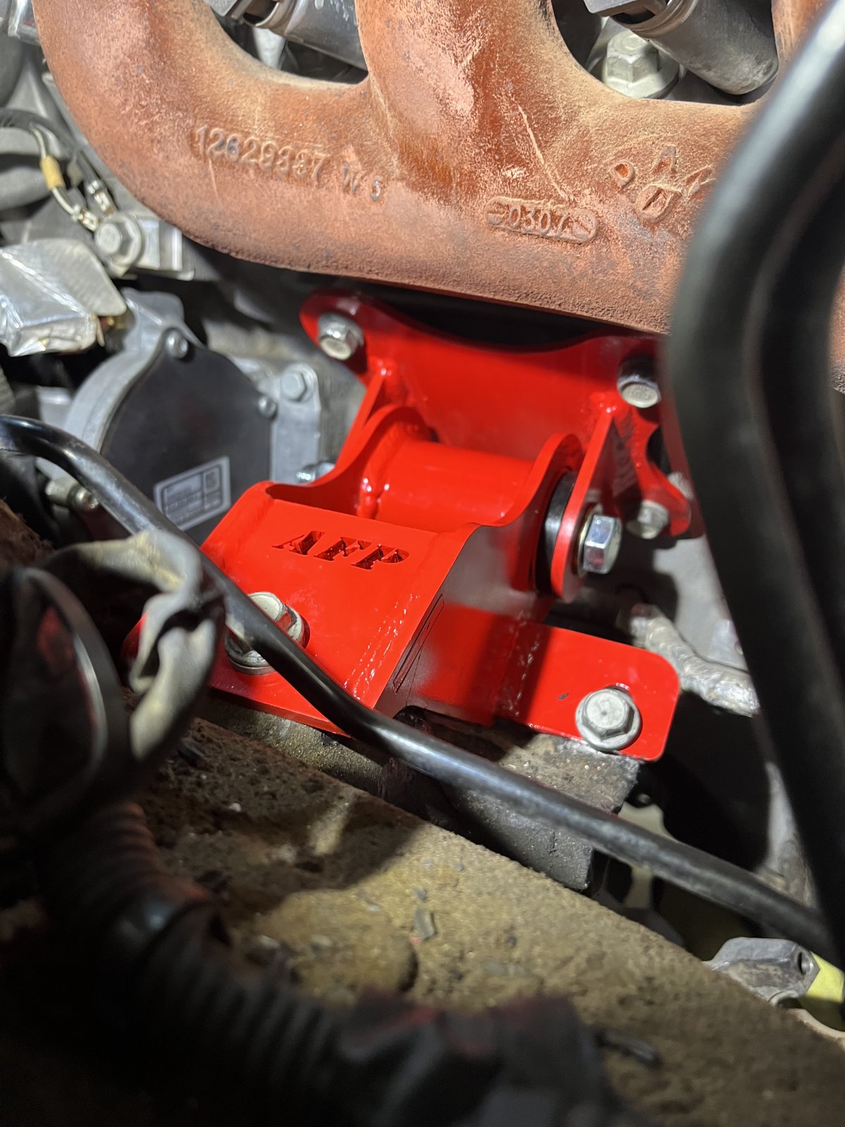

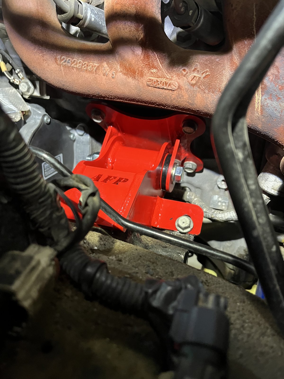

Replaced the driver’s side mount yesterday. What a PIA. Dropped the differential, but in order to do that I had to disconnect a million wiring harness, remove the cross member, remove the differential support brace on the passenger’s side, unbolt the CVs, unbolt and remove the U-bolt cross straps so that I could get the driveshaft out of the way..then I still ended up having to remove the wheel liner and the steering link. 7 bolts hold the motor mount in place. I removed 2 from the bottom, 2 from the side going right above the strut, and 3 from the top. To remove the actual motor mount itself I wiggled it around and got it out going through the bottom. I don’t think it’s possible to pull it out from the top without removing the exhaust manifold. I got it out through the bottom but only because the differential was removed. I replaced the original mount with an AFP motor mount which was pretty straightforward. I would recommend putting a square, thin poly pushing between the mount and the frame if going with AFP because there is definitely more vibration felt in the pedal and the steering wheel with the AFP mounts.
I was hoping to replace thw passenger’s side as well but it’s just not possible going through the bottom..even with the diff removed, the power steering assist motor is in the way as well as a bunch of cooling lines. The only way possible is to remove the exhaust manifold and go from the top and side. I think I’ll tackle the passenger mount later when I do headers.
