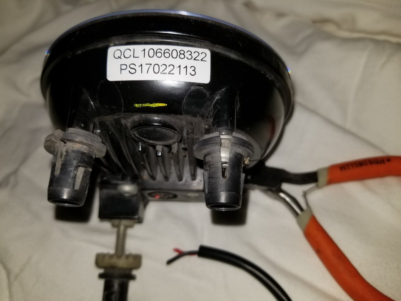

I went with CREE LED's inside and out , except HID headlights w/Halos and the Fog lights are
Morimoto with yellow covers. a little pricey at $244 a pair but they keep the light low and also to the right shoulder. I had one go bad within a year ad they replaced it no prob.
https://www.morimotohid.com/morimoto-chevrolet-round-xb-led-fog-lights?quantity=1

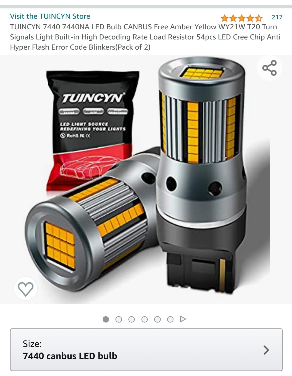

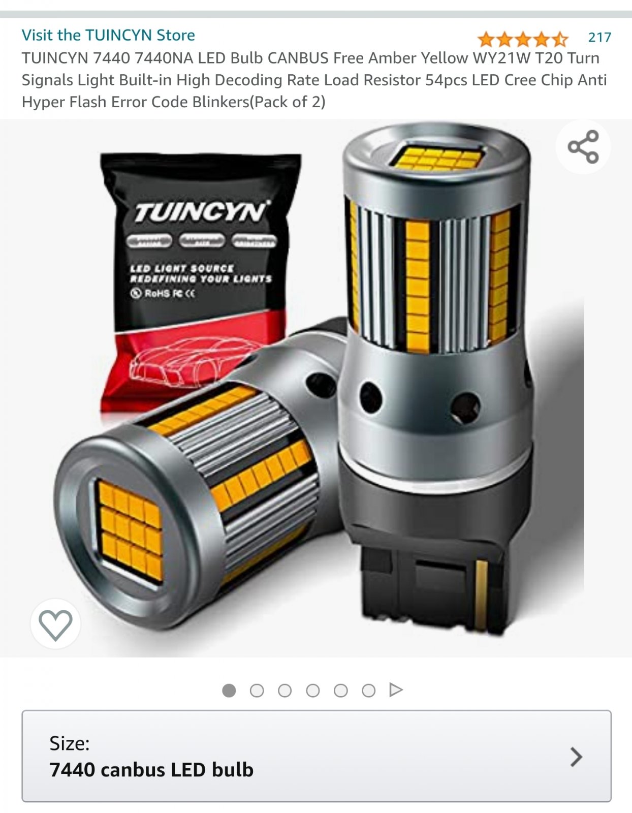

I have a 2021 Premier, same rear assembly, amd was only able to find the amber turn signals that work without receiving an error. The reverse and Brake lights give an error on startup ( I have tried over 10 pair of canbus bulbs). As far as the turn signals, the bulbs are 7440 and the ones attached work excellent on my 2021 Tahoe Premier 4X4 with zero errors. I hope this helpsScreenshot_20210220-124907_Amazon Shopping.jpg

I have a 2021 Premier, same rear assembly, amd was only able to find the amber turn signals that work without receiving an error. The reverse and Brake lights give an error on startup ( I have tried over 10 pair of canbus bulbs). As far as the turn signals, the bulbs are 7440 and the ones attached work excellent on my 2021 Tahoe Premier 4X4 with zero errors. I hope this helpsView attachment 271349
These worked for me as well with no errors. Just need an error free plug and play replacement for reverse lights now. thank you for sharing!

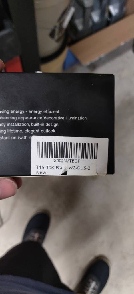

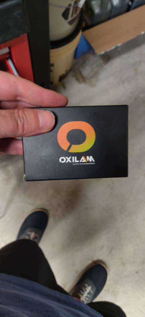

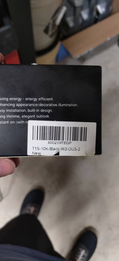

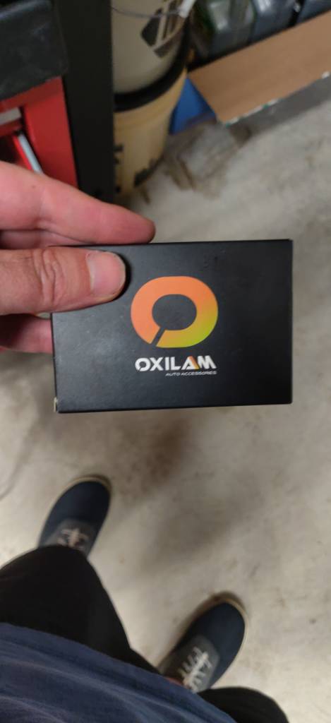

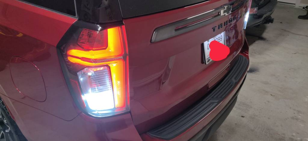

Edited - Oxilams from Amazon do not work.
