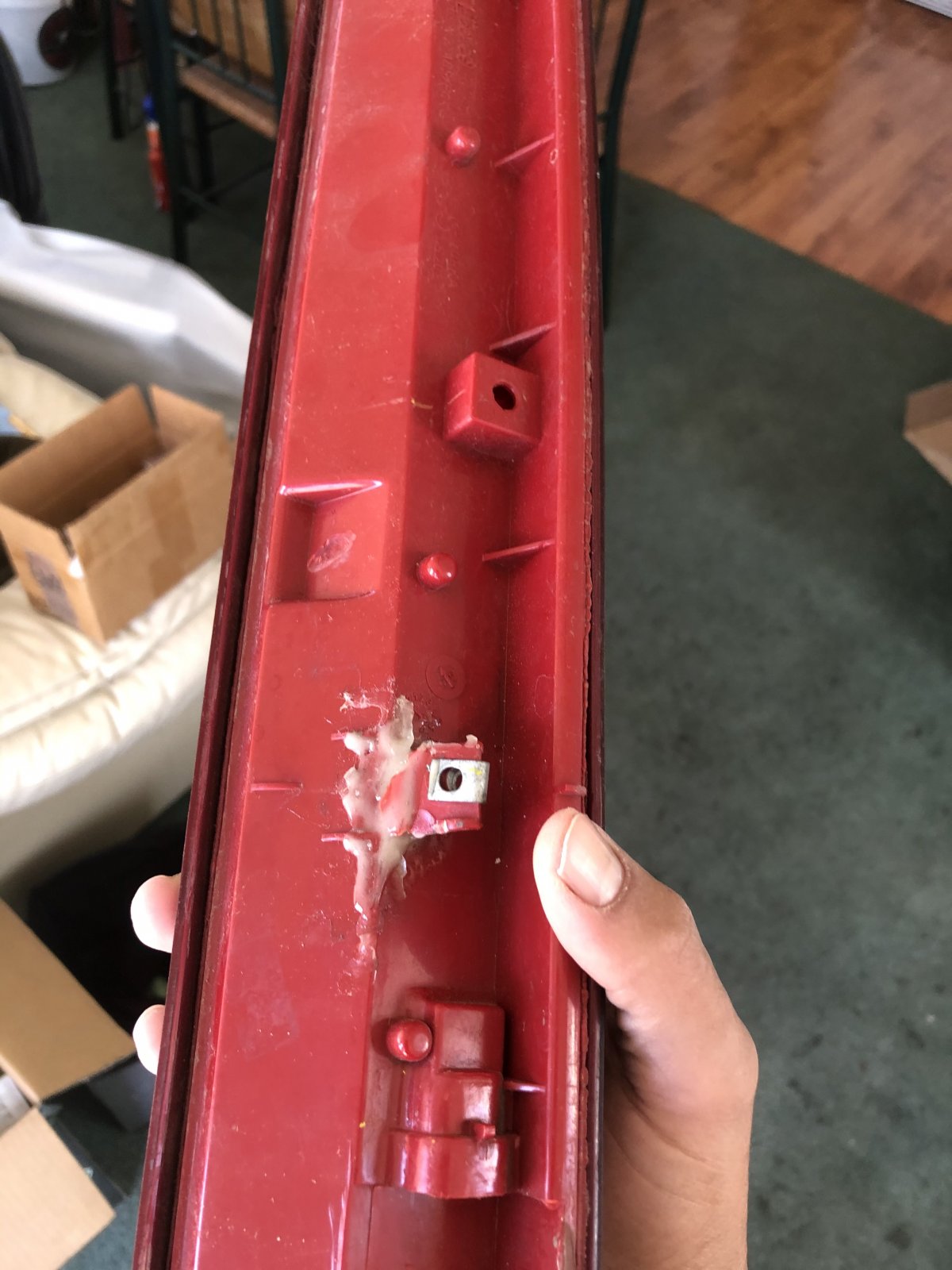

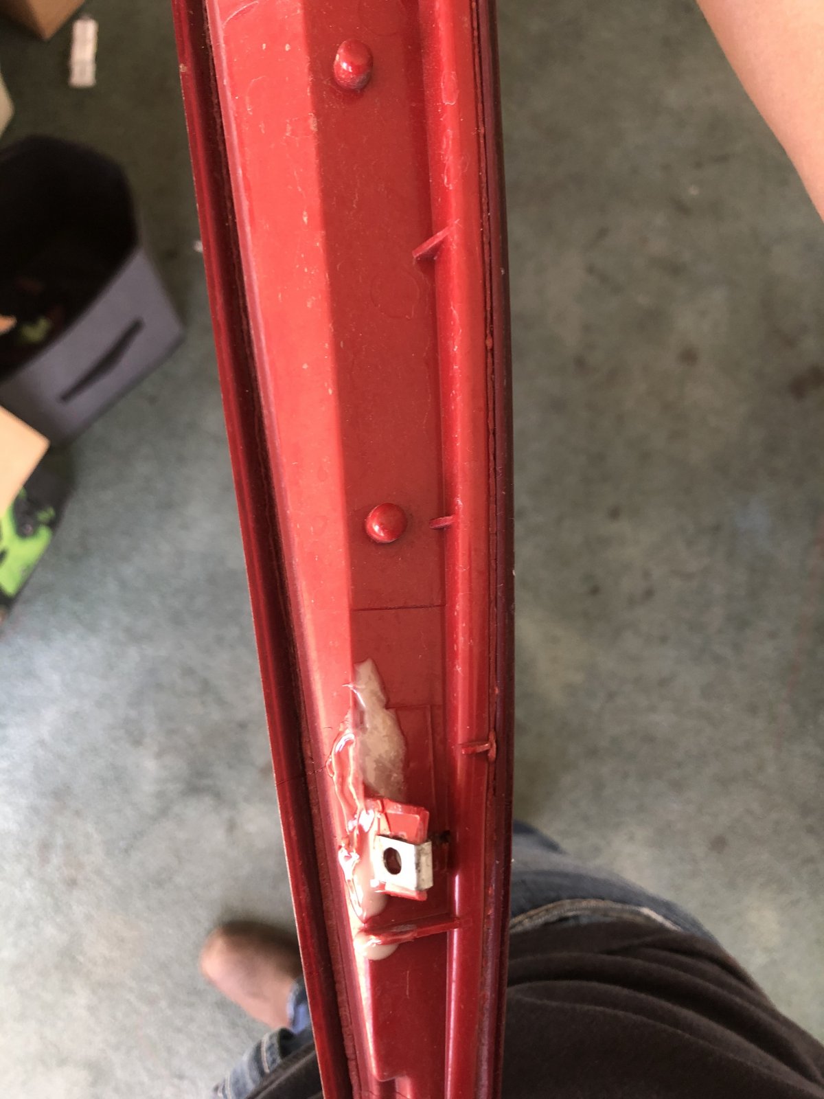

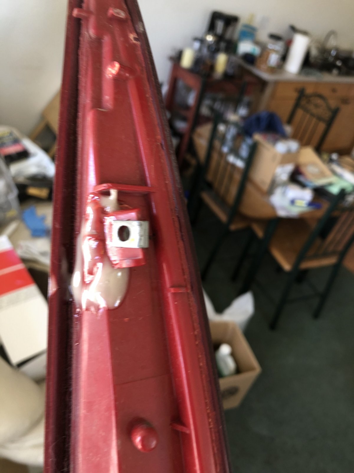

So I’ve noticed all week that my esky third brake light has been loose and not sitting in the housing correctly and I couldn’t figure out why the screws were all in place correctly. Turns out the plastic tabs where the screws go into the underside wifi the light were all starting to break. Well yesterday at the end of a frustrating work day of detailing a boat, the finally snapped. The light was just sitting loose in the base. So I unscrewed it and grabbed the light and put it in the truck. Thankfully where I was working was super close to home. Got home and grab the JB weld plastic bond that I had sitting at the house. Cleaned the areas and put tabs back in place with plastic bond. I let the whole house sitting over night upstairs in my apartment and the plastic bond cured perfectly. All the screws are back in and the light is snug on its base. I may see if I can pick up another light. But for now it’s ok. We shall see how long the tabs hold up.

View attachment 259274 View attachment 259275 View attachment 259276
Good work Chase. Man, you’ve had a lot of trouble with that whole rear hatch area..!
