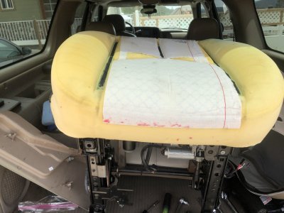

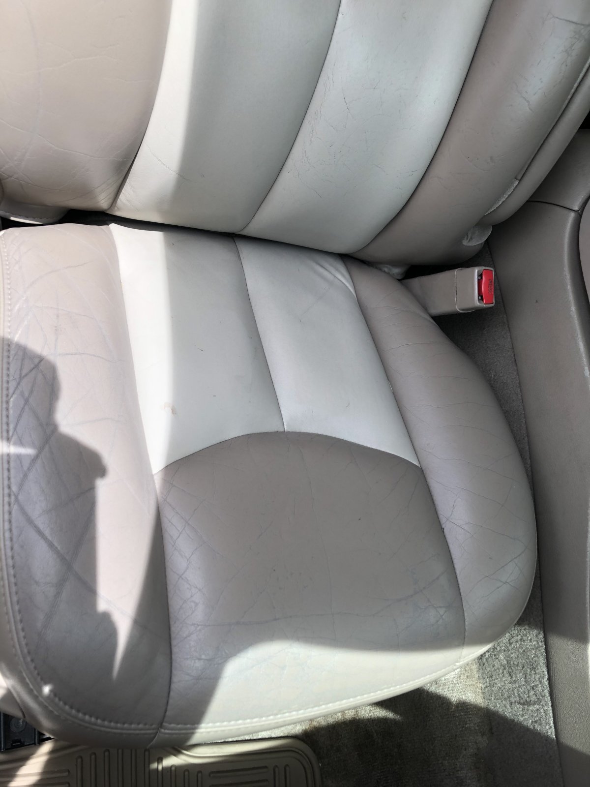

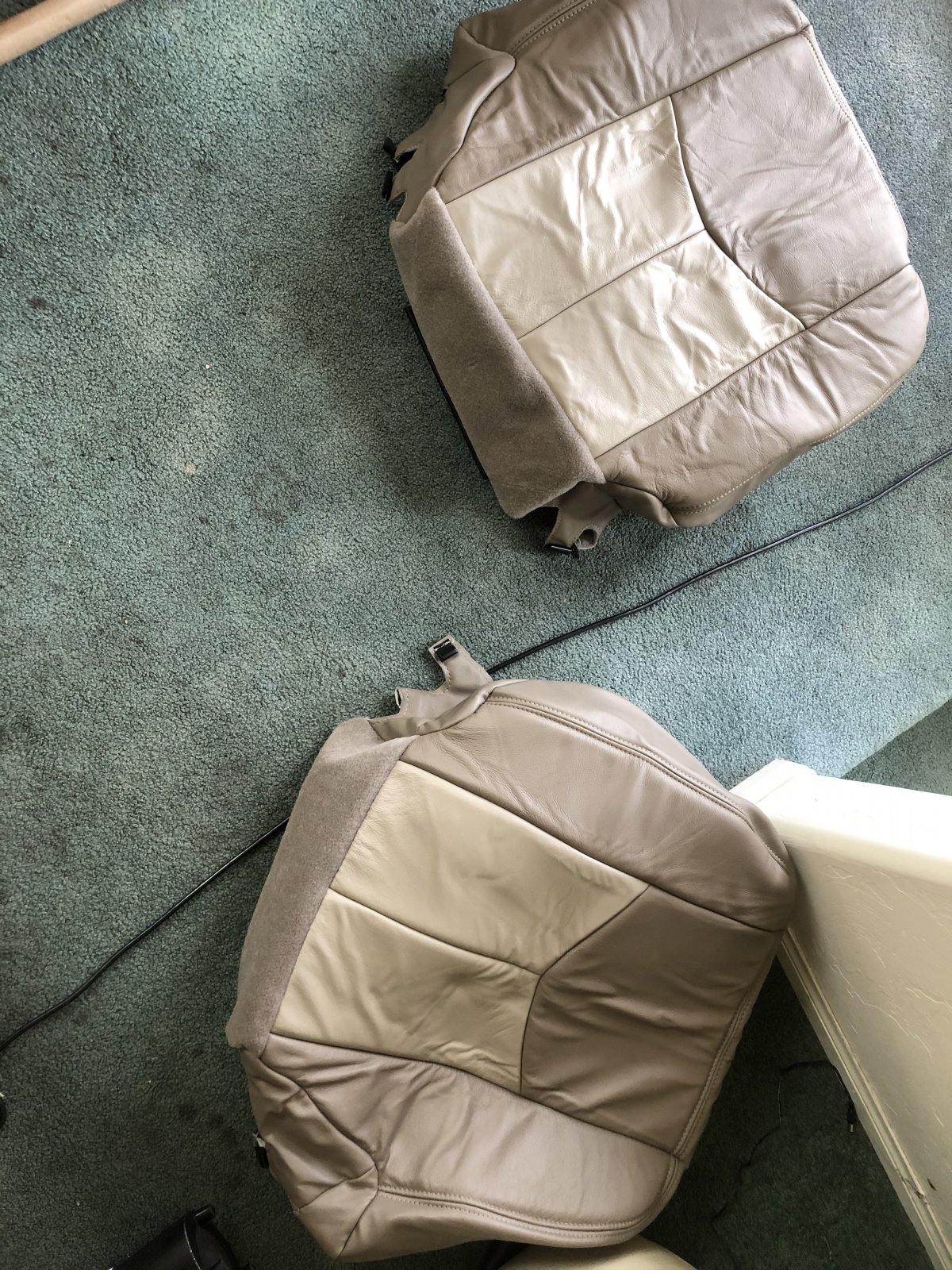

Well got the passenger side done. Not too difficult. Just lots of little time consuming things to do. Holy crap there’s a crap ton of wires and corresponding harness les to unplug under there while removing the bottom portion. That was an adventure! anyways here’s what my passenger seat bottom looked like:
Not in too bad of shape. Just worn. And I figured since I needed to buy a drivers side I may as well order this one too.

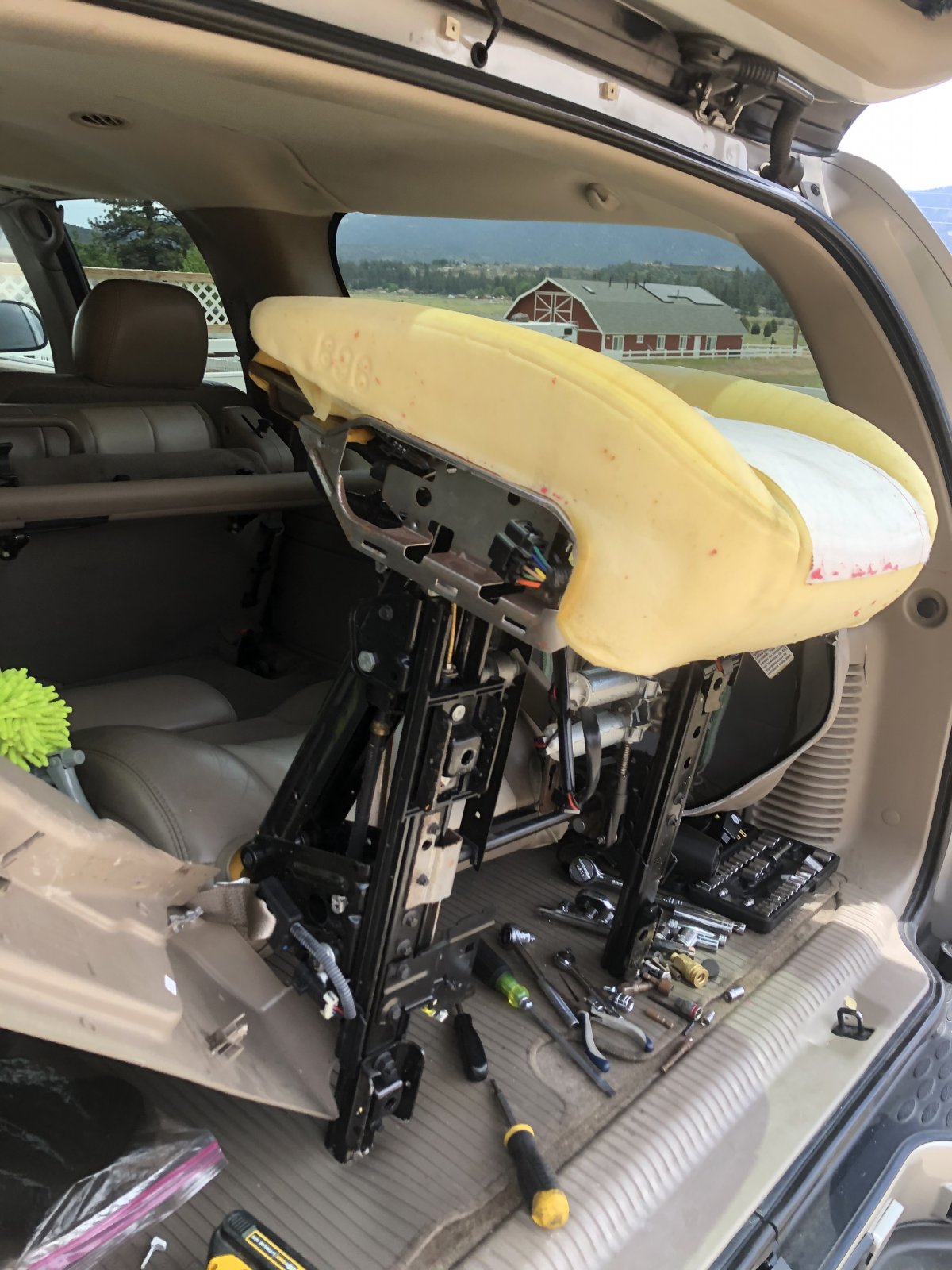

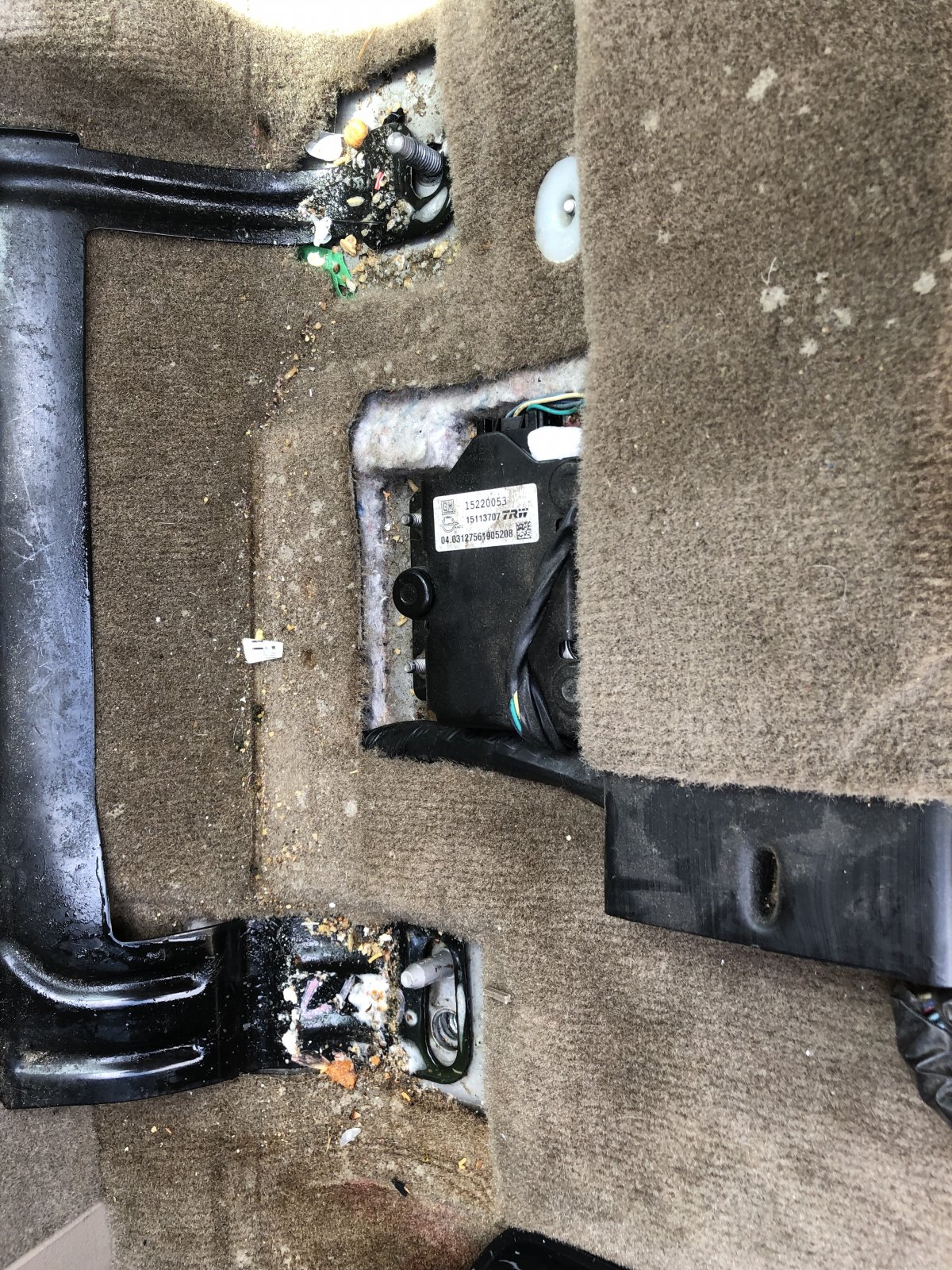

Seat apart and out of the truck:
4A83DFBA-52F3-4C2A-8C1D-222A09E60656.jpeg 44748BE9-C070-49C5-B8AA-B2B8194A2E02.jpeg

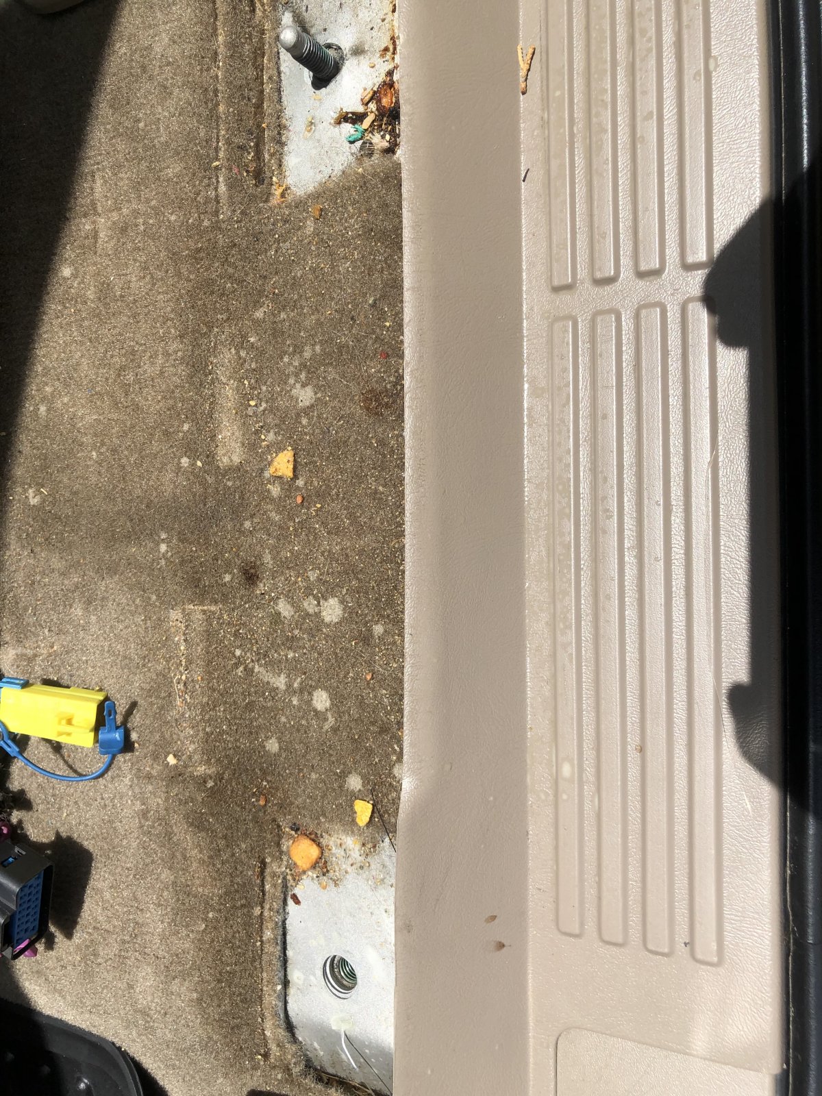

There was a crap ton of dirt and crap under the seat: ED5AF831-8102-4511-8175-9936940054B5.jpeg AD50CBC3-22E2-41F8-A179-8E42E513779E.jpeg
So I vacuumed and it hit with a little bit of carpet shampoo product and a brush, and then sucked it all out with my shop vac. Good and clean before the seat went back in.

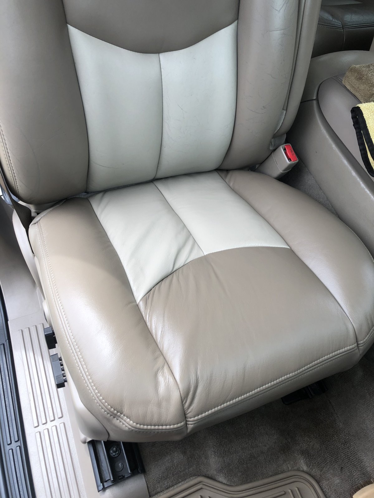

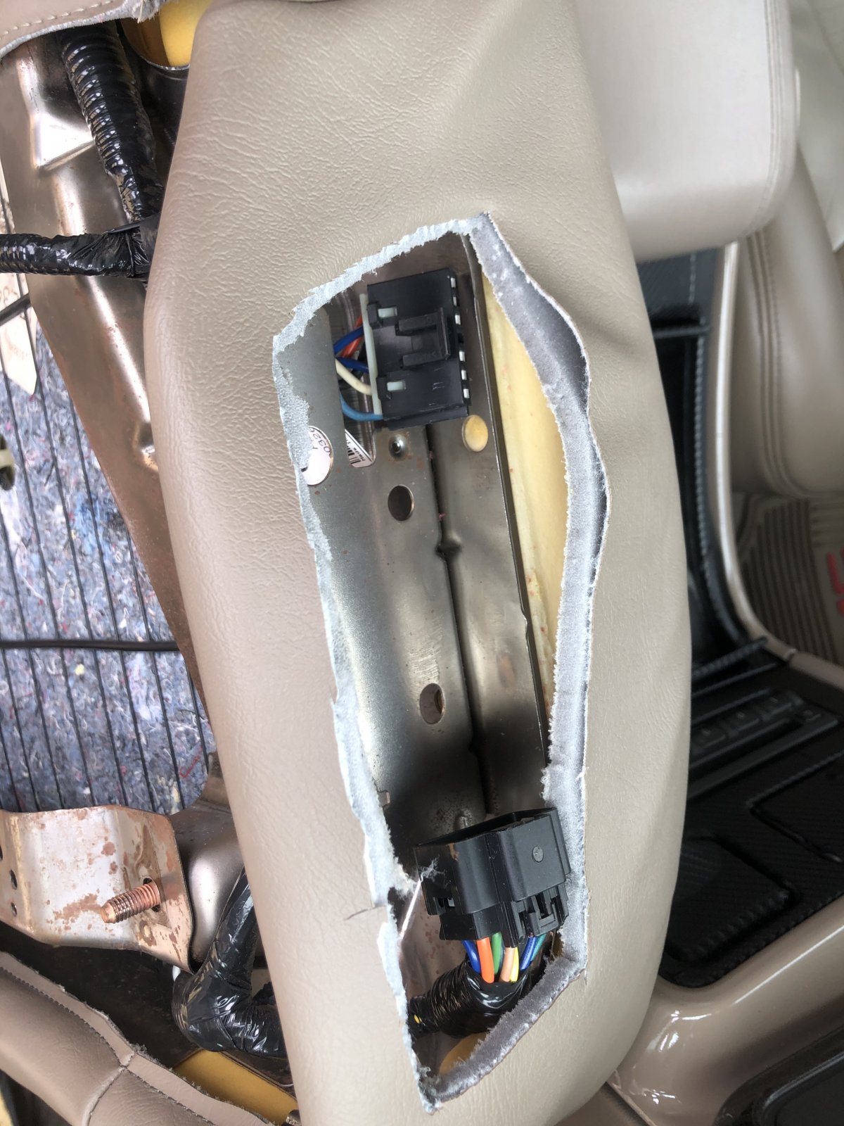

My only complaint about these leather covers is that they didn’t have the cutouts in the side panel for where the seat adjustment panel and controls go:
So I had to very carefully cut out a hole to be able to put that panel back on, I think I did a pretty good job: 990A63C5-76EE-4C35-ADF8-C350B440F6B8.jpeg

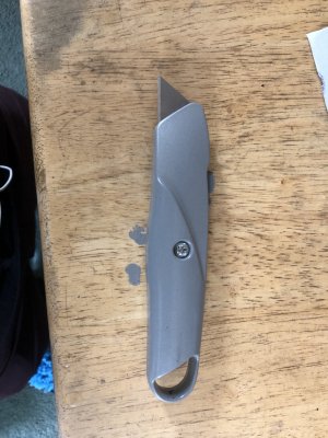

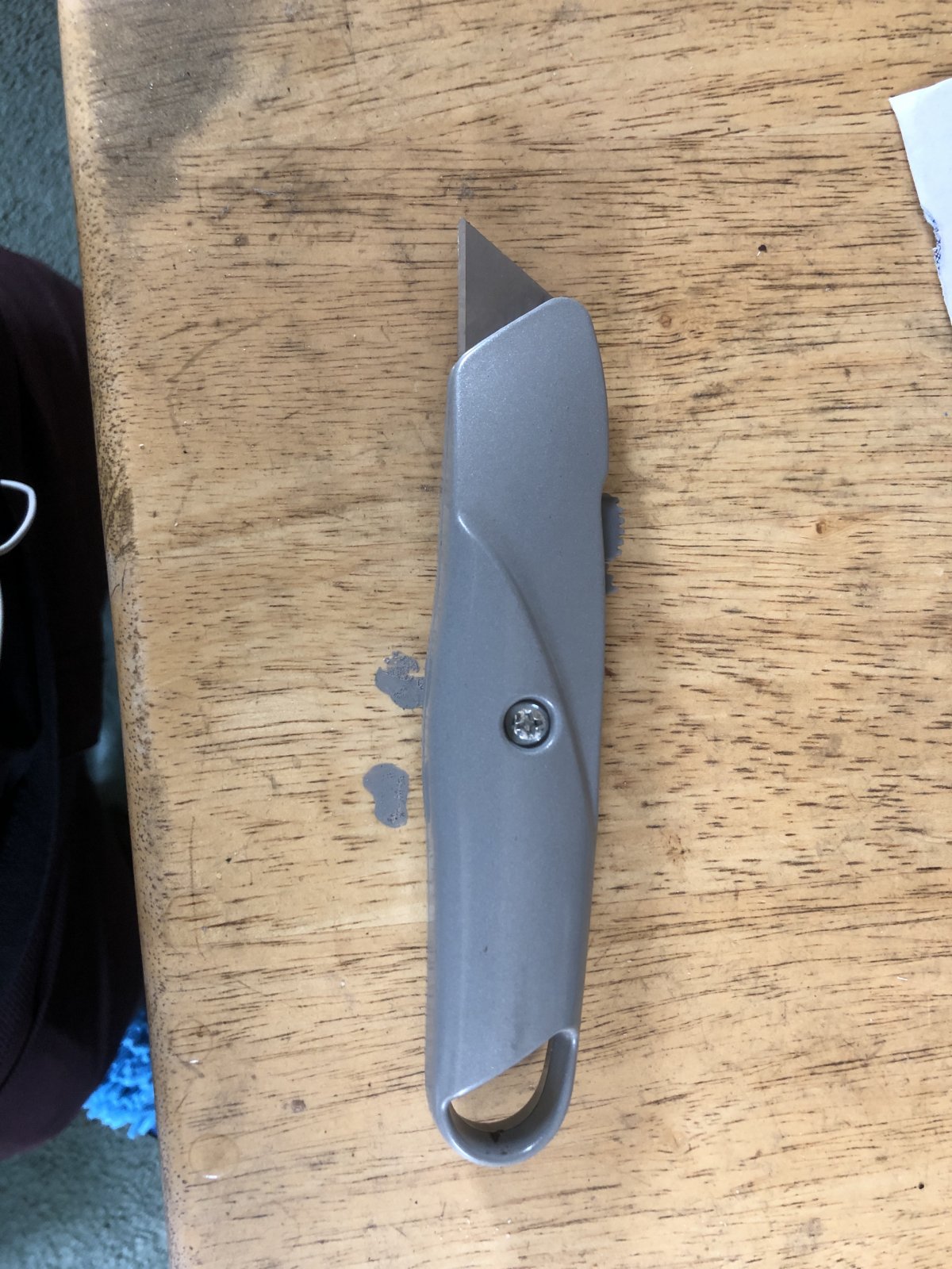

Used this little guy that came in a tool kit that I got last summer to cut the opening: image.jpg

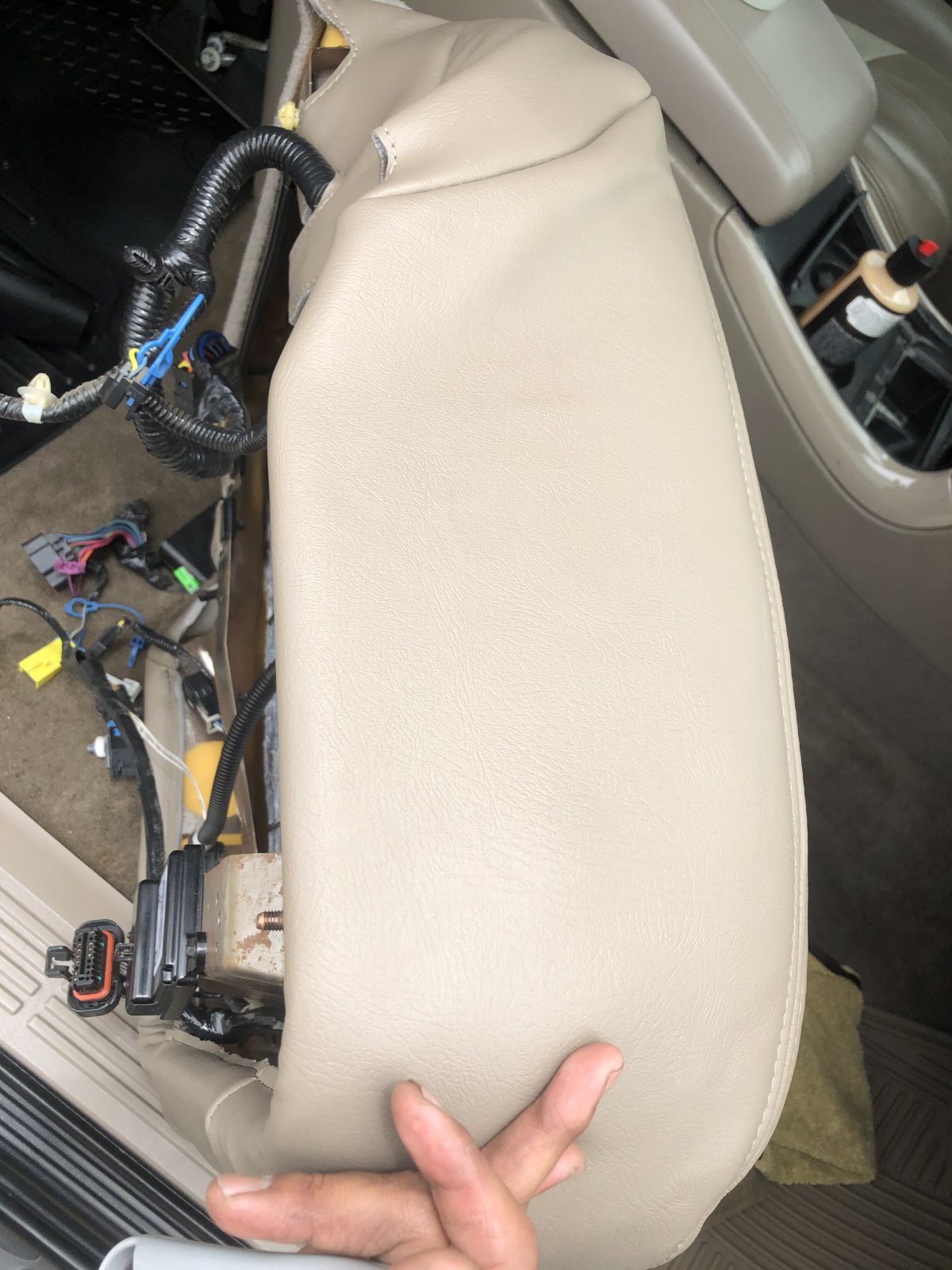

Don’t know what that tool is called. Lol. Anyways the final product all out back together and bolted back into the truck: 93695EF2-C040-4B21-9FF8-BDD3F4731432.jpeg
I’m satisfied with my work. Not by any means perfect but much better. And the wrinkles in the leather will settle and even out over the course of the next few days. And of course I scrubbed with CG leather cleaner and then followed behind with CG leather conditioner. My favorite products haha.
