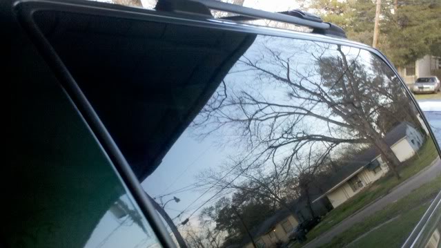

Question about the OnStar antenna on the inside of the rear window in the cargo area (see pic). Is there factory window tint film under this antenna that will get damaged if I remove it? I drive a 2001 Suburban LT. I already removed the outside antenna, the module by the rear view mirror, and the dash buttons with no problems. Thanks for the help.

are you really sure its your onstar antenna??? it might be a gps or alarm antenna.. the onstar and antenna is located in the roof i believe

I believe so. On the 2001, the antenna was mounted to the glass on the opposite side of this module. I don't have any roof antennas. Also, when I disconnect the wire the onstar light would turn red. Then back to green when plugged back in.

anyways i dont think the window film will be damaged.. the windows are factory smoked so its not a film is the actually the window is alil dark.. so if you have put aftermarket tint and is only the factory smoked windows it wont get damaged..

I removed mine, no issues. The windows are factory tinted, so there is no film to get scratched. Its held on by a strong double sided tape. I used a thin razor blade and done glass cleaner for lube and just worked around the edges until it popped off. The wire I just tucked back into the headliner.
