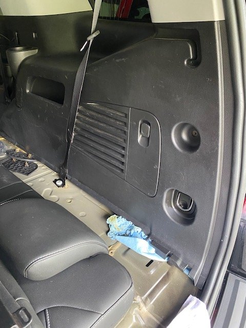

I had a container of oil spill in the rear cargo area of my 2019 Chevy Tahoe LT.
I have removed the 3rd row seat, removed all the carpet, but need to clean under and behind the interior rear quarter panels, additionally I think they will need to be out to install new carpet since it seems to wrap behind them somewhat.

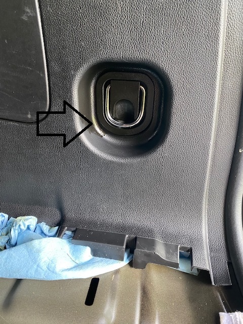

I'm not sure how to remove the tie down anchors in the side panel, no visible screw or bolt to remove.
I imagine after removing those the quarter panel should just snap off retainer clips?
Any help is greatly appreciated.

There is a black plastic cap over the bolt,it must be popped off to access the bolt ,which is torqued to 15 lb/ft.
Thanks! I was able pop off the plastic and now have access to the bolt!
Very well hidden. Thanks for the reply!

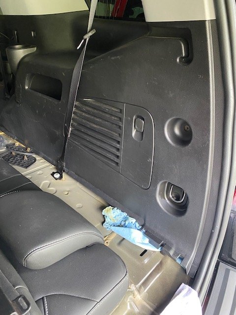

Hello, New member here, but have read many threads in the past with a lot of help.
View attachment 404239View attachment 404240
How do you get the panel itself off? Do the upper panels by the windows need to come off 1st? I have what sounds like a bolt rolling around behind my panel. Diagrams make it look like the lower panel slides up under the window panels. Any screws holding it on or just clips? Pull straight out or up? I'll take any tips. THanks,
I'd like to know this too. A screw fell into the abyss behind the panel and I couldn't figure out how to remove the darn thing.
marc1255boats
Jan 29, 2018
8
I wasn't ever able to get the side panel off so i removed the storage bin behind the 3rd row seats and cut a small hole into the side panel (covered when i put storage bin back in). I then bought a little flexible camera with light that plugs into my cell phone. Amazingly found the huge bolt that rolling around and got it close enough to the hole to pull it out with a magnet.
