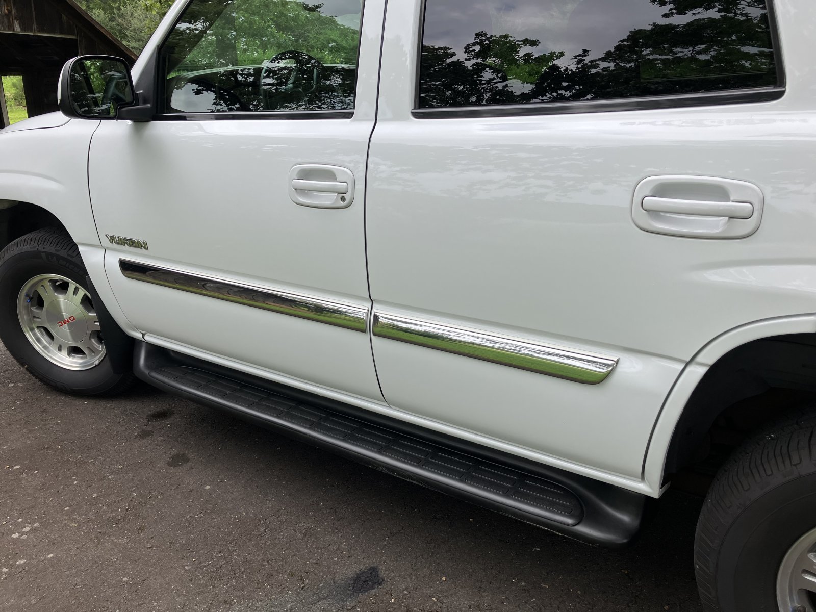

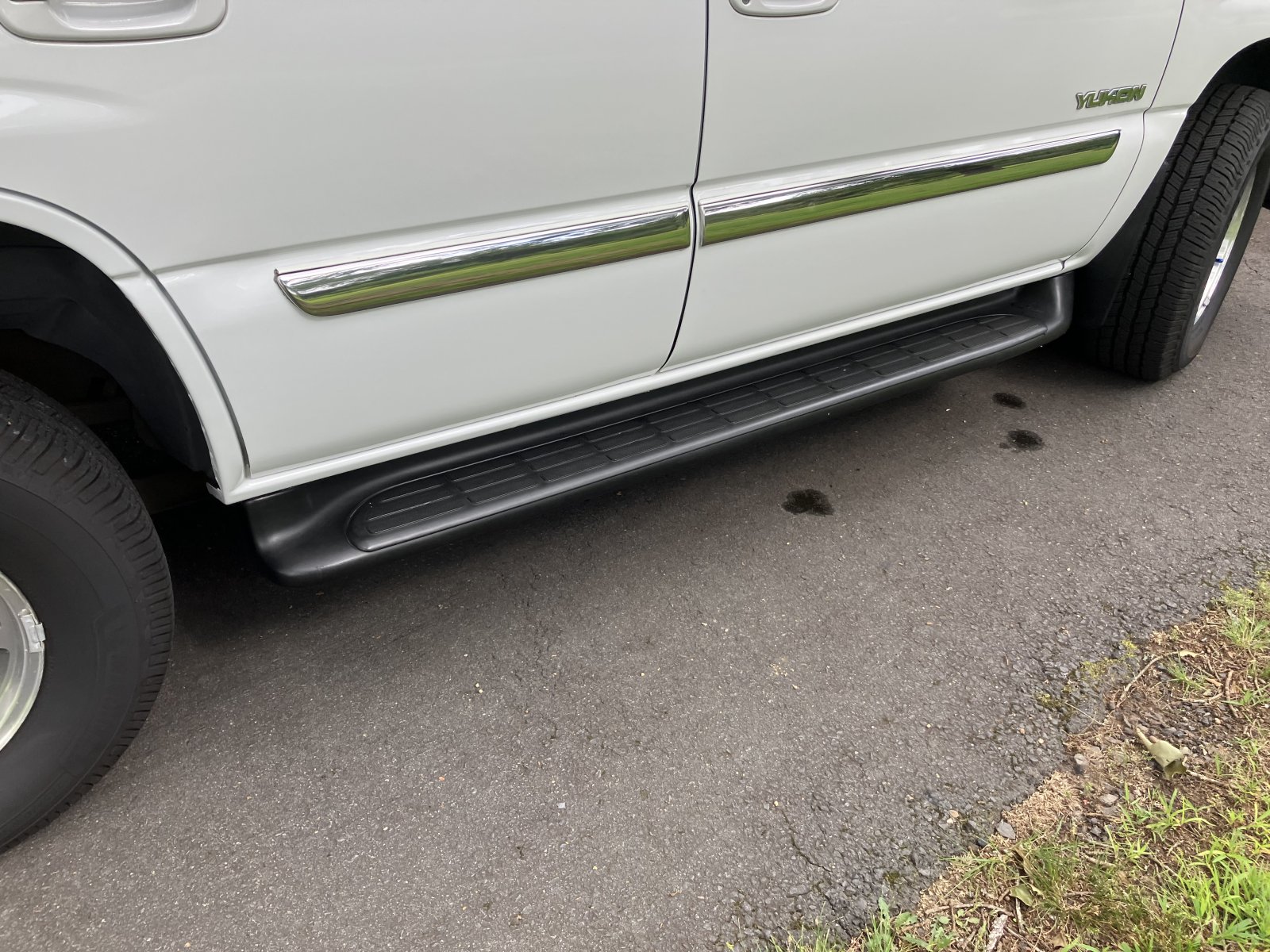

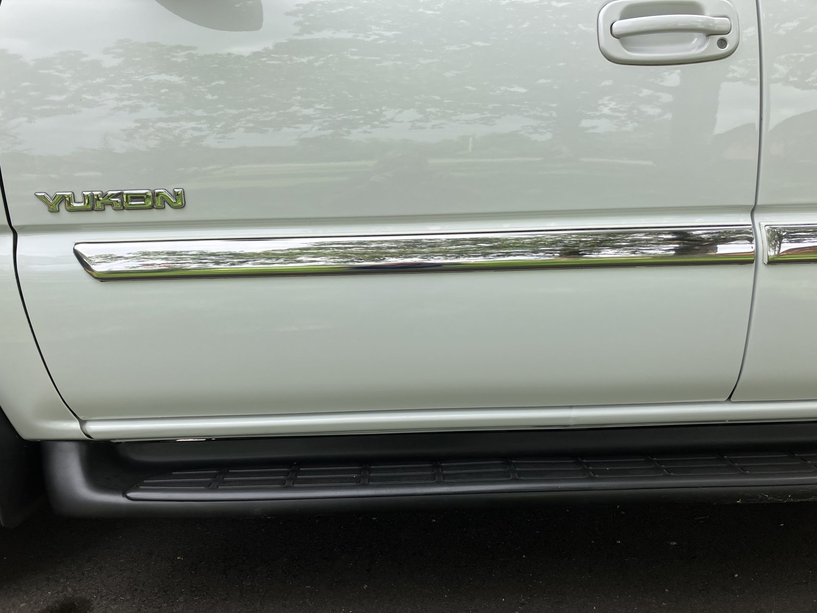

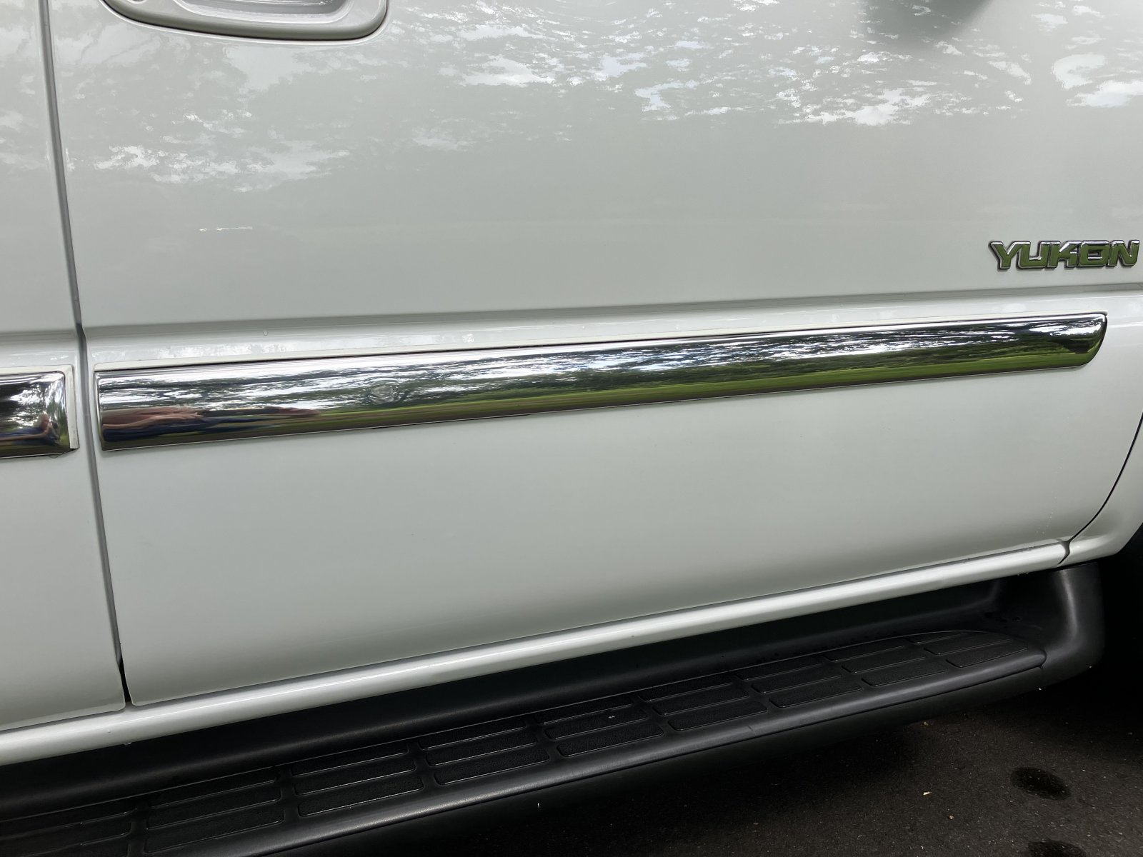

Do you have any pics of the before and after. I want to this to mine.
Here are some after pics of removing the plastic door trim. I left the chrome strip, it still looked okay.

I wish I had taken a before pic, it was so bad. Peeling away from the door, cracked, faded, brittle. I was so pleased with the condition of the paint after removing the old plastic/rubber trim. There was mold/mildew and dirt under it. The area where the trim was looks like the rest of the door paint. I washed the area and waxed it and dang it looks good. Still it’s idiotic to glue door trim on in the first place, why GM does that I’ll never know. My idea of using a sharpened wooden paint stir stick worked well to remove the glue. Like I’ve said before, this 24 y/o Yukon is the best vehicle I’ve ever owned. Fix’in to take it on a 2000 mile round trip to New Mexico and won’t give it second thought.
