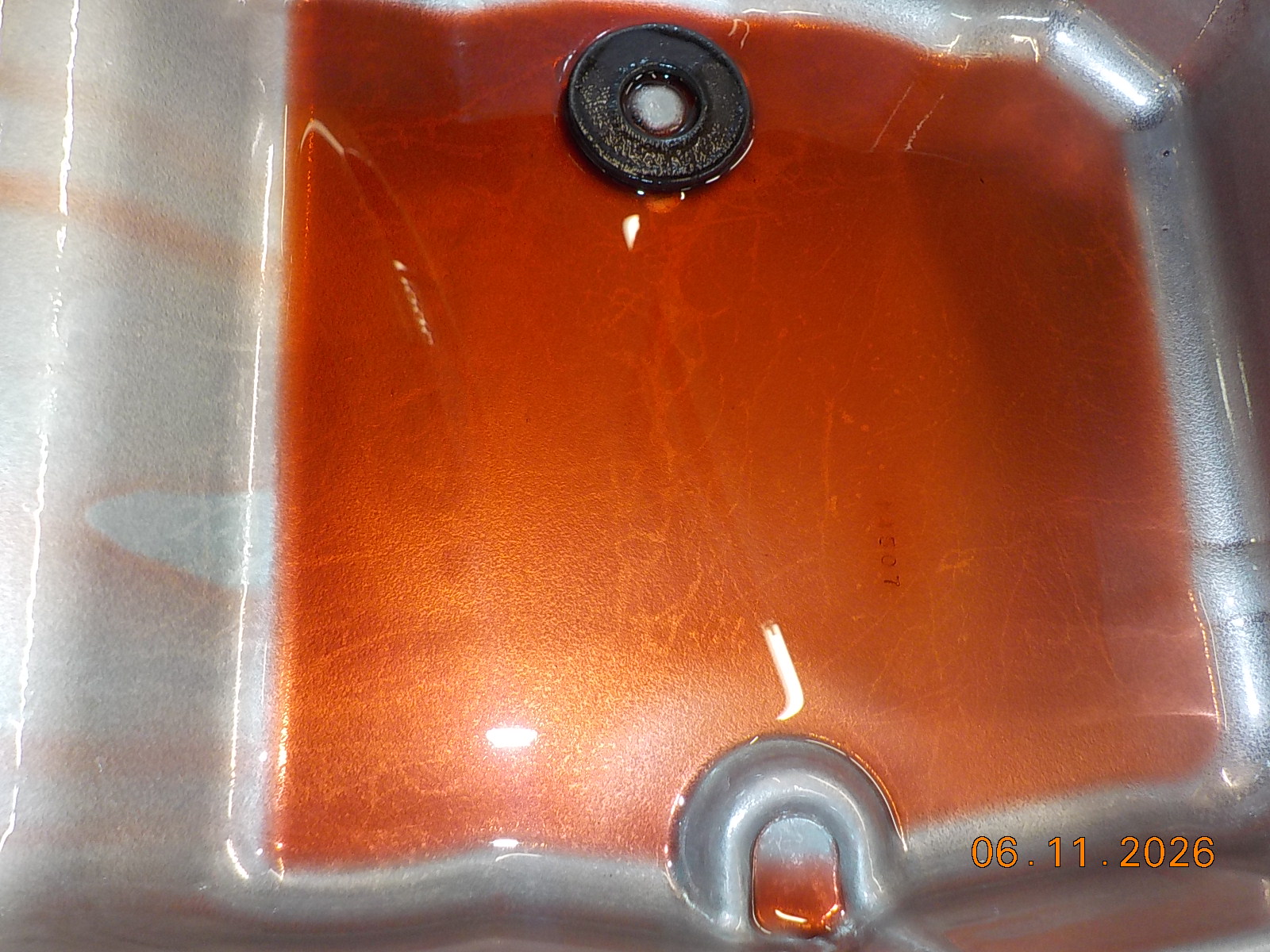

For filter & fluid change. Its been 4+ yrs and 43k miles since filter was replaced. I've done 2 dump and fills (5 qts ea time) since 2022.
Pan/magnet were almost clean and fluid looked fine.
Going back in w/Dexron6 and #24236933 filter & seal, and I'll send an atf sample off for analysis.

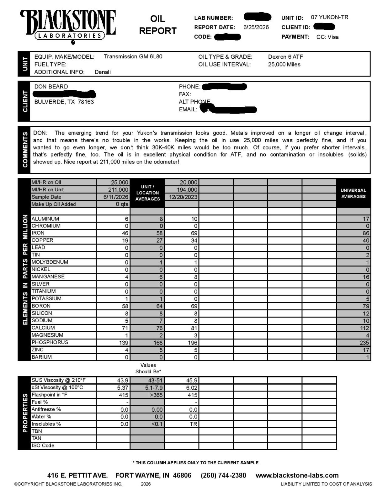

Received atf test result from the lab. As I expected ALL IS GOOD:
