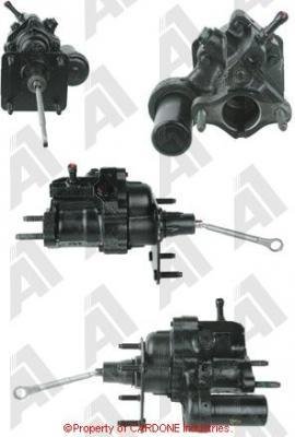

Hydroboost replaces the vacuum booster with a hydralic booster that runs off of the power steering hydralic circuit.
Yeah, sorry. Forgot to mention the hydraulic booster. You wouldn't get anywhere with just a master cylinder. lol
Hydraulic Power Brake Booster from Rockauto.com $173.79:
