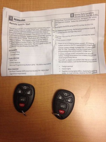

The part you are looking for is Discounted. Have done massive amount of research on this.
Main thing you need is the part number listed and RPO code AP8 (Remote Start Prep Package) funny thing is the car has all the needed part for the auto start to work but it is turned off at the BCM. You can see if you have the code by looking in the glove box or have someone run your vin (PM me)
There is 2 part numbers 22951516 - is the correct one for most to all SSV and PPV. 22970856/19154445 is the wrong one UNLESS you have the power lift gate (was told by couple tech it will not work without the lift gate option on the car from the factory)
The OE part will cost between 190 - 250 dollars for the part not including Shipping/tax. Here is what you get 2 remotes and 2 pieces of paper (see photo) on the paper is a Code (Removed mine). You take all the items to your local dealer they will take the code from the paper call GM they give them another code and punch it in to there GM scan tool and like a light switch you have auto start.
Now for the bad news the part is Discounted. Here is the solution there is 2 ways to go:
1. Ebay/online here is what is bad about this unless the item you bought it still sealed you have no idea if the code was used.
2. Little more tricky you can go to your local dealer and have them A. Try and find the part and ship the part to there location from another dealer (at a up-cost). B. Or if your friends with the local parts counter man or your Service Writer you can ask them to print or write down the dealers and phone numbers where the part is in stock. Word of advice make sure you it is the correct part number easy mix up for some parts counterman.
At the end of all this you have the RPO code you found the part and paid for it and went to your local dealer you still get charged for them "Install" said part usually cost between .25 to 1.0 hours. Hope this helped it was a fun spending 3 month journey figuring all this out. PM me if you have any questions. Soon will make a thread on all the work I put in to my 2013 SSV
