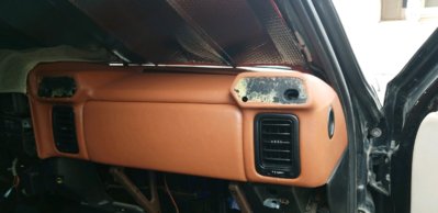

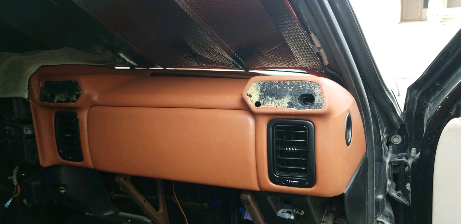

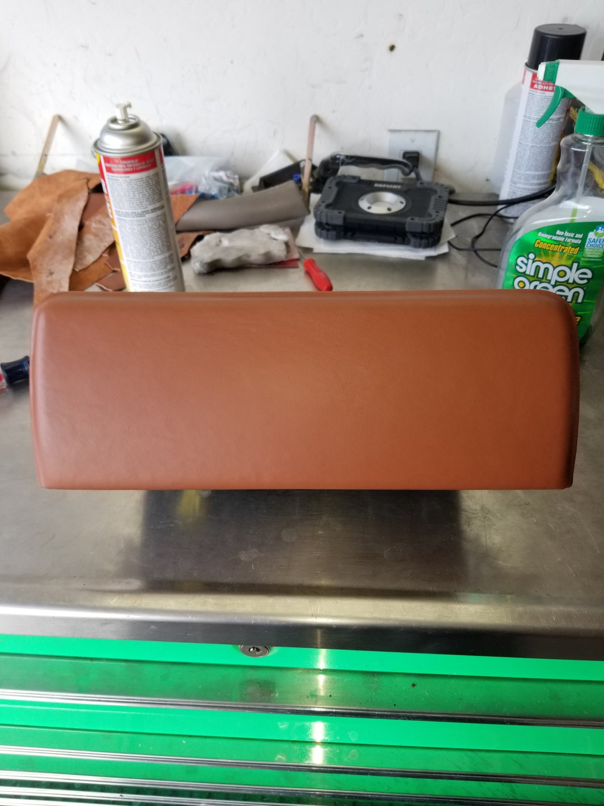

I went ahead and wrapped the air bag myself since it was a small easy piece. Cane out real nice.

Yesterday afternoon I installed the dash vents and a few other little things. It's starting to look good. I hope the guy has my grab bar done. He said he'd have it done last night but I didn't hear from him. But I'd like to get it so I can put it in and have the dash at least complete.

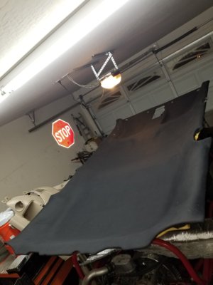

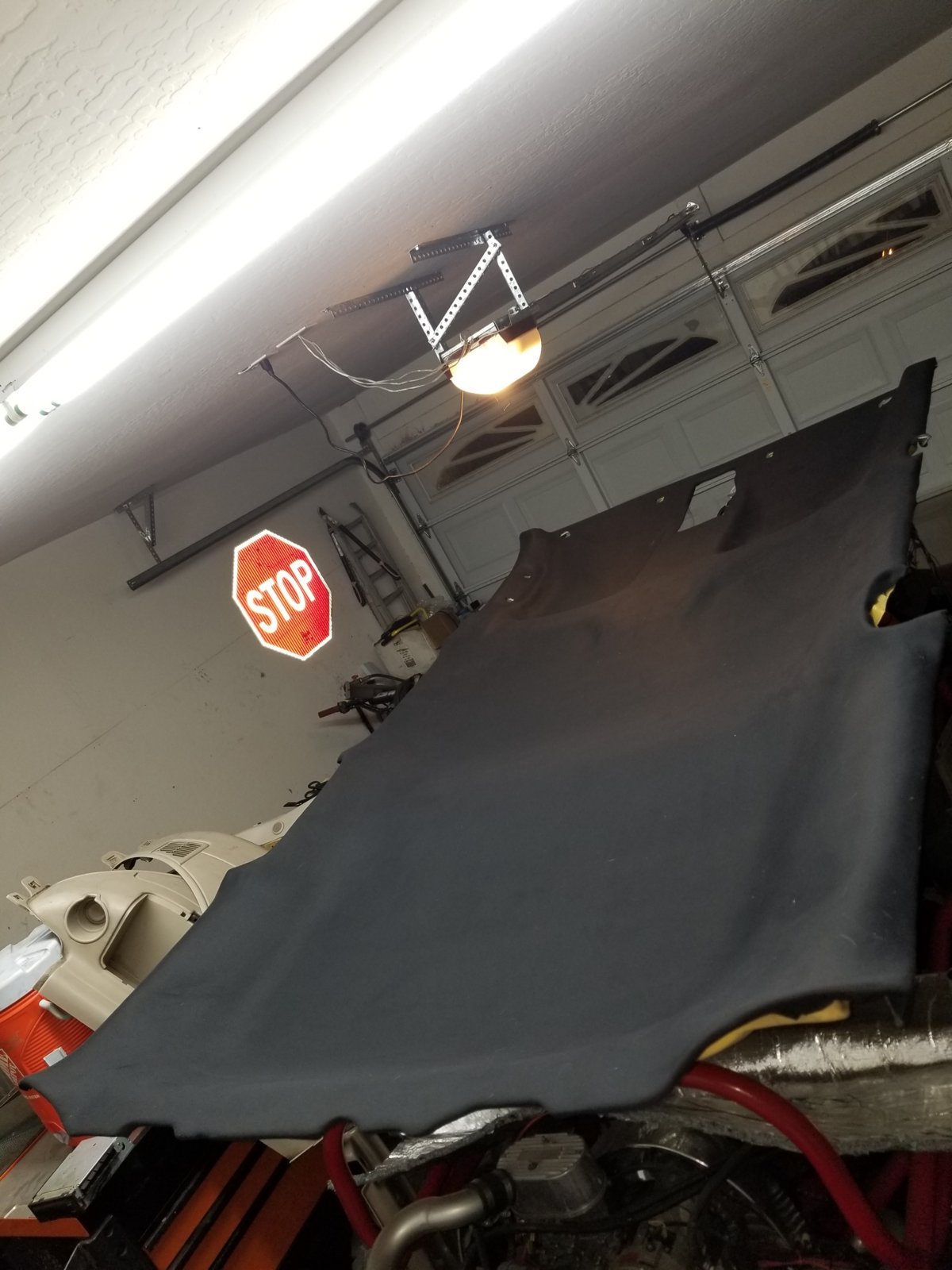

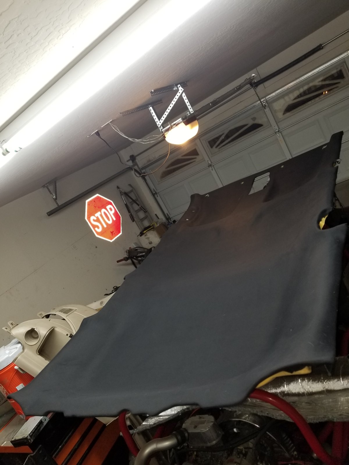

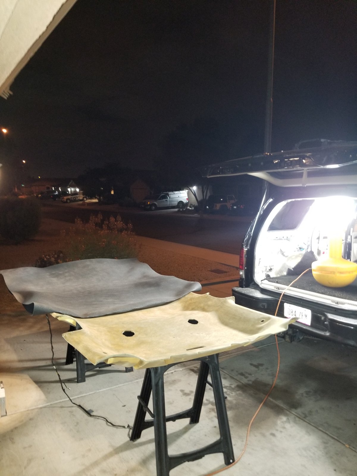

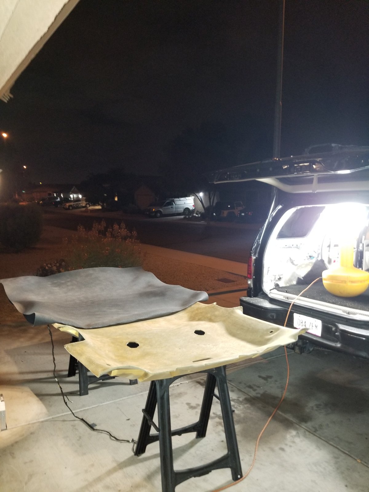

Forgot to take pictures before I started but i got the head liner done late last night. I ran out of glue at like 10:50 and had to run to walmart and pick up some locktite brand glue. Hope it holds. Says it's good for high heat and all kinds of stuff. It was the highest grade they had. The other option was Gorilla Glue spray adhesive but I've never heard anything about it yet.. and I'll be damned if that sucker didn't run out of glue on the front with maybe three foot left to go on a pretty technical part. I started to cut out some of the holes for the visors and air conditioning vents but gave up and went to bed because that stuff is actually a pain in the rear to cut even with a brand new razor blade. I couldn't believe it myself I even swapped blades cuz I thought I had a double one. Hopefully tonight I can put it in and wire it up tomorrow.
View attachment 203049 View attachment 203050
Headliners are a pita, especially if you don't have help.
You are absolutely right! I definitely could have used help. Said I had to walk side to side a thousand times in a hurry to because it's so hot here the glue dries right away. It came out pretty good there's one spot in the back that has like a one each stress mark wages from it drying in I tried to pull it back and it would not because it was already stuck lol. I'll have to take a closer look at it when I get home from work today because it was too late and dark last night to go over it closely. What sucks is I almost went to the upholstery store Friday late afternoon before it closed to get another gallon of the good weldwood dap glue. But figured I have enough. I also wrapped it around the edge in enter so all the way around where I could that way it can't fall down. I have done a few of them before but in regular cab pickup trucks that's a big difference LOL that's a monster ass headliner once you have it out and in front of you. It took me probably a few hours I would say just to prep it and that's what using a air tool with a wire cone on it.
I've done a few, and the longer they are, the more of a pita they are. Did you spray both sides with the glue? I'd let it cure for a day or 2, just to make sure. I've reglued a few edges that seemed fine, but eventually would fall because of the sun heating it up.

Oh yeah it's got a good amount of glue on it! I sprayed the shit out of it top and bottom some parts of few times even because it was drying too quickly. It's so hot out that it almost dries instantly sucks

It is actual headliner material from a upholstery supply store here in town . Has 1/8 foam on the bottom. When I went to cut the holes out I noticed that there's a plastic layer in between the material and foam also. Makes it a pain in the rear to cut.

No problem. Its 60" wide I think 4 yards. Can't remember. I used a wire cone to clean off the old foam. It's not to hard just laid out and make sure you have it centered good enough to fit and fold it in half then you glue both sides start from the middle and work your way to the back or front whichever one you want to go first but just make sure there's no tension you kind of just sit there and rub your hand flat and make sure there's no wrinkles I wrap my mind around the edges and inch that way it can't fall down like the factory ones if it does ever fall back down. Good luck man you have any questions just holler at me.
