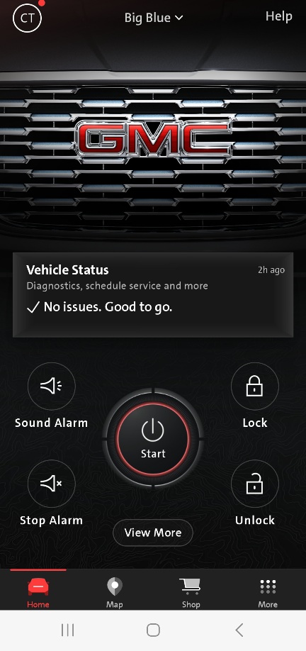

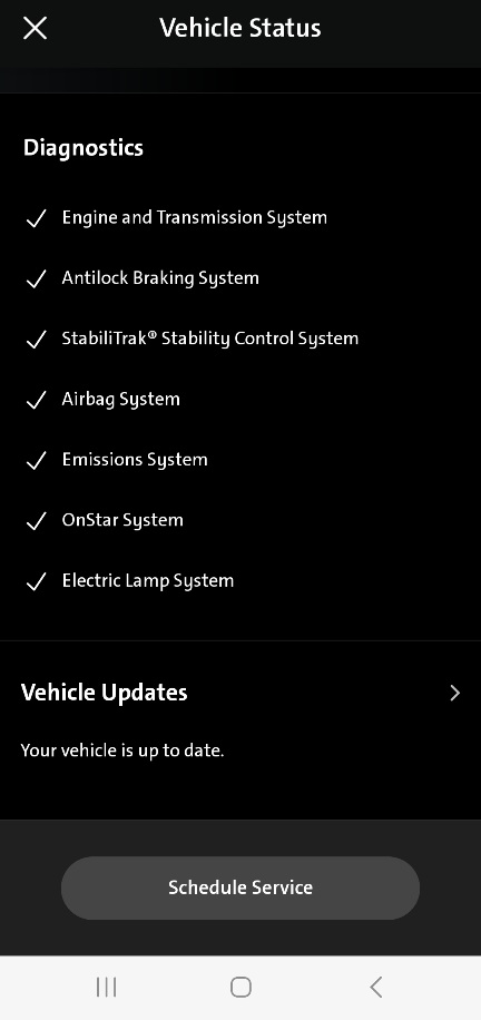

Maybe hit the onstar button and ask for a remote diagnostic? Check the vehicle status on your MyGMC app. Both of these will let you know what codes are posted.

Even with rig running app doesn't show. Here is the onstar diagnosis. Waiting on dealer to get back with me still (shocker... I know ....)
