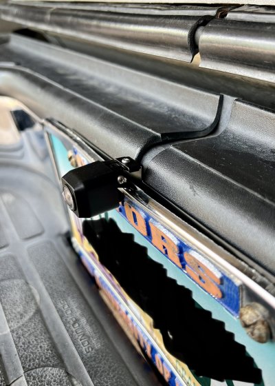

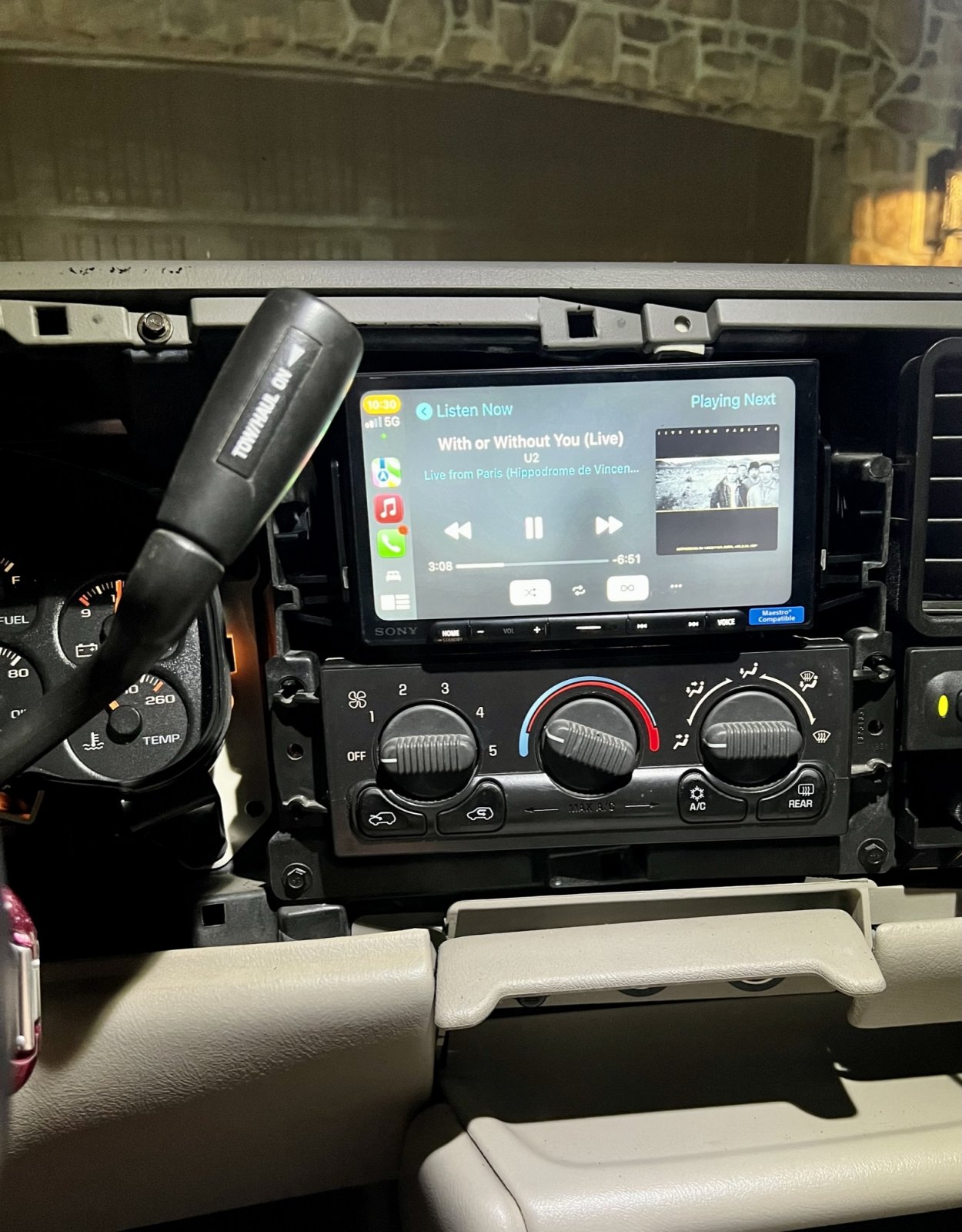

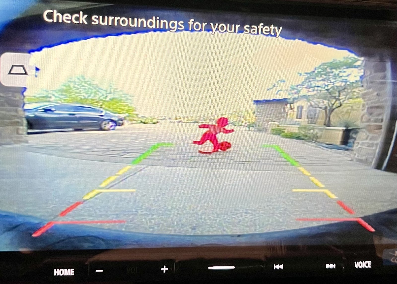

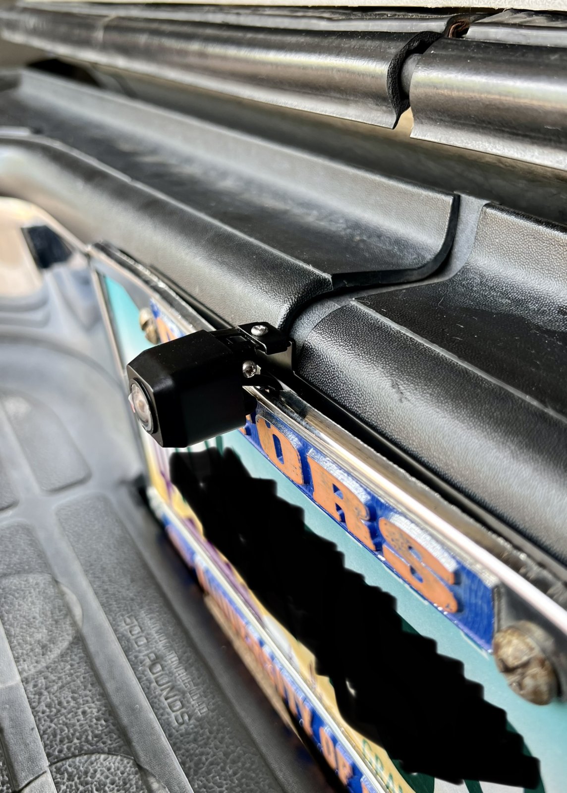

I just installed a Sony XAV 6000 with an AudioVoxx backup camera, and new speakers all the way around. It’s great. The short depth of the double-DIN head unit does not require hacksaw-removal of the support bracket. Ran camera wires in thru driver side brake light, then past subwoofer and along door-floor boards. Head unit requires the Metra dash panel replacement. I’ll get a full post up shortly but wow, I now have Apple CarPlay and backup camera in 22 year old SUV!

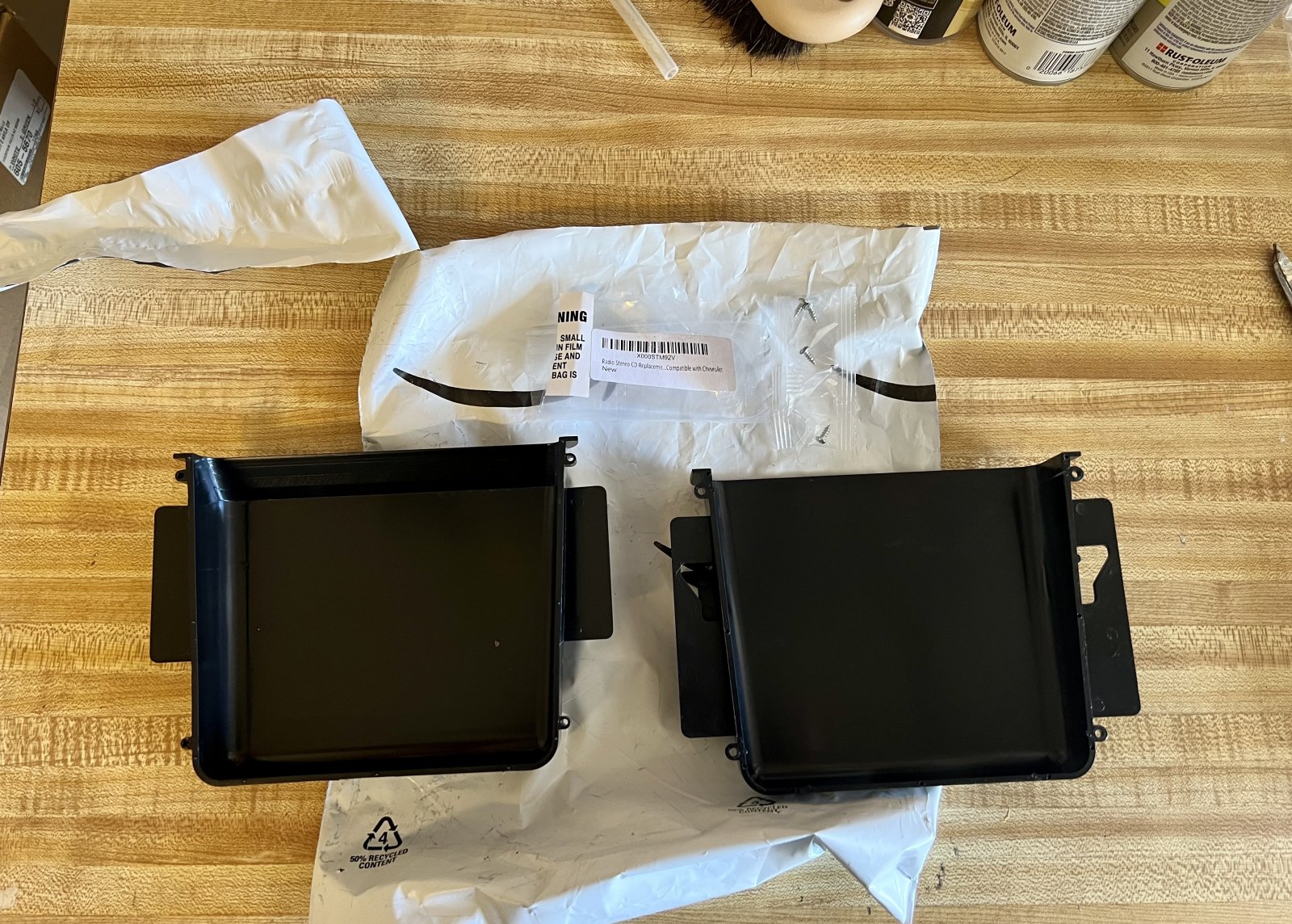

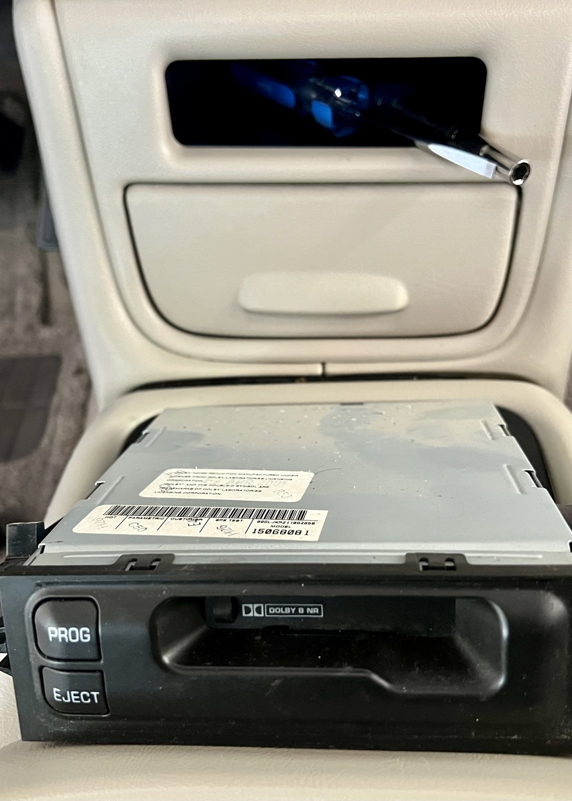

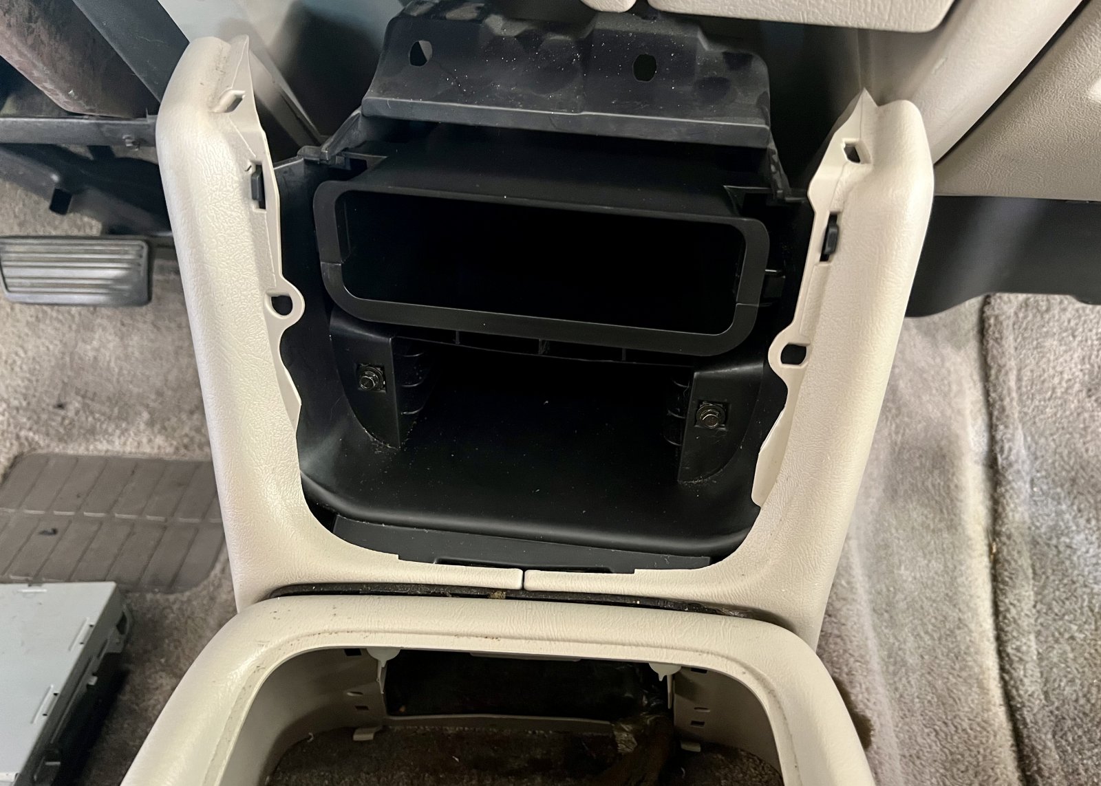

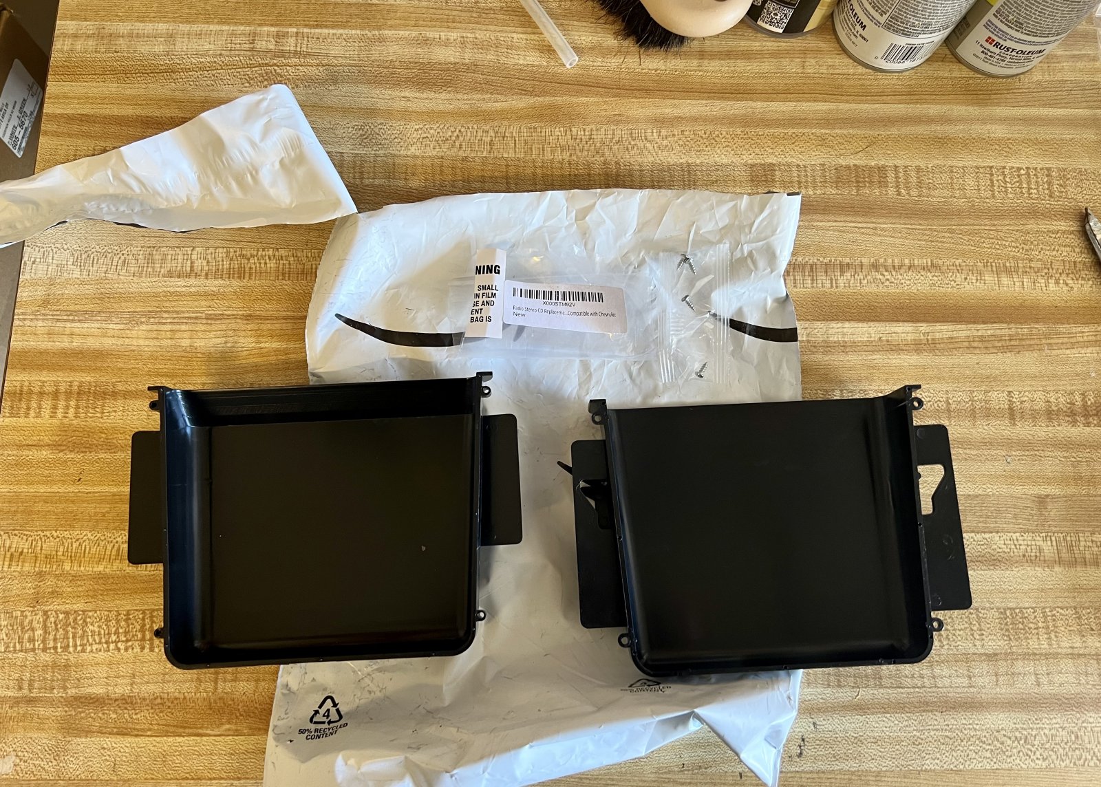

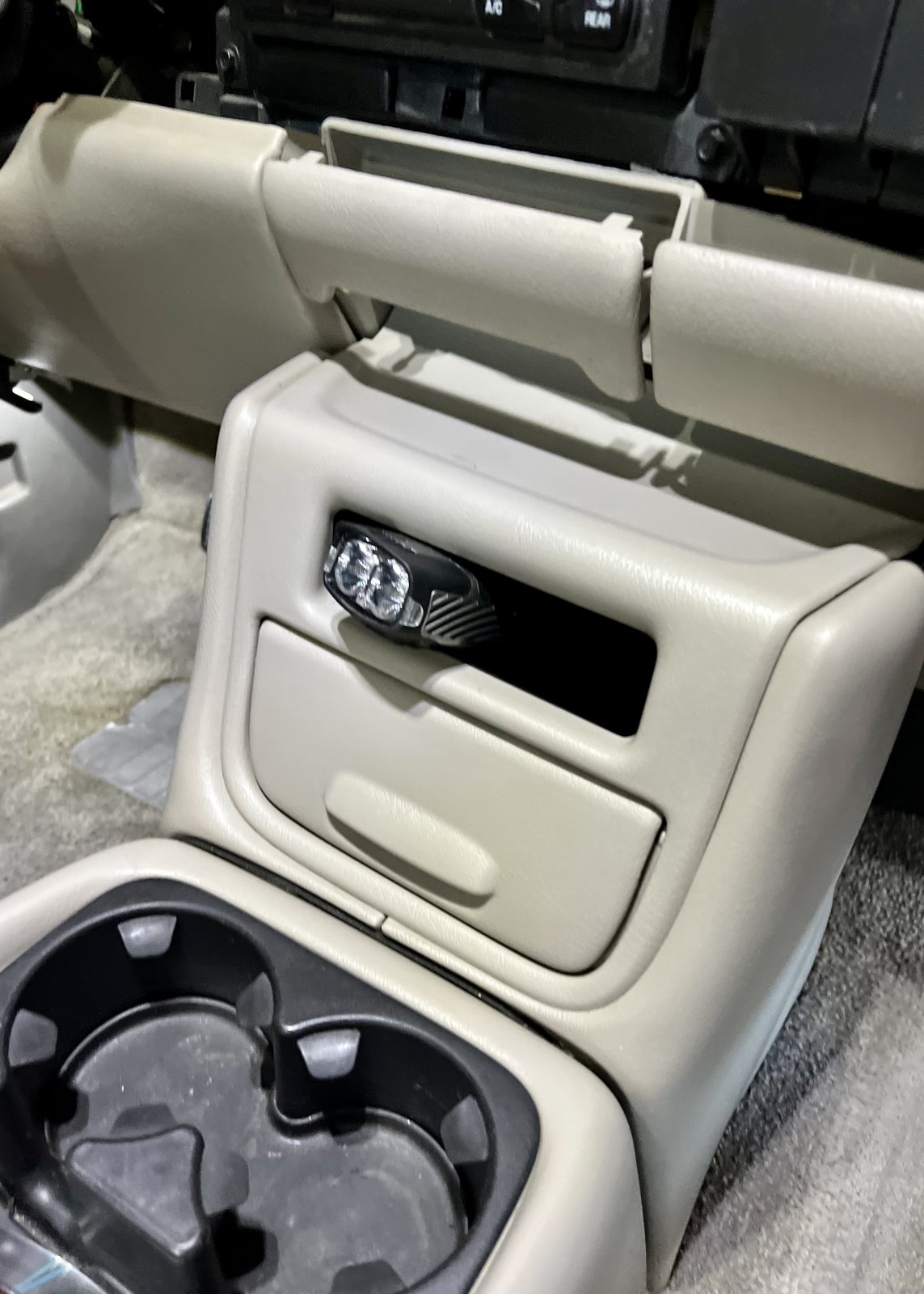

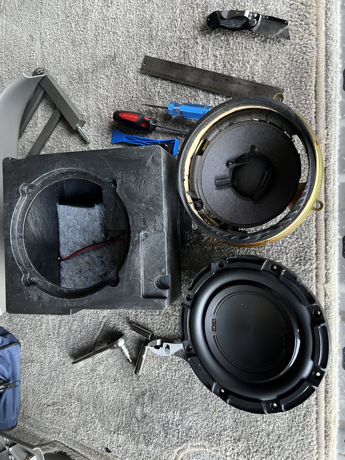

Plus navigation with real-time traffic. And so much better sonics than FM radio, and no hassle with CDs. Replacing all the speakers was pretty easy. I used Memphis Audo PR275's in the rear pillar, Polk 6.5" Coaxials in the rear door, Genuine GM in front door (woofers only, like the snap in mounting, kept the original tweeters for now) and a Polk Single Voice Coil 4 Ohm 8" subwoofer. Subwoofer outer diameter was just a little too big. I had to mask the polypro cone and carefully grind about 1mm of the aluminum frame from the OD. Only took a few minutes on a Craftsman wheel grinder. I did not want to cut into the nice subwoofer box that is standard on the GMT 800 with factory sub / without Bose. Niftiest upgrade with removing the cassette player in the center console and replacing with a cubby compartment that holds a phone, sunglasses or wallet securely.

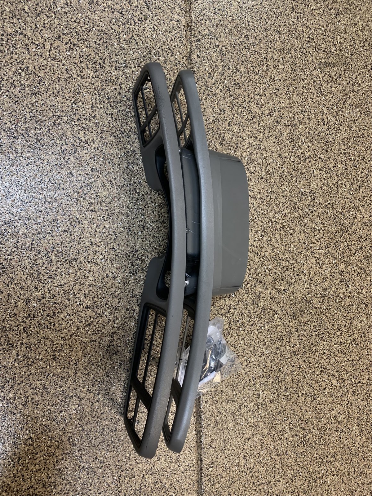

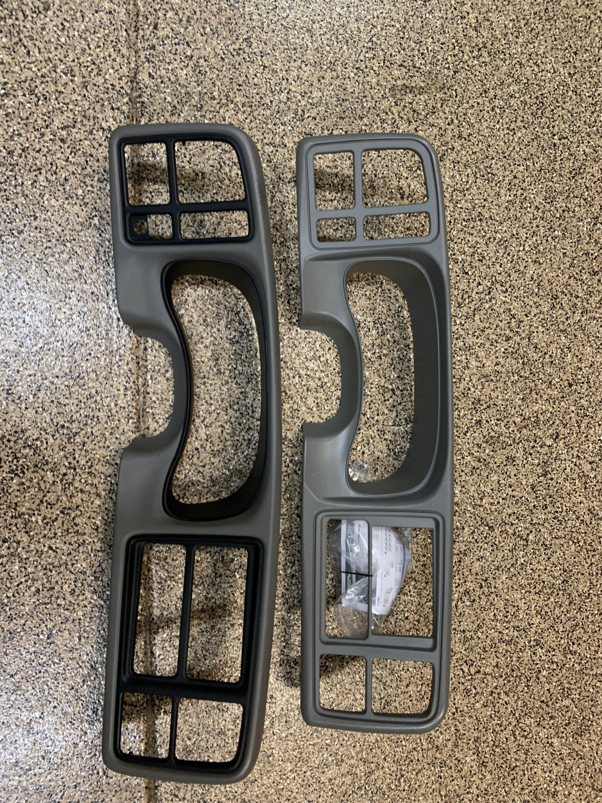

I don’t think you need a dash trim panel. I’m not certain but I think the ‘99-02 (like mine) needs the Double-DIN trim adapter for about $130, from Metra. Pics below, they don’t look the same size but they are. OEM is nicer, two tone and heavier. I think the ‘03 came stock with Double-DIN and your trim panel will work fine. CRUTCHFIELD is a great resource for fit and installation information. Well worth the 2 days shipping and prices are very competitive, in my opinion. A new double-DIN head unit will cost $200-600. You will absolutely need the wiring harness adapter. On my Sony, I also had to wire in the included GPS antenna since Apple uses GPS to verify the car is stationary when synching each time it starts up, at least on my Sony. My recommendation is stay away from CD player, just stream off your phone. I love my CDs at home but they are a hassle in the car and I’m spoiled by using Siri voice to change music, apps, and volume. Finally, you almost certainly need to replace all your speakers. The OEM GM paper speakers are notorious for degrading after two decades. Mine were shot - zero foam surround remaining. But wow, the outcome was fantastic.

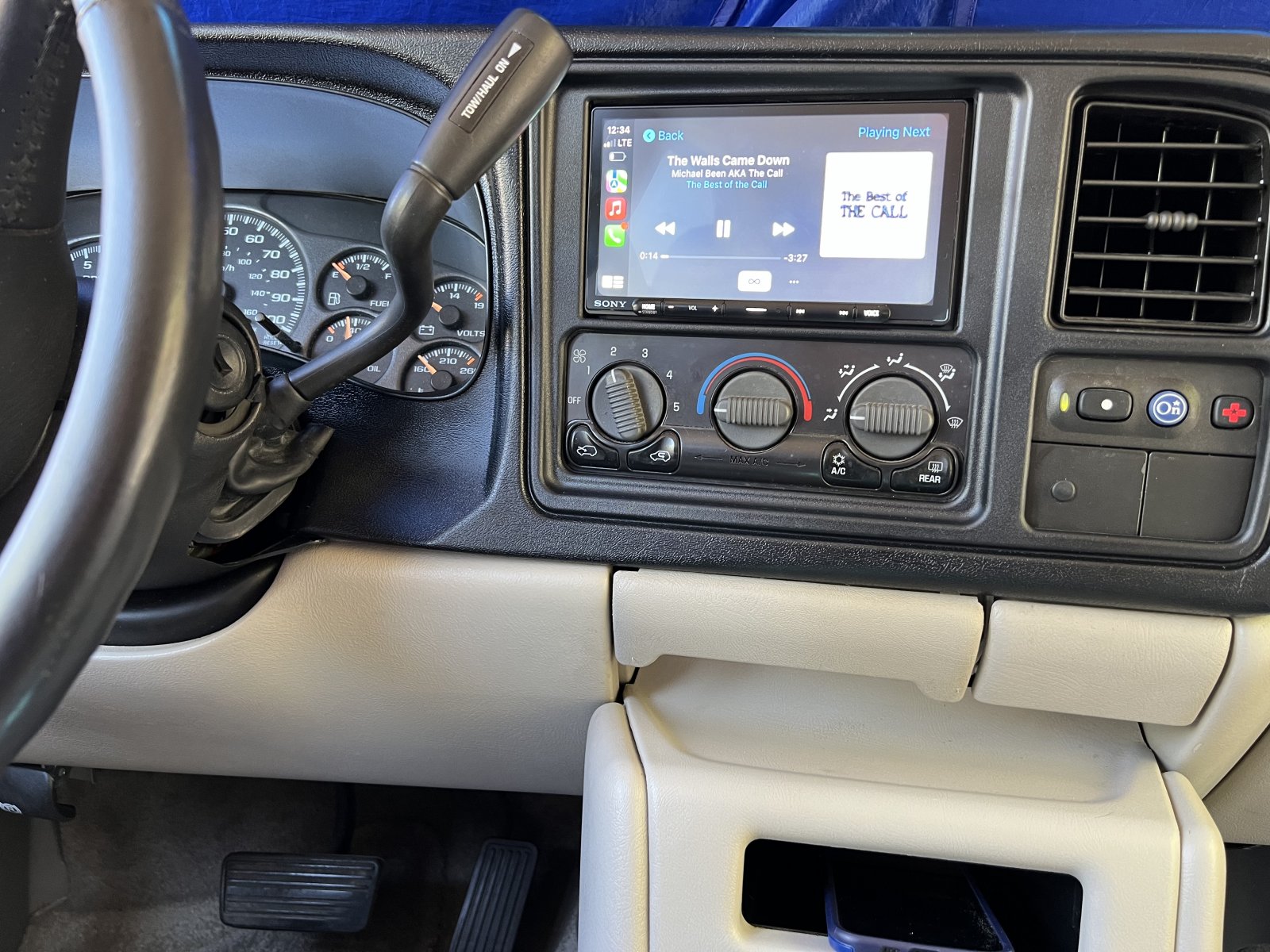

Finished outcome with the Metra panel is great. The fit is not perfect. The left side sits a little far away from the dash. But there are no rattles and it’s securely attached. I used black rather than pewter. It looks OEM and clean. Very happy, would buy again in a second.
By the way, I snapped in the OEM 1.5X DIN trim panel that was originally installed to see how it works with the Double-DIN upgrade and yes, you could make it work but it’s not just too narrow top to bottom, it is also too wide side to side. I can’t see spending $200-600 on a head unit and not going with the aftermarket trim panel.
