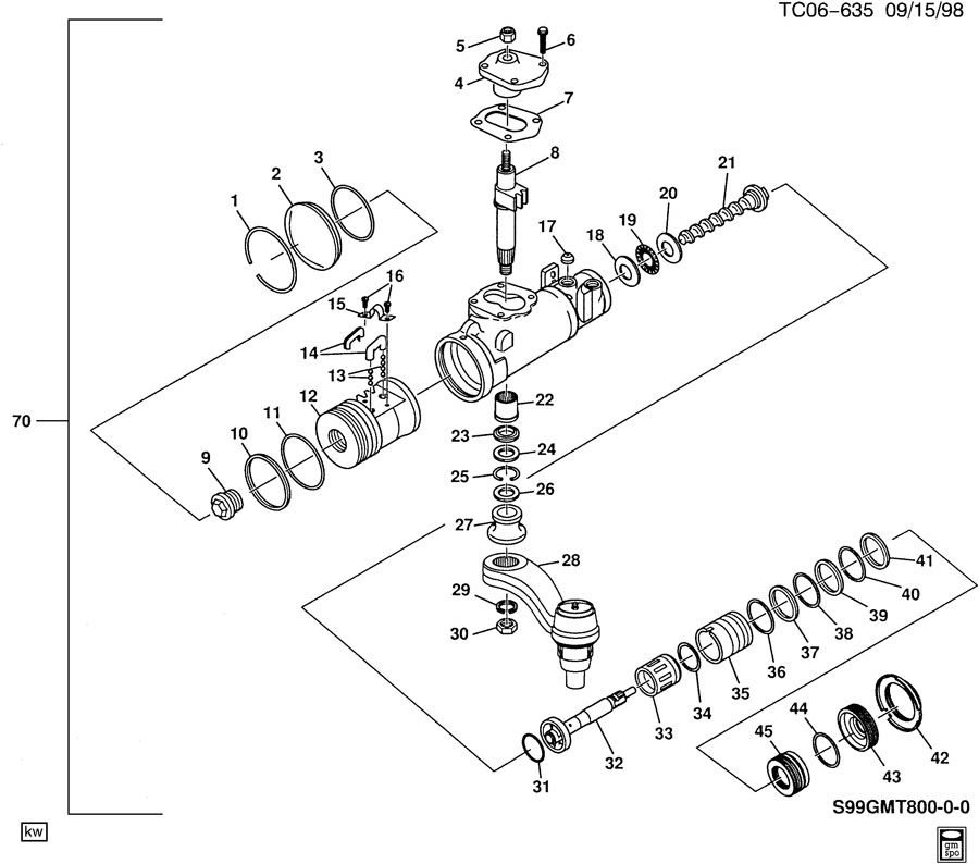

What would be fun to know is what the make, model, etc. of the gear box is. I think is a "Saginaw" box? I don't know a lot about these. I may buy a second one from the junkyard and rebuild it.
I think the fact I had to turn in the setscrew that much means the bearings are heavily worn.
Putting notes below...

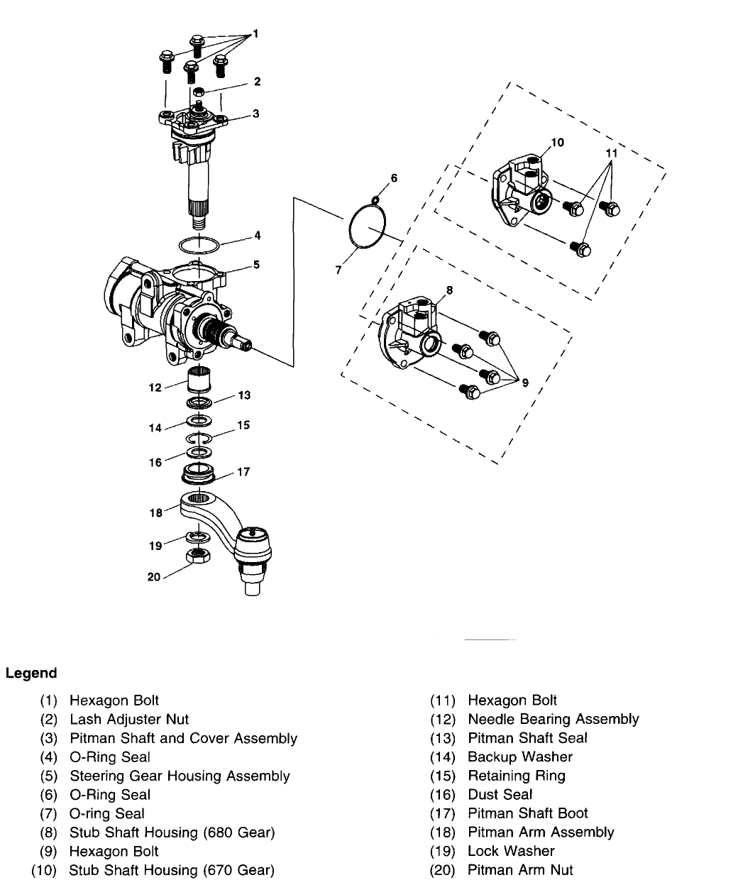

I watched this:
Here's a guy rebuilding a gearbox from 2003 Z71 tahoe:
This is where he talked about 3 ft lbs on the set screw.
Found this:
and this:

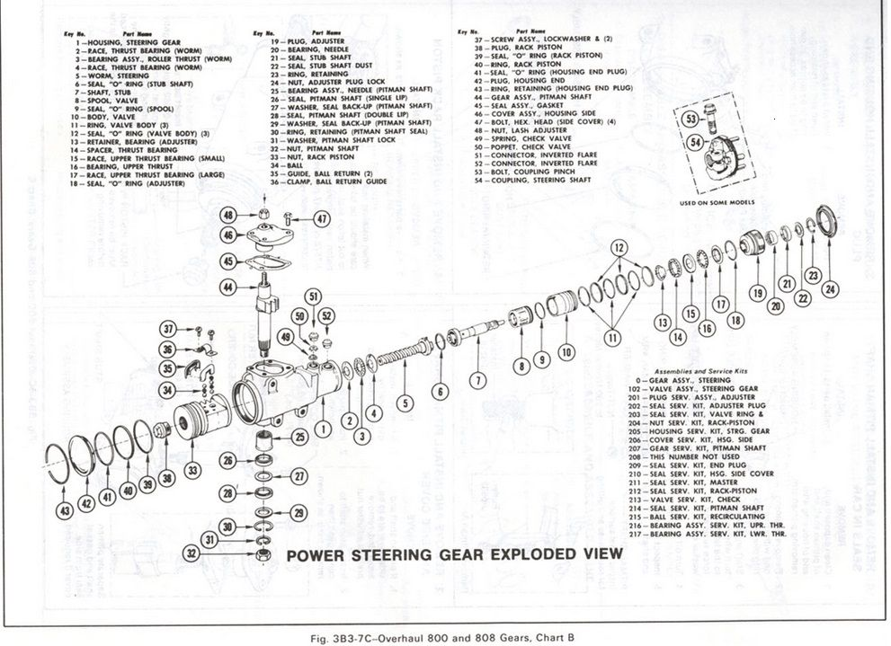

Guy in one of videos said rebuild procedure for older Saginaw box is in this book, although wouldn't be for my truck:
Exploded Diagram:
Adjusting procedure for Saginaw box:

Check above links, Look for Unit Repair Manual ST333 88 1998 may be close enough to be helpful.

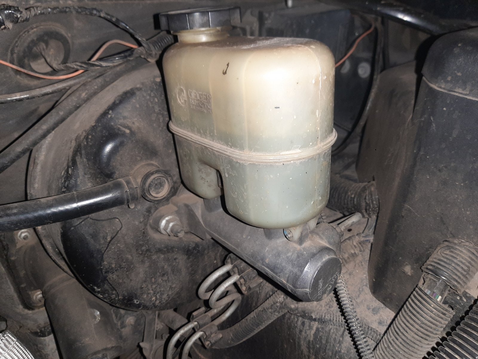

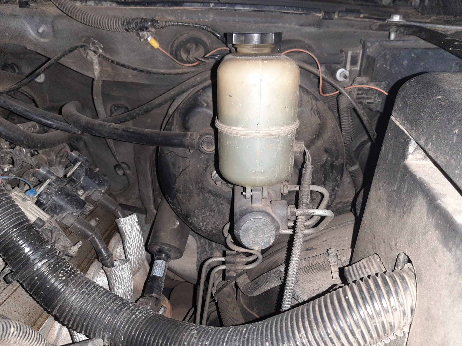

@Fless Pictures of master cylinder... Is that a hyrdroboost? Curious is it something would be good to upgrade to if not?
Moderator
16,282
33,657
People's Republic of Colorado
That's not hydroboost, it's a vacuum booster. There are some Youtubes on converting to Hydroboost, and doing that would take a different power steering pump along with the other hydroboost parts.
