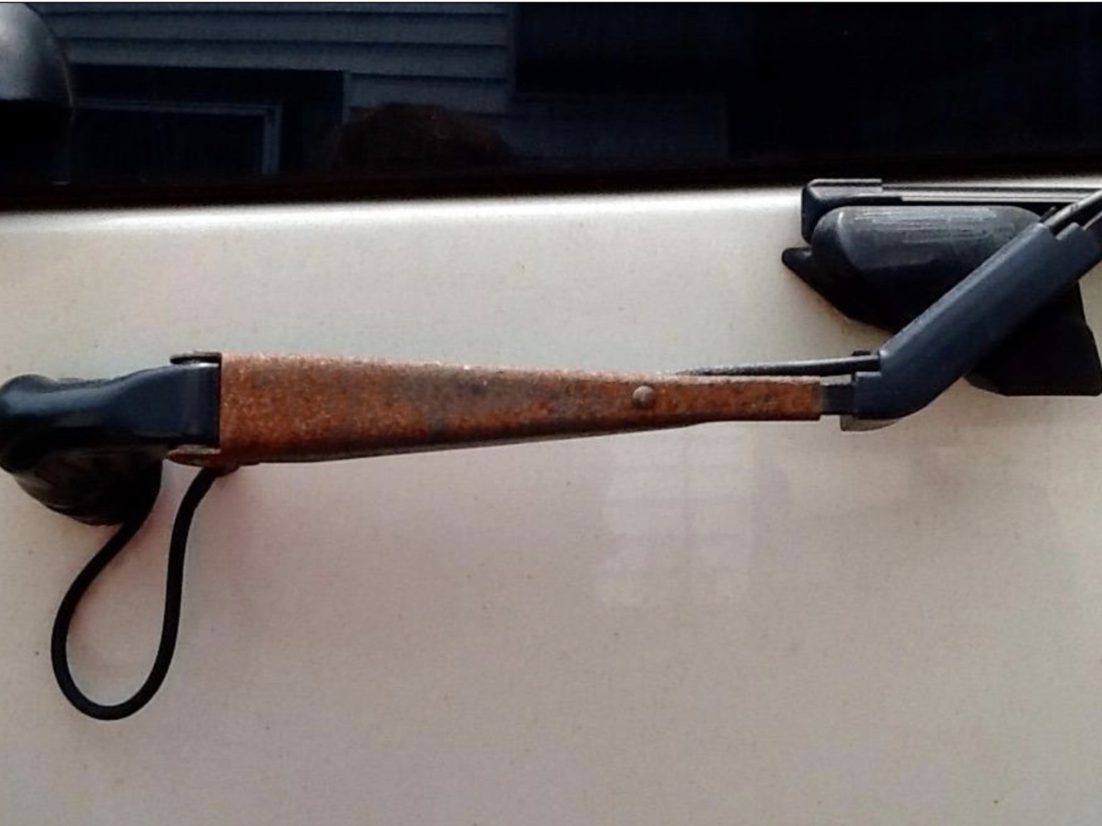

Sounds like a bent arm or a problem with the park on it. The bent arm could be the reason not all the blade hits the glass. If the arm is able to be pulled off and reinstalled at a different spline to allow for a full park, do that. May have been impacted with something at some time that bent the arm and damaged the park mode. May need to get a rear wiper transmission.
Here is the arm but no listing for rear transmission at RA: https://www.rockauto.com/en/moreinfo.php?pk=1027956&cc=1380372&jsn=900
Turns out the rear transmission is part of the rear wiper motor: https://www.rockauto.com/en/moreinfo.php?pk=338717&cc=1381047&jsn=866

As already advised above, pick up a new wiper arm and a new wiper blade from Rock Auto. This will give you a properly moving wiper arm with a fresh, strong spring to keep the blade on the window. This was one of the first items I replaced, when I purchased my new-to-me 07 Yukon.
Some folks, including me, had difficulty getting the old wiper arm off of the wiper motor spline. I had to use PB Blaster penetrating oil, plus a small pulley puller to get my old wiper arm off the spline.

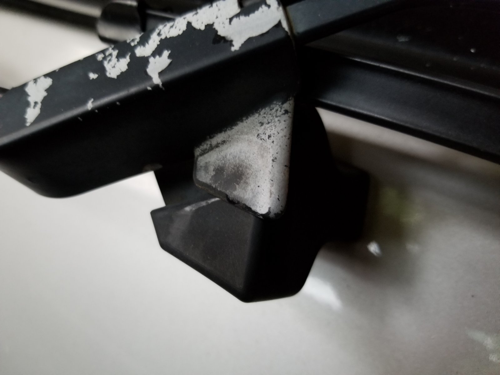

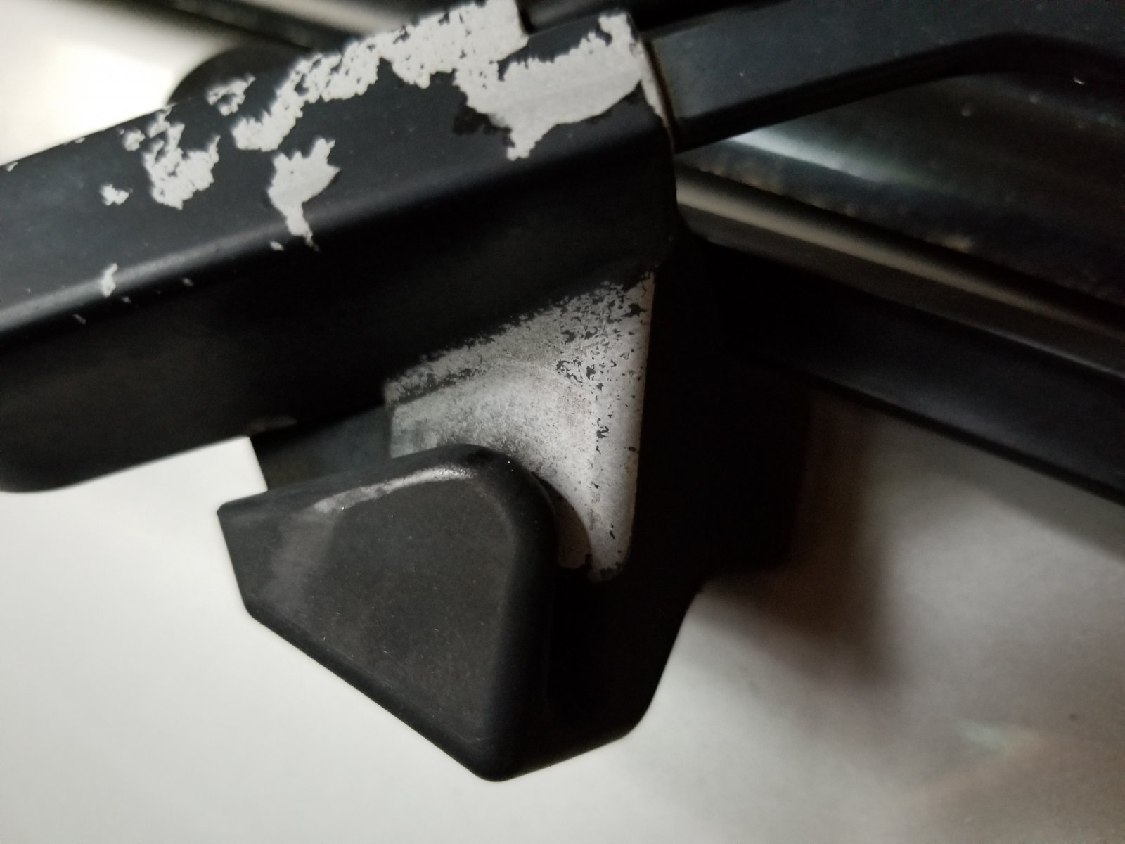

My best guess was the tab on the bottom of the arm that settles into the small holder when the wiper arm parks. You can see it out and in the holder and is the white looking tab. Should be black but that is on my list of things to update.
This is the holder that the rear arm tab settles in: https://www.rockauto.com/en/moreinfo.php?pk=3885897&cc=1431156&jsn=901
