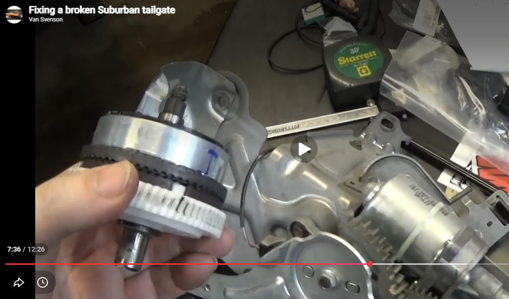

There is some clutch mechanism on the motor drive gear. Sounds like your motor is strong enough, but the clutch maybe slipping.
I haven't heard of anyone fixing one yet, but there's a screenshot from here..
In that video, the clutch wasn't his issue, so he doesn't dissasemble any further than this on the liftgate motor.
He also shows a clockspring in the video, but it sounds like it's a helper spring for opening the liftgate.

I'm thinking I may just need to buy another unit. I've seen that clutch for an exorbitant amount of money.
But it's weird, it's not encountering any obstacles, and it's on the way down. Hmmm, on second thought, maybe something is causing it to bind that I can't see. I'm going to dig into it at work on my lunch.
