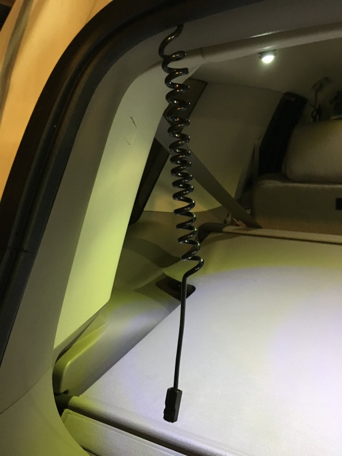

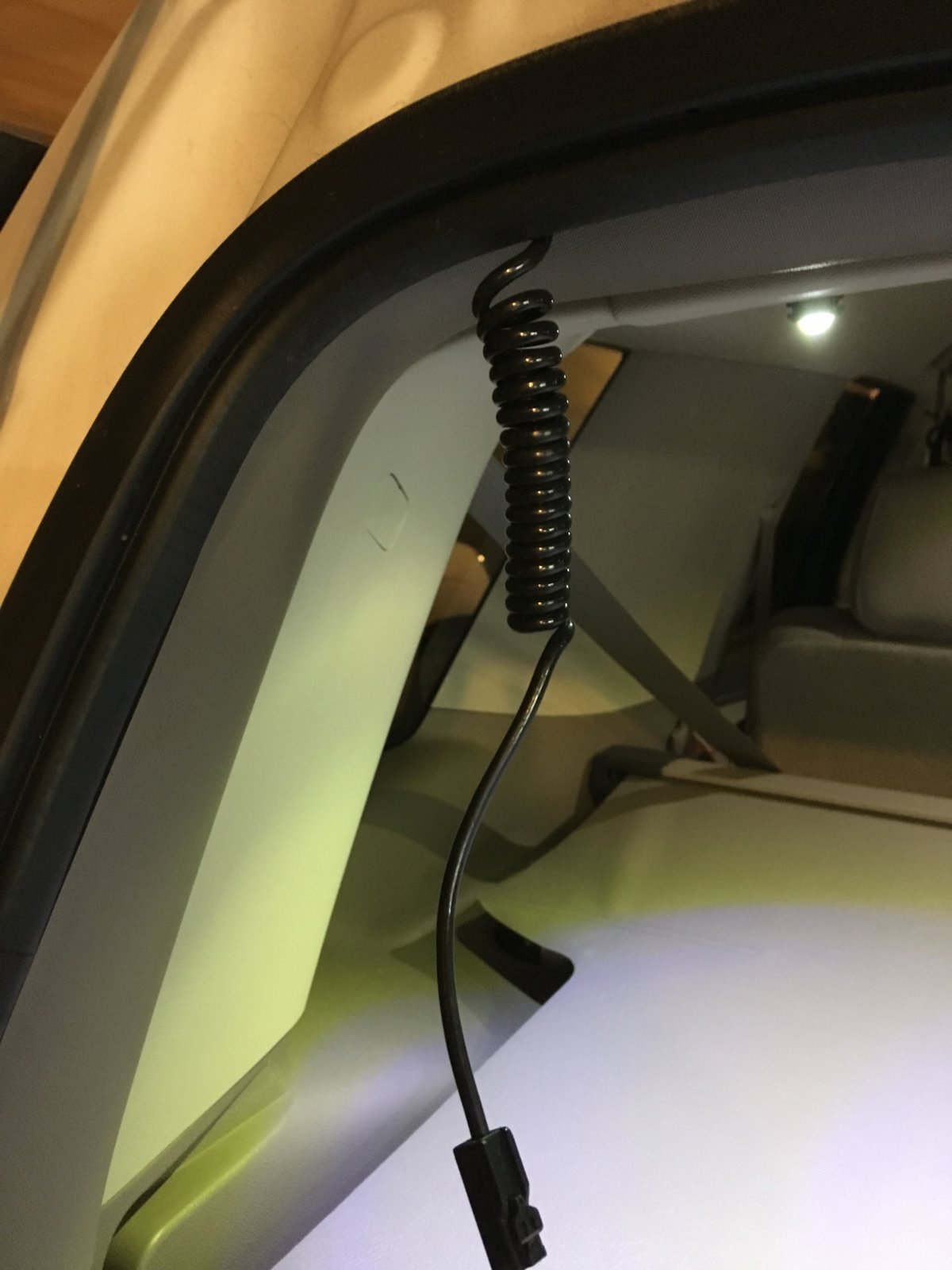

Before-
After-
Hey! I finally remembered to do it.
I took a heat gun to it (at about 350*-400*). Stretch the cable out, after disconnecting it from the window. With it stretched, applying heat, you can see the coils relax. Keep it stretched until it cools.

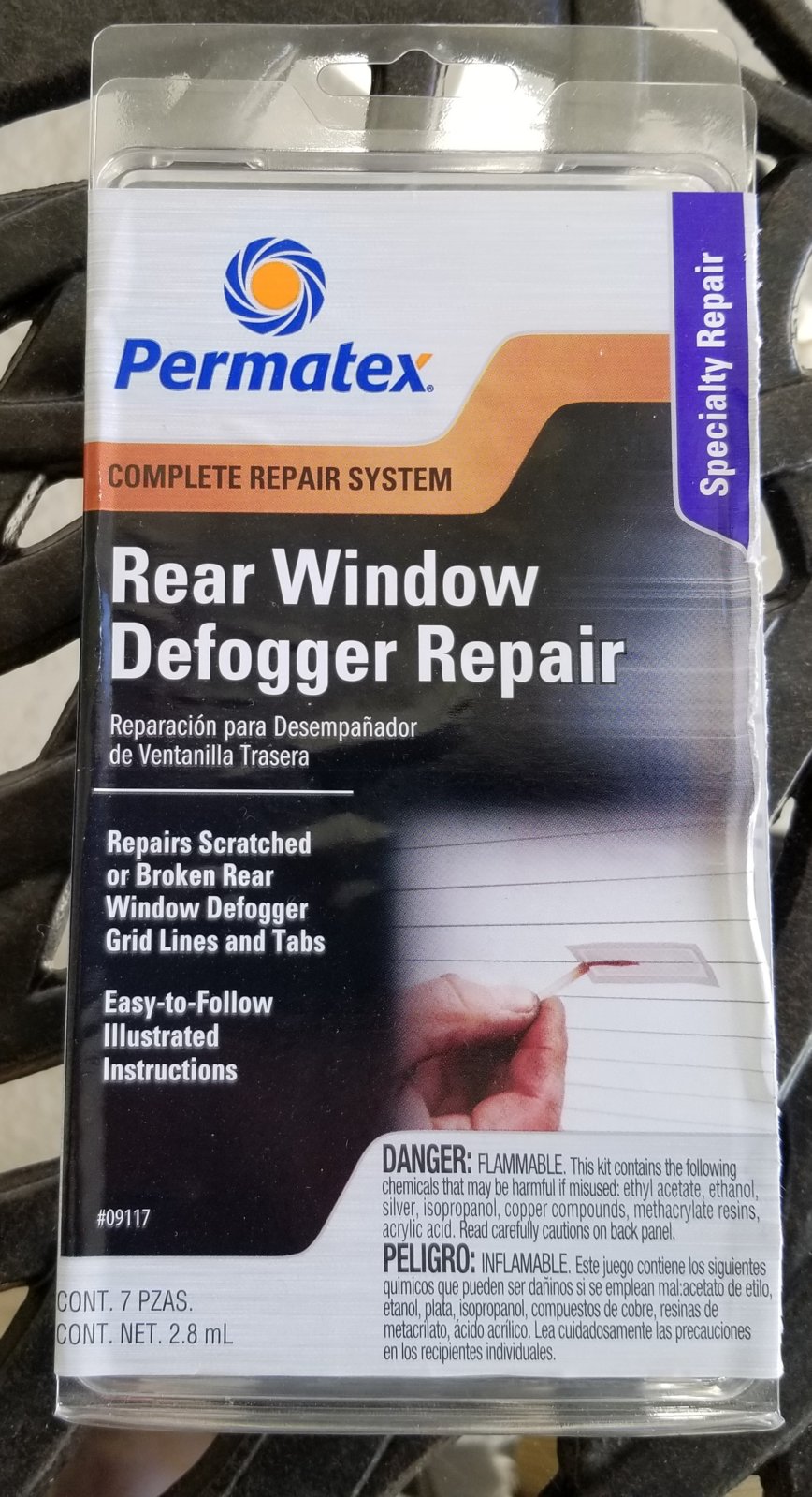

OK...I went with the Permatex product:
...cost about $15 at Advanced Auto...followed instructions...let it dry 24 hours...and hooked it back up. Works as advertised.
