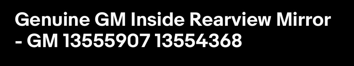

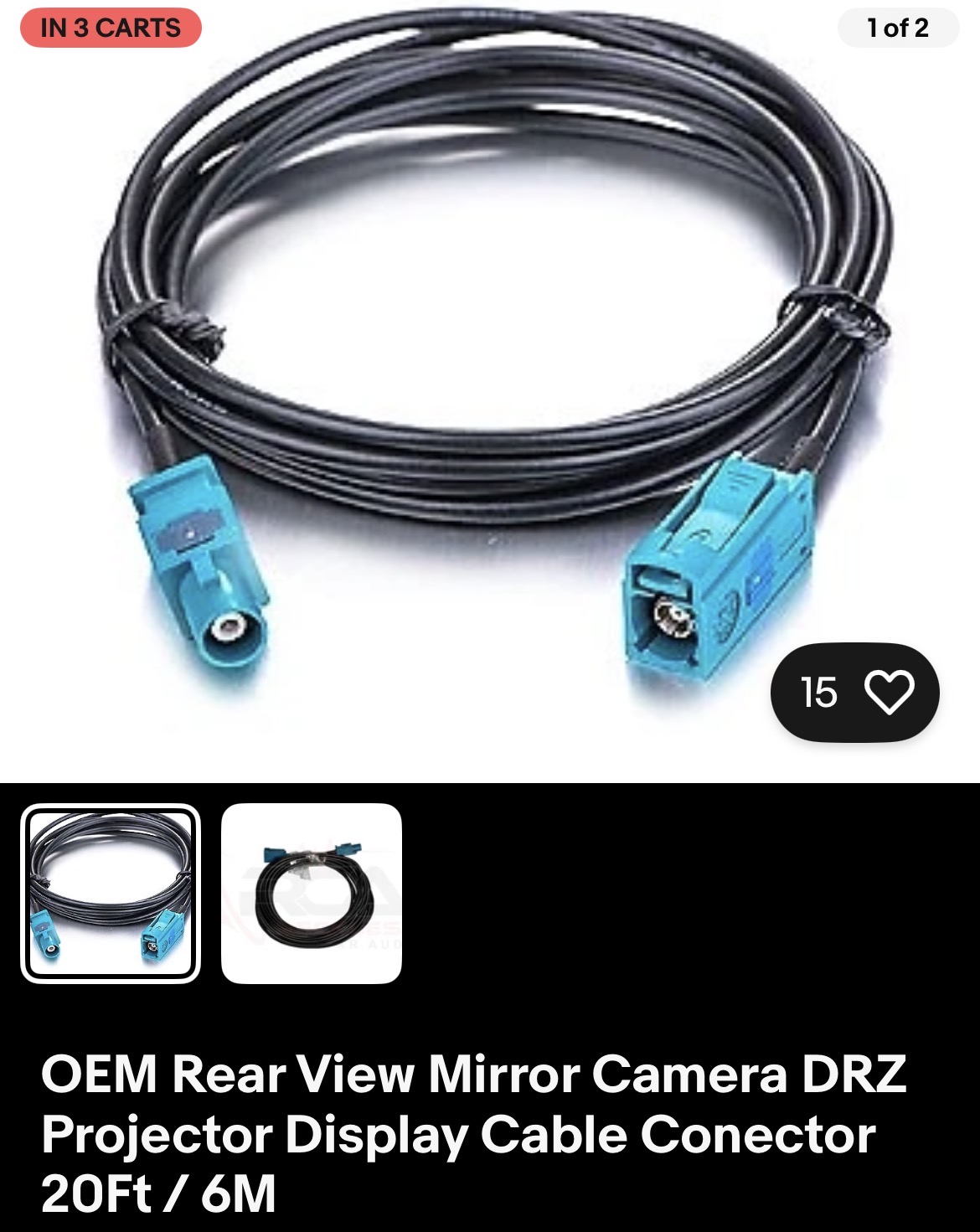

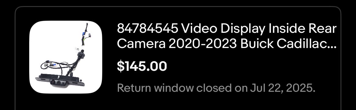

The cable went up in price, but maybe the part numbers will help you locate them on eBay. Those are the only 3 parts you need unless you want to use the lens cleaner spray option. You need to get a “y” adapter and hose that runs off the rear window washer hose. Hope that helps
