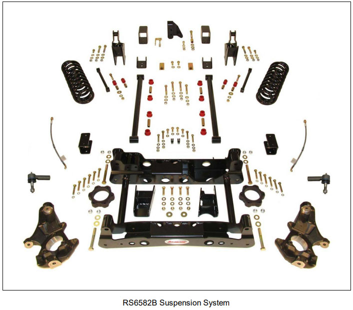

I have a discontinued Rancho 4 inch lift kit on mine it does not have spacers. My kit came with taller springs Rancho Part # 673B Coil Spring. Maybe you can get some from them... To run these springs you may need most of the parts on the upper half of this photo.
