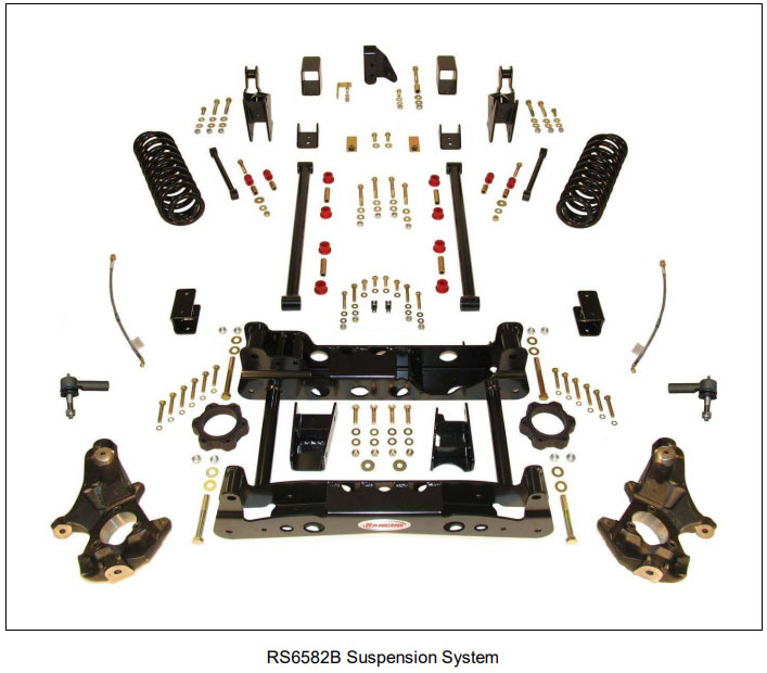

I have a discontinued Rancho 4 inch lift kit on mine it does not have spacers. My kit came with taller springs Rancho Part # 673B Coil Spring. Maybe you can get some from them... To run these springs you may need most of the parts on the upper half of this photo.
Thanks for the part number!
I sent Rancho a message and will see what they say.
