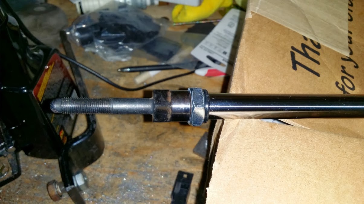

One challenge of the TS802's is that they come with a stud for the top mount and an eyelet for the bottom mount. The stud will not work on our NBS Tahoe's:
The fix to this is to order an extra pair of upper eyelet mounts and swap them on. This is incredibly easy to do yourself. Here's the "factory" stud end:
You loosen the lock nut:
Then you remove the stud:
Here are the stud and eyelet mounts next to each other:
Then you install the eyelet mount and tighten the lock nut:
