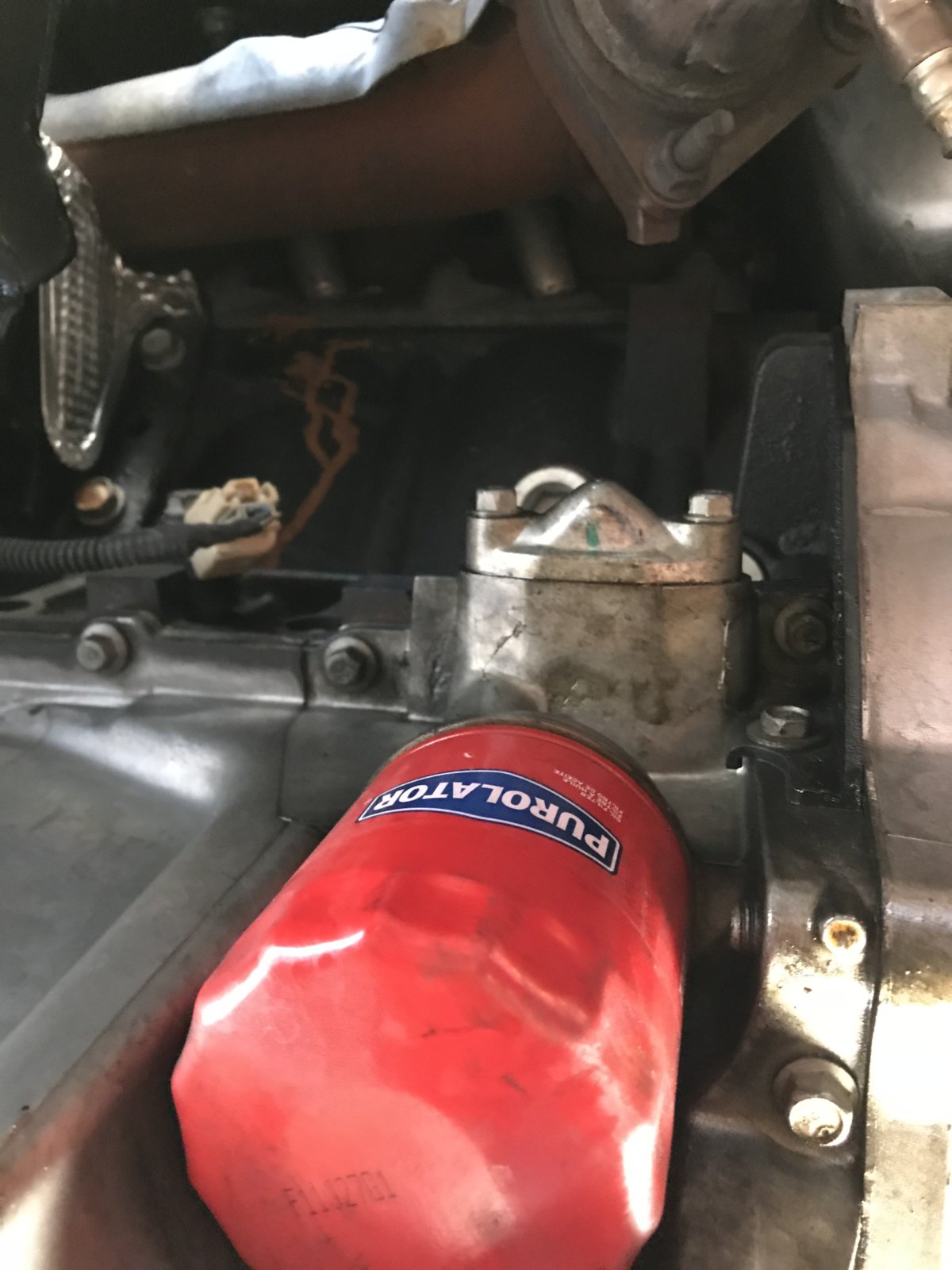

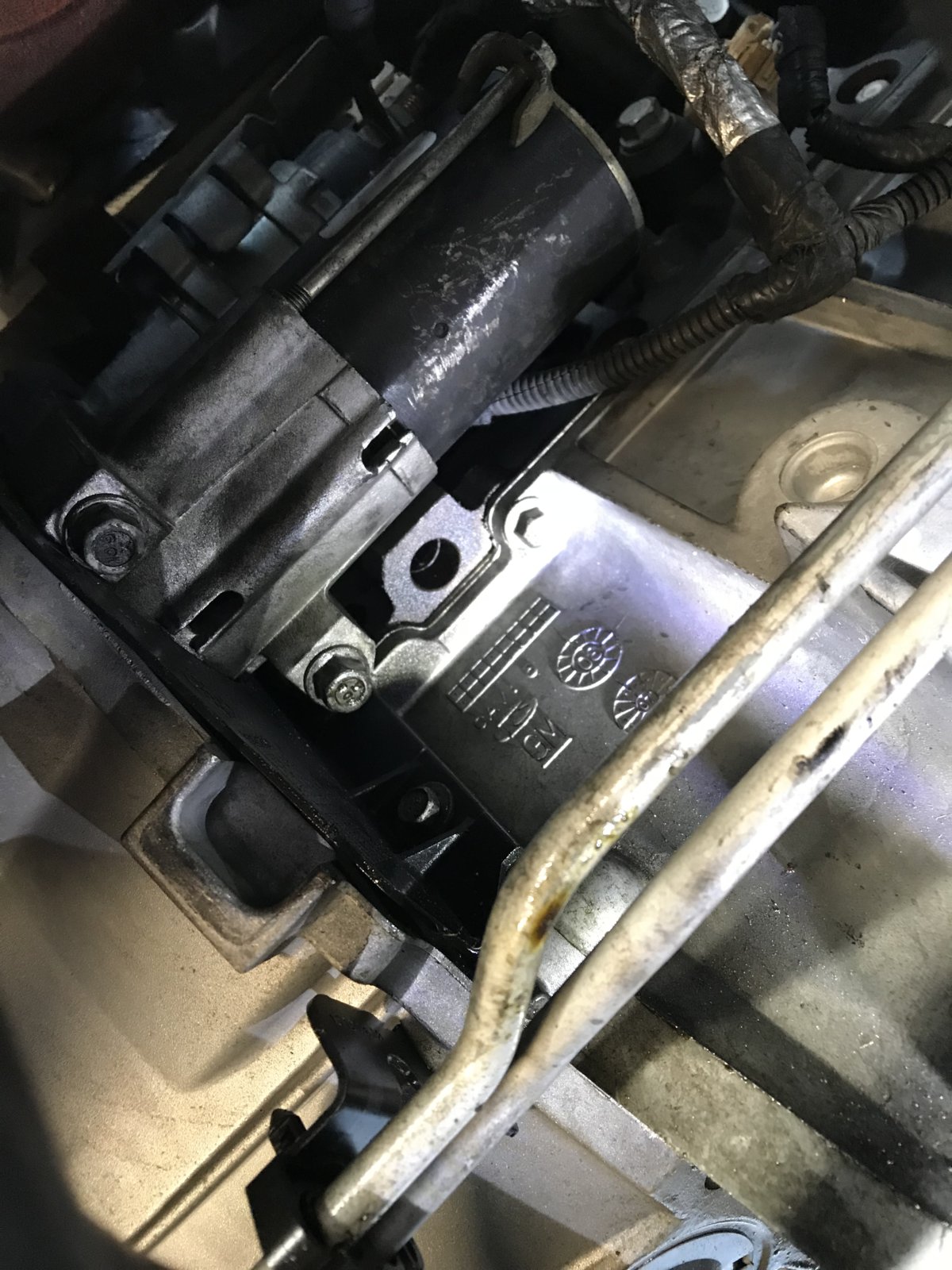

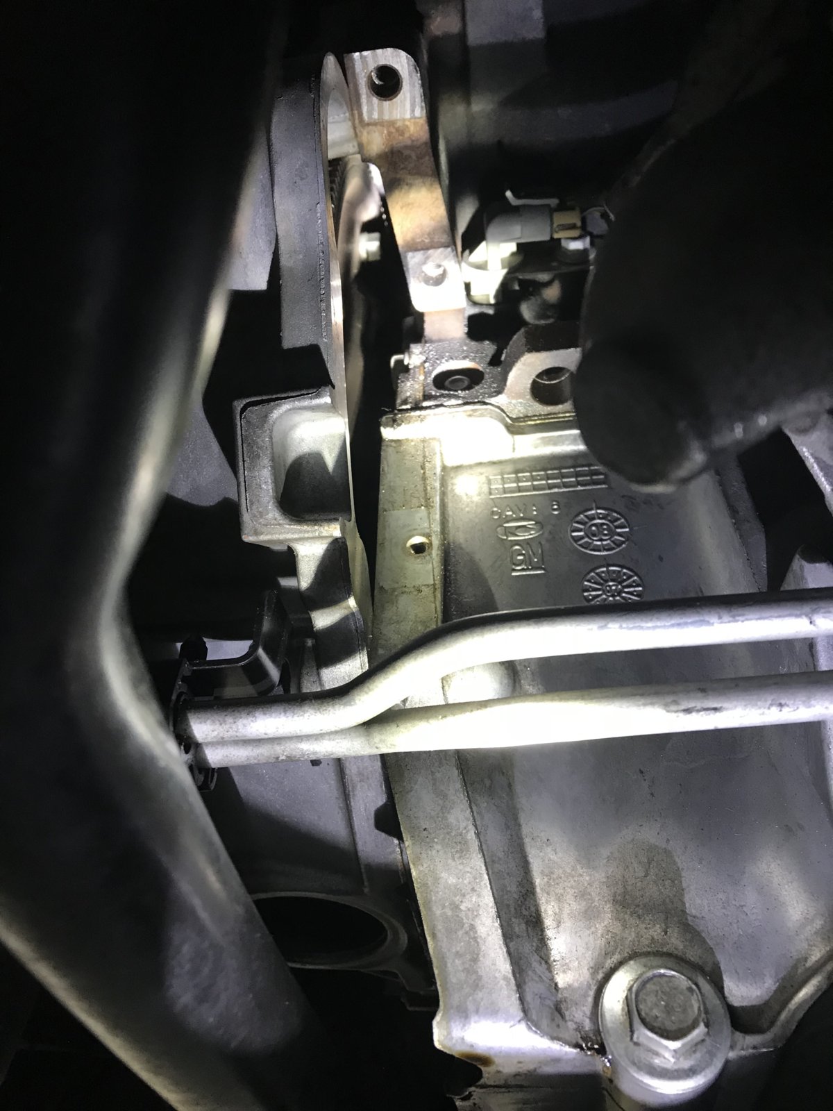

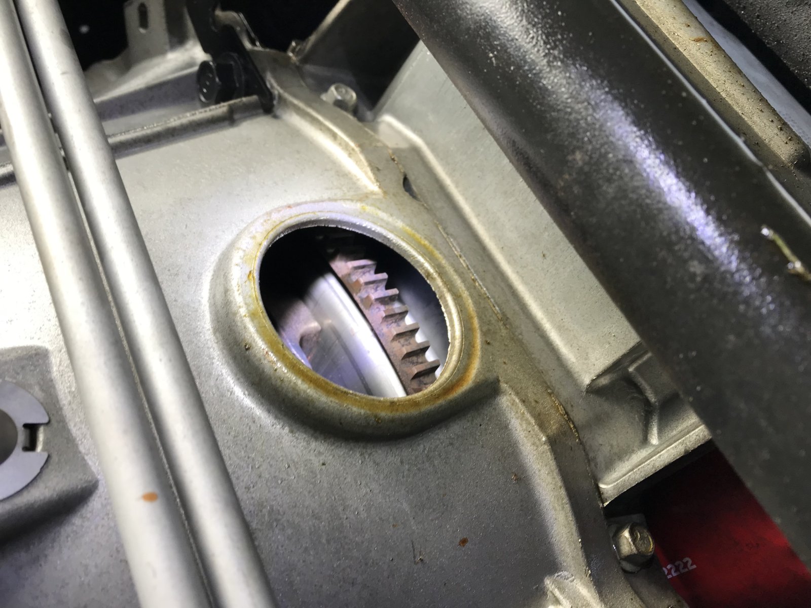

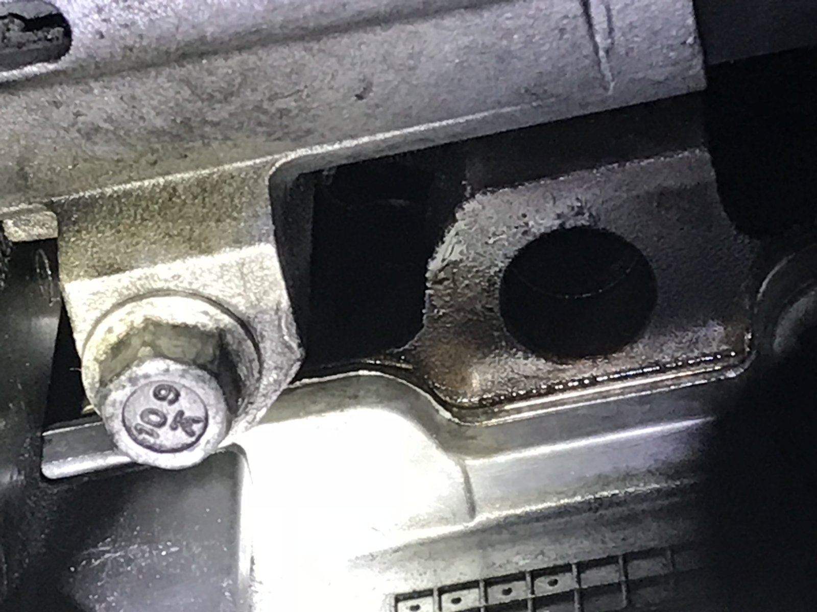

Got under the truck and pulled both inspection covers and luckily I didnt find any oil inside the bellhousing. But that block off plate was a little wet with oil, but also on the starter side it was a bit oily
04CA2169-93A2-4461-BD0F-7BEFA49BDF11.jpeg 4AA78AE3-4FCF-495D-AA59-2939B2B4031E.jpeg F238B37B-7428-4FBB-B43A-67305A6CA389.jpeg 127FADF3-CD14-4E70-9AC6-B5BA8FE80E4E.jpeg
Ordered the gasket for the block off plate and also ordered a new oil pan drain bolt just to rule it out.

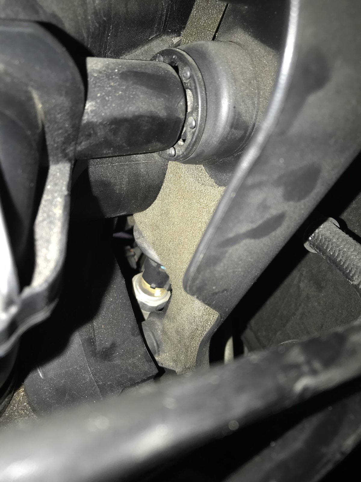

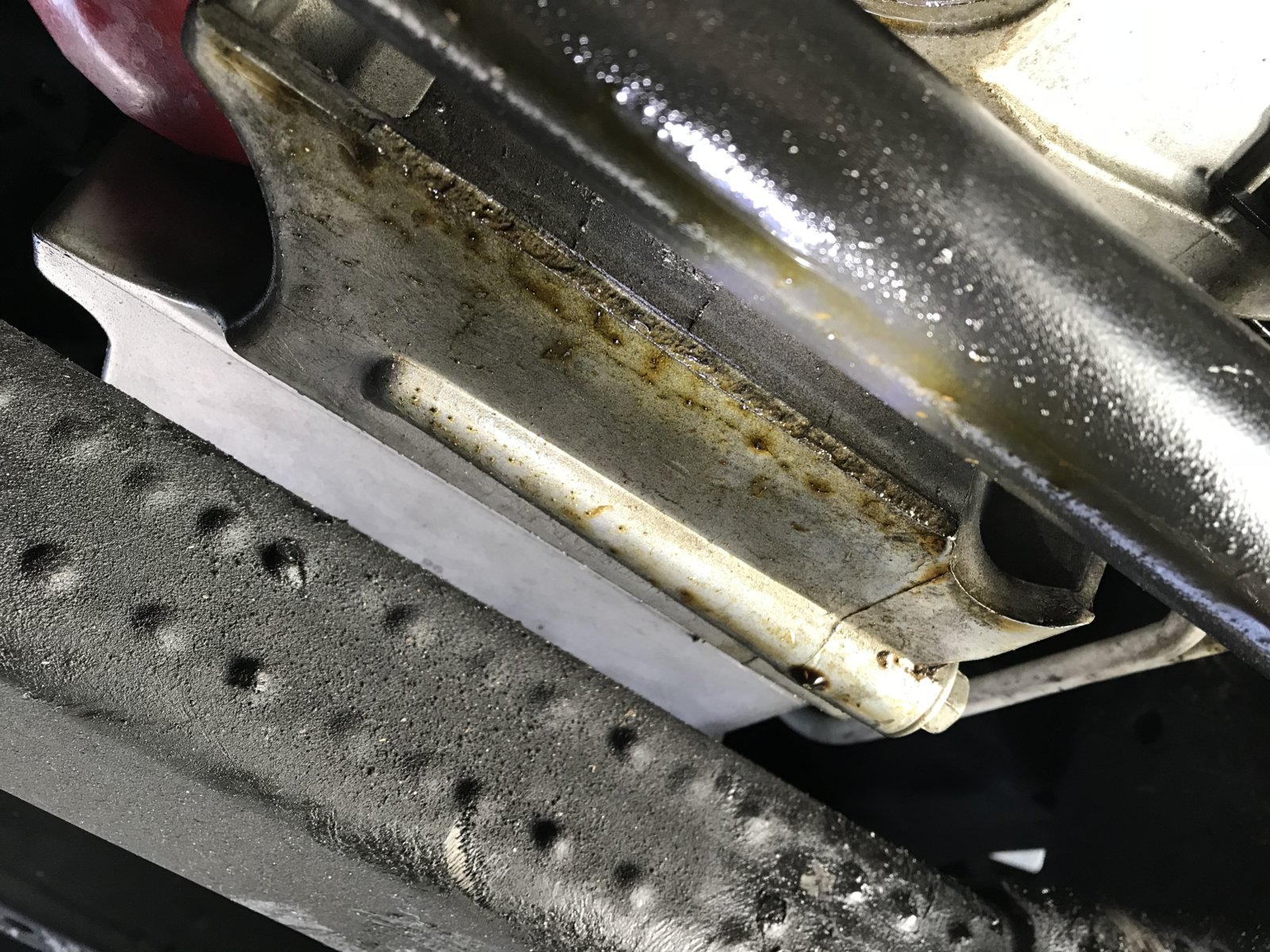

Figures it out.. it’s leaking on towards the rear both sides of the oil pan. Also at the block off plate. Removed the starter to check the crank position sensor but it’s dry. Degreased everything, dried and watched it slowly pool up here

These trucks or should I say these engines, have the PCV valve in the DR side valve cover. I would check that first. Pull off the oil filler cap on the passenger side and it should be sucking while the engine is running. Check with a paper towel. If it is choo chooing like a train, the PCV valve is stopped up. Hook a hose to the valve cover and see if you can suck or blow on it. It should have a small amount of restriction. Mine was stopped up tight and was leaking at rear main and pan gasket. I changed the DR side valve cover and it stopped leaking.

Did the oil pan gasket today along with a new drain bolt and also the gasket for the block of plate and new oil pickup o ring. No leaks as of yet
Mrsteef
Mrsteef
May 28, 2018
81
67
Only hiccup was one of the long rear bolts snapped because the directions I was following for torque specs didn’t say the long bolts were a different torque... seems to be holding up though. I’ll eventually pull it again and change it out. Pan to block bolts are 18ft/lbs and the two long bolts towards the bell housing are supposed to be toruqued to 106in/lbs. Wish I knew that.
