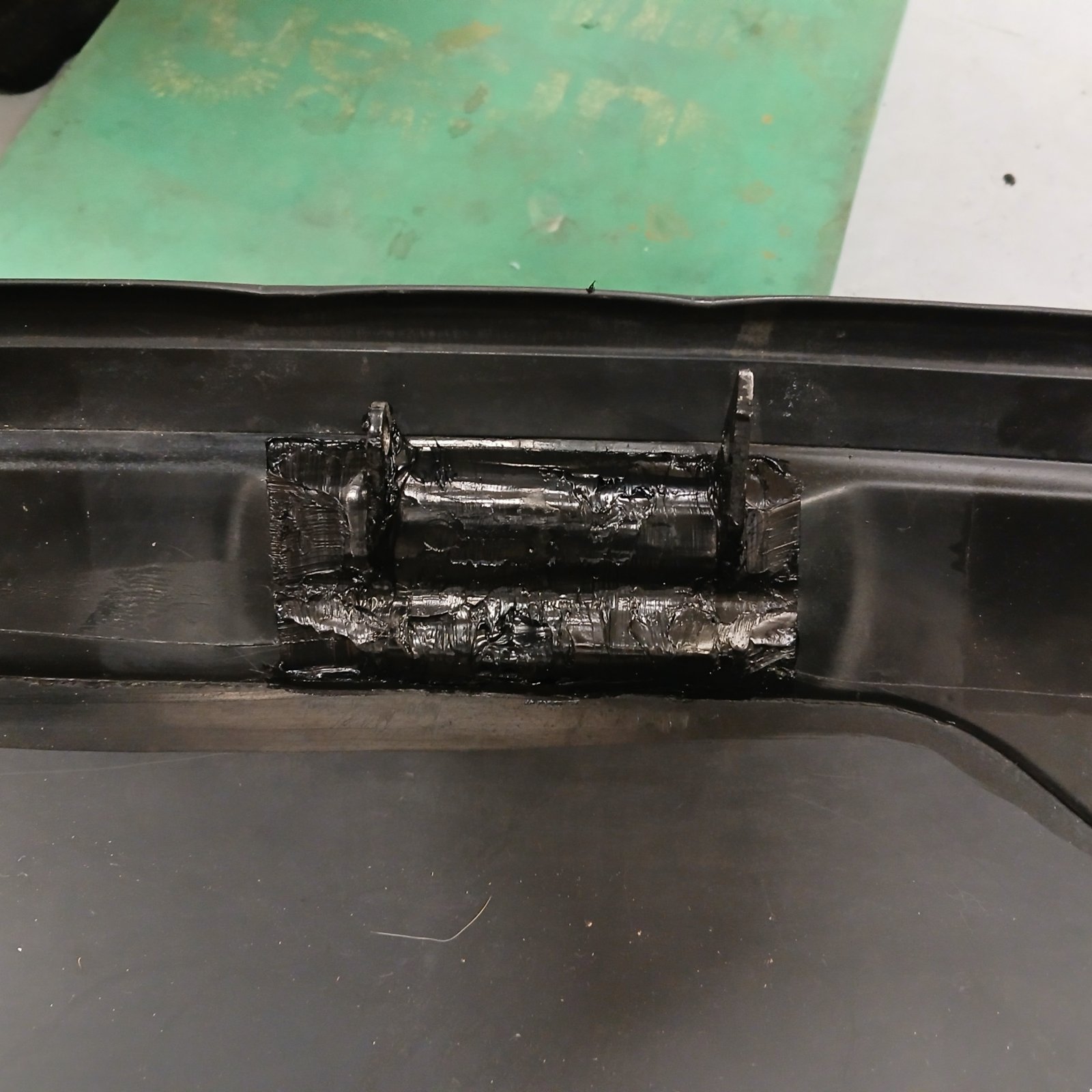

Doesn't look as pretty as factory but hopefully does the trick! I ended up using the 3M urethane windshield adhesive. I VERY carefully removed ALL urethane behind hinge (where mounts to glass. I also drilled out the holes in the hinge that urethane passes through. I think this will provide some extra grip / strength to glue. I did leave some urethane on sides so I could set the hinge back in EXACT position it had been in previously.
I then primed the mating surfaces with 3M windshield primer, applied the urethane and let set up for a good four days (I think you only have to wait a few hours?)... It mounted perfectly back on the truck. Driving it around ever since. I will report back if the repair fails.
I think the correct repair for this would be somehow pin the glass and place a backing plate on other side to hold the hinge. Don't even ask me how to do that. I have no clue, you'd have to drill the glass. Bean counters at GM seemed to have driven this hinge design and didn't do that. Vehicles I see with pinned hinges don't seem to fail.
I know lots of people are using other glues. But windshield urethane is chemically formulated to bond metal and glass. Some of the other methods say they will glue glass but they aren't specifically intended for that application so don't perform as well. Especially in automotive application where the stress and vibration are more.
