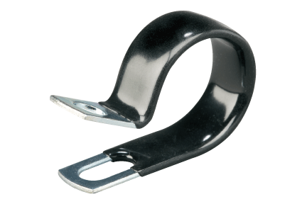

i've got a '97 2 door, 2 wd and I'm having trouble with the shackle rubbing on the fuel filler neck, the rubber part.
How have you guys gotten around that?

In rear you have to unscrew the factory bolt that holds the cargo hook and get a M10 65 mm x 1.5 pitch bolt. then get one of these clamps and tigten it up and will clear the shakle. anything else just hit me back

So his being a 2dr is different than the 4dr and needing that clamp.

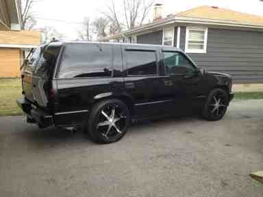

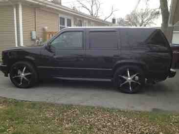

Just finished mine, took 1 1/2 hours.
Sent from a Phone Booth using Tapatalk
Tricky
Nov 27, 2011
495
Illinois
Thanks, funny driving to bone yard now and looking out side mirror and see the rear end lower.
