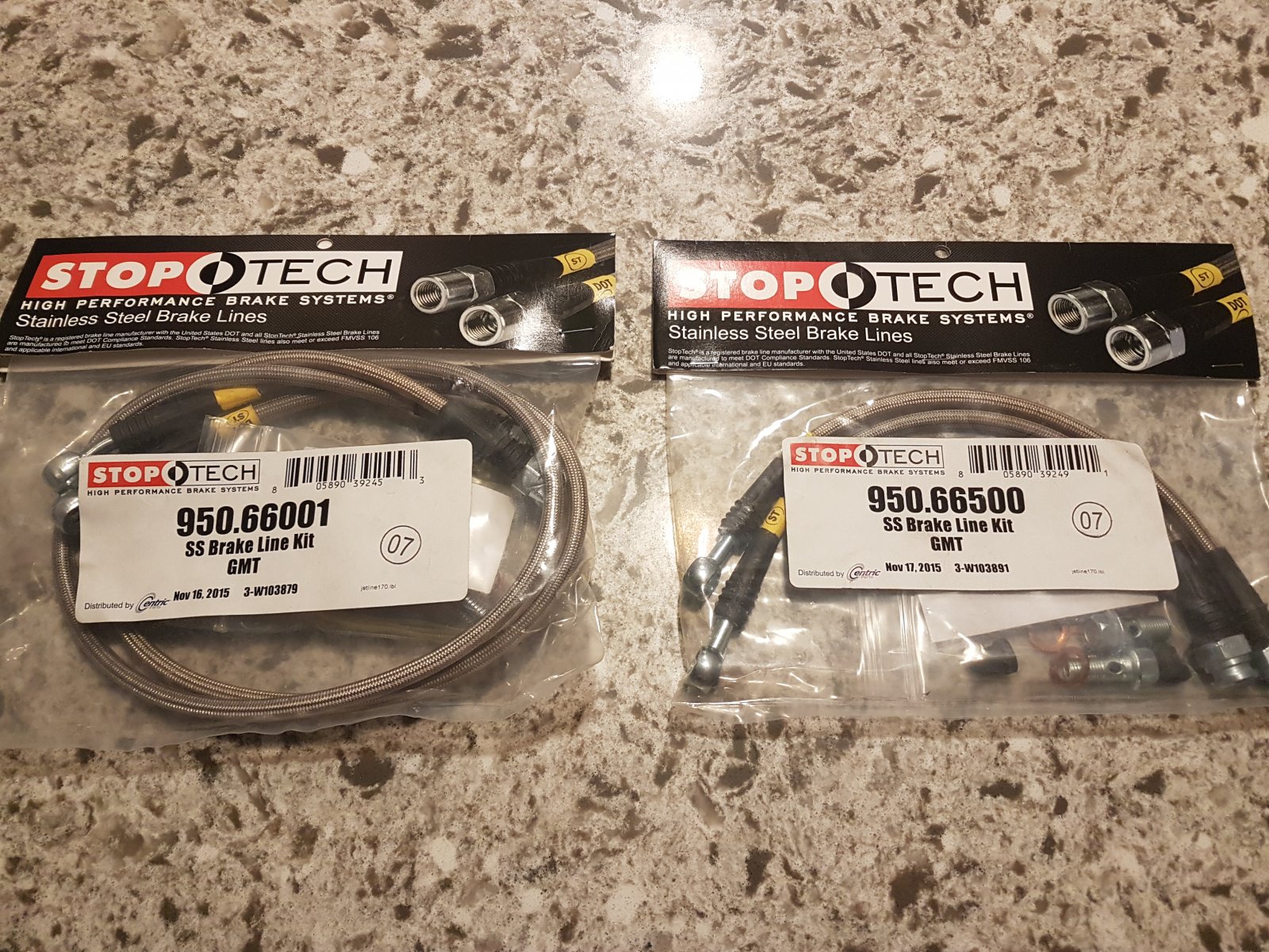

I figured I go stainless if I suck it up and do it myself lol. Also do you know which one is for the rear? And as always thank you for taking the time to help.
950.66001
950.66500

You should always replace both sides when doing brake hoses if the hoses have been in use >70K miles. The hoses for these Tahoes are $15 at worst. They are all made by the same Chinese company.

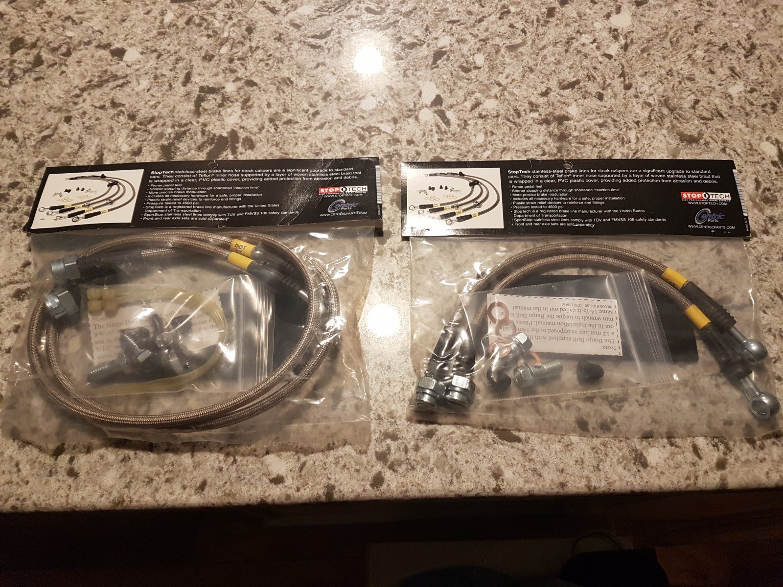

Thanks Guys. I took Tony's advice and ordered the stainless steal rear hoses. Now just have to wait for a nice sunny weekend to replace them.
