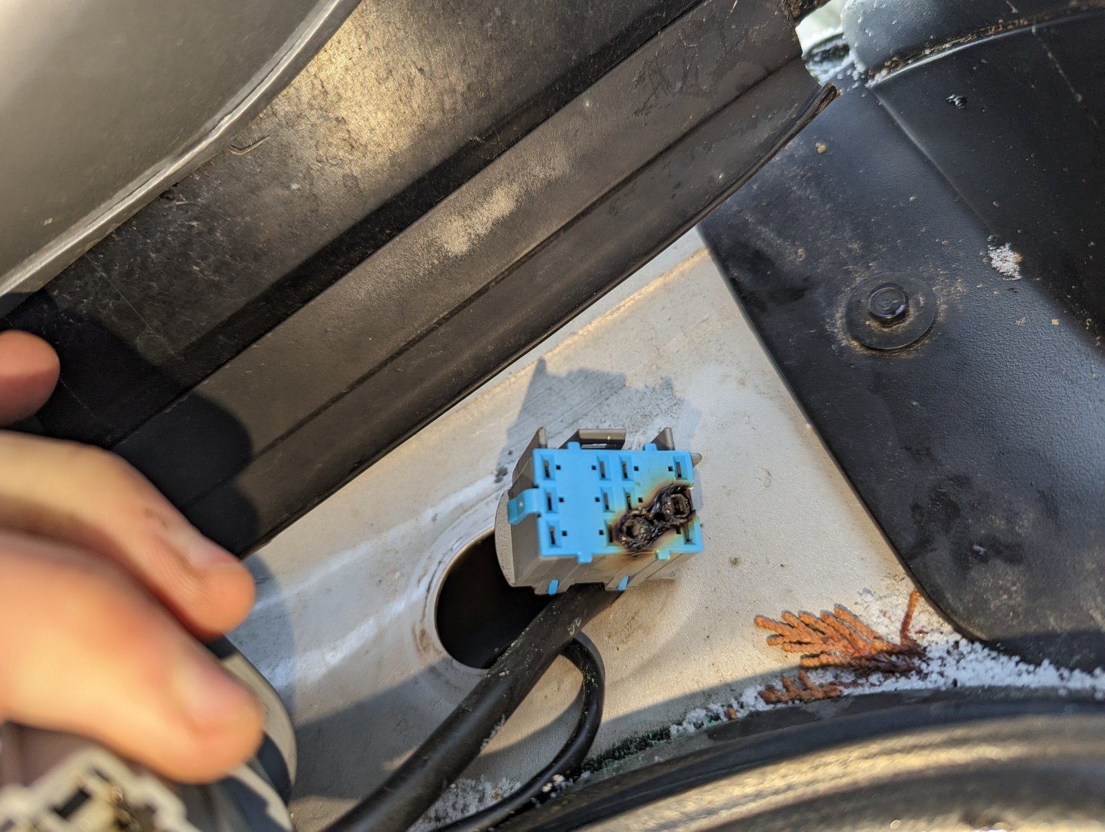

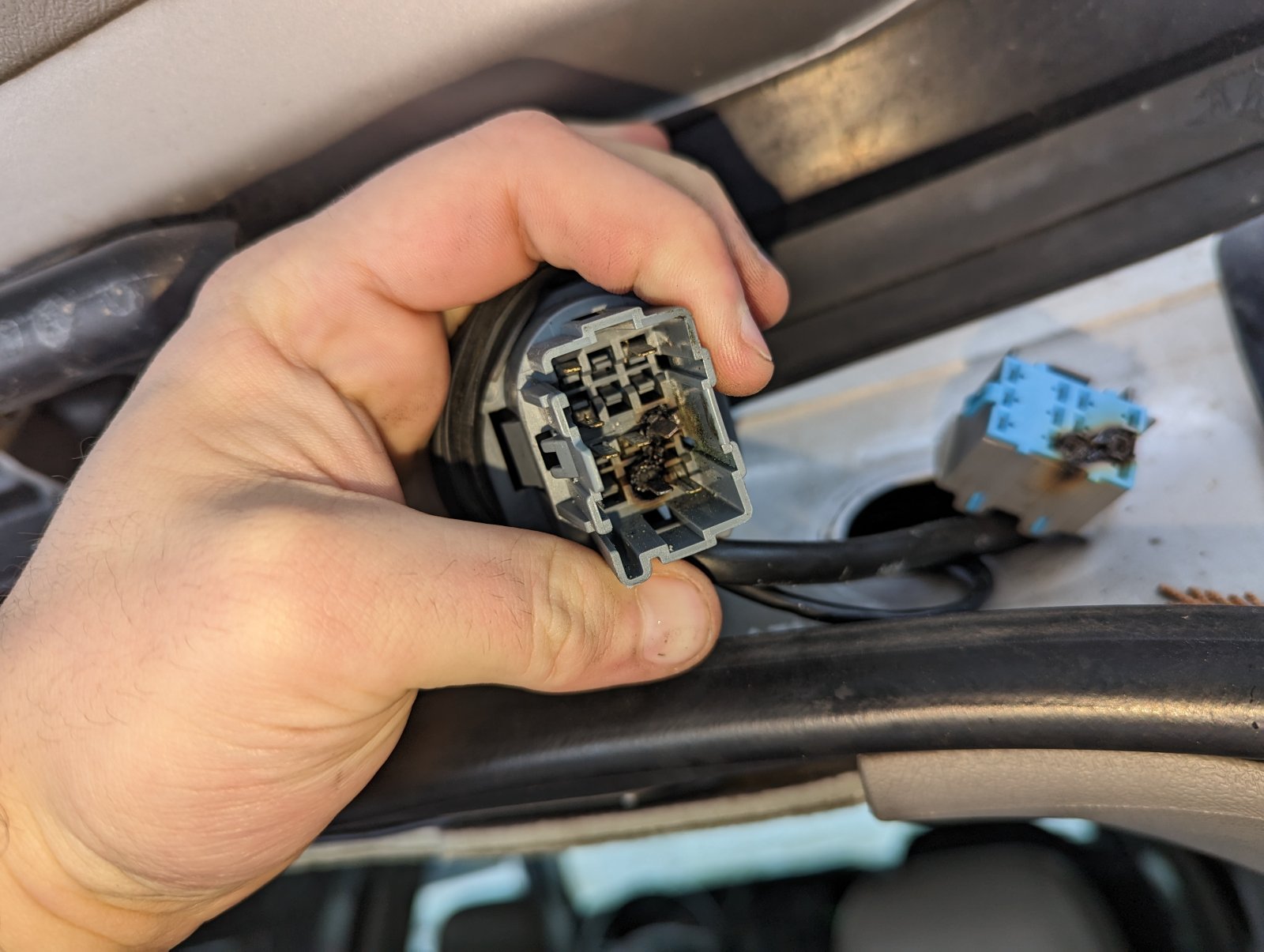

Well..... I Noticed my rear defroster ain't working
Fuse under the hood has power
Rear cables have power when disconnected from the defrost tabs
But when connected to the tabs, voltage at said connectors drops to 0v. Not even 1-2v, friggin' 0.0v. Like... dammit....
Wiper is fine. Defrost, is not.
I reckon I need to start tracing wires and looking at connectors. Anyone have insight on junctions / plugs / ground / places to look? It's cold and snowing outside and I'm not much looking to rip apart my interior any more than I need to

Well
She'd dead, Jim
Gonna need both sides of the harness. Can I get a hand tracking down part numbers? My google-fu is weak on this one and I'm not turning anything up

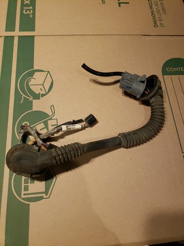

Kind of
It's the hatch-to-body harness connector. Body side, by the hinge
Looks like there's a sub-harness that has the hatch side covered
But I cannot, for the life of me, find the chassis side
Grrr.... If this didn't interface with a weather seal, I'd just do my own harness with some beefier bits

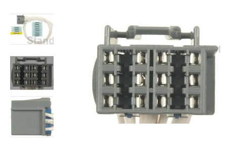

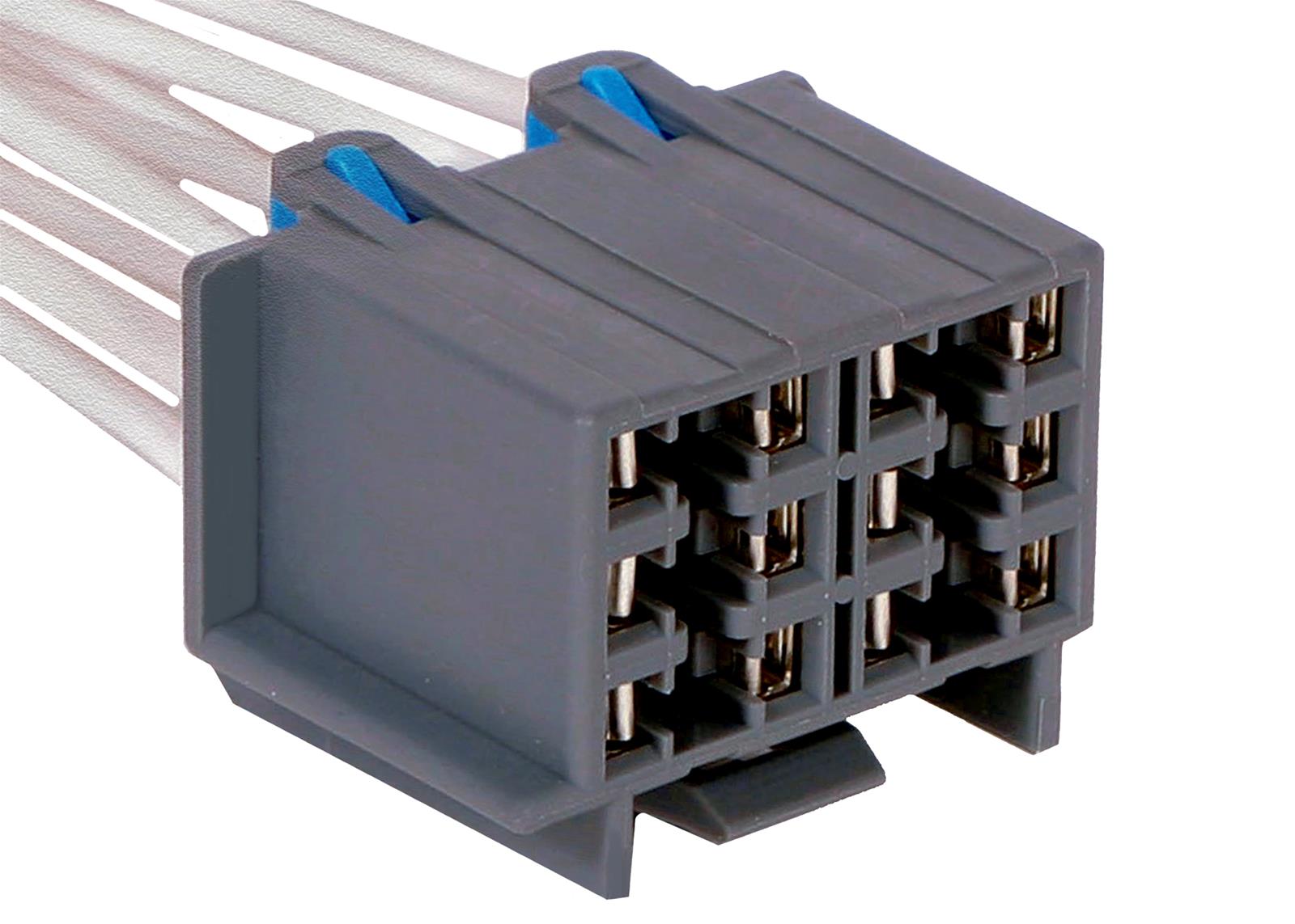

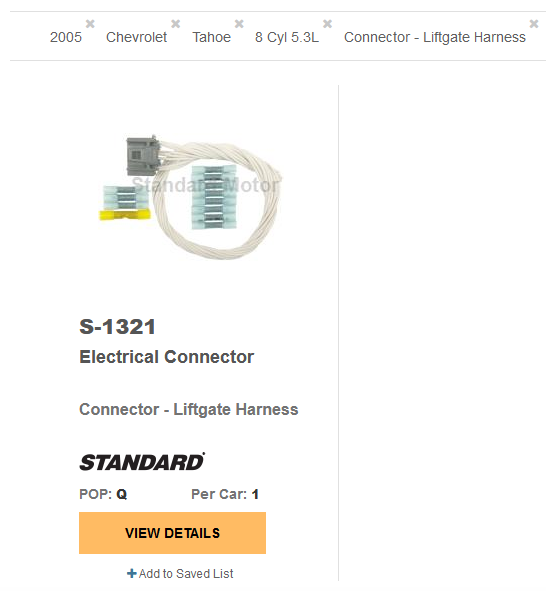

The closest I see is the Standard Motor Products S-1321, but it doesn't seem to have the pin guide blue cover on the female connector. Look it up and there are additional pics online.
Nice thanks!
Managed to find the OE one
But even that doesn't have the pin guide. Strange
Can't seem to find the actual harness anywhere though. I hate cutting wires and rather just re-harness and be done, but I can't find a part number for it anywhere. Grrrrr

All I see for the liftgate harness is GM 15118093. Good luck with availability if that's the one.
EDIT: maybe 40438, 121165, or 15173014 SWAGes

Found the lift-gate side I think.
