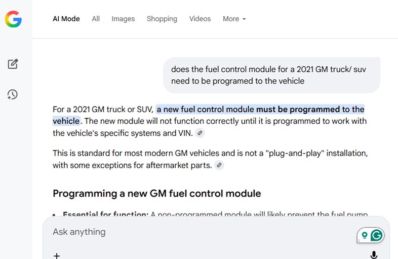

Google AI ( which admittedly is often wrong) says it must be programmed to the VIN. See link to search below.
Here's a screenshot if anyone is too afraid to click the link.
So who knows, maybe try swapping them out in the driveway since you have one, and letting everyone know if the truck works after the swap without programming.

There are multiple YouTube videos of people swapping them without programming them.

Check this out. 5 minute mark to 8 minute mark. 2022 Silverado. Plugs in new unit and fires it up.

Interesting for sure.
Be the first time GM actually made something simpler for the 21+ stuff compared to previous models. Unless the dealer dude bought the part from programmed it for him too, but you'd think as much as he talked in the video, he would have mentioned that if they did.
Have you tried / tested your spare module to see if it works plug-n-play style?

I have not. When do I’ll make a note of it for reference.

Tasca parts (a reputable place/ online retailer to get real OEM parts) sells these modules for $26.57 (plus shipping and tax of course, link below).
Looks like this same part fits 102 different GM vehicles (even those with baby Duramax diesels, all the way down 1.2L turbo gassers and everything in between), so not exactly rare.
If they work play-n-play style (which would be amazing considering all the different vehicles and engines this same part fits), it may be worth throwing one of these modules (and a few zip ties) in where the jack is stored. It would sure beat waiting for hours on the side of the road for a tow truck should it fail (which they are known to do).
