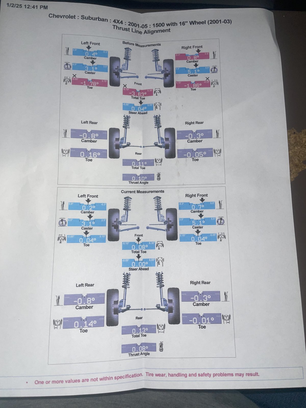

suburban had her maiden voyage today! Brakes feel great. Drove across my side streets. It was REALLY sketchy, the tires were skidding and it was all over the place, steering loose. Hopefully the skidding wasn't a brake sticking(it did stop later)Came back home and the alignment was soooo off enough to where I thought I'd have to have it towed to the alignment shop, usually I dont eyeball it that bad. Both tires were extremely towed out, so I brought the tie rods in a LOT(and they're still slightly towed out, that's how bad they were). The camber and caster is still terrible, but I brought it for another ride down my side streets and it's good enough to get to the alignment shop. No more skidding or weird noises. Hopefully the alignment is causing that skidding. All the wheels spin freely, so I don't think there's a brake sticking?

Make sure to get a copy of the before and after alignment settings printout. Post pics of that here, please.

Will do! Want to make sure it’s done right. What are the factory specs for alignment on these?

Well it's going for alignment today, took for a drive to get gas. Still very sketchy riding right now, when turning the wheel navigating the road, the left front tire screeches bad. I jacked the truck up again and confirmed the wheel spins with no weird noise and theres no play in anything I installed. Must just be terrible alignment causing the tires to hit the ground in a weird way.

Well the screeching was indeed the tires because it was so far out of alignment. She’s all set and drives pretty well now! The abs light comes on and off for some reason, I’ll have to pull a code on that once it happens again.
I’ve attached a picture of the before and after measurements. Let me know how they did.
