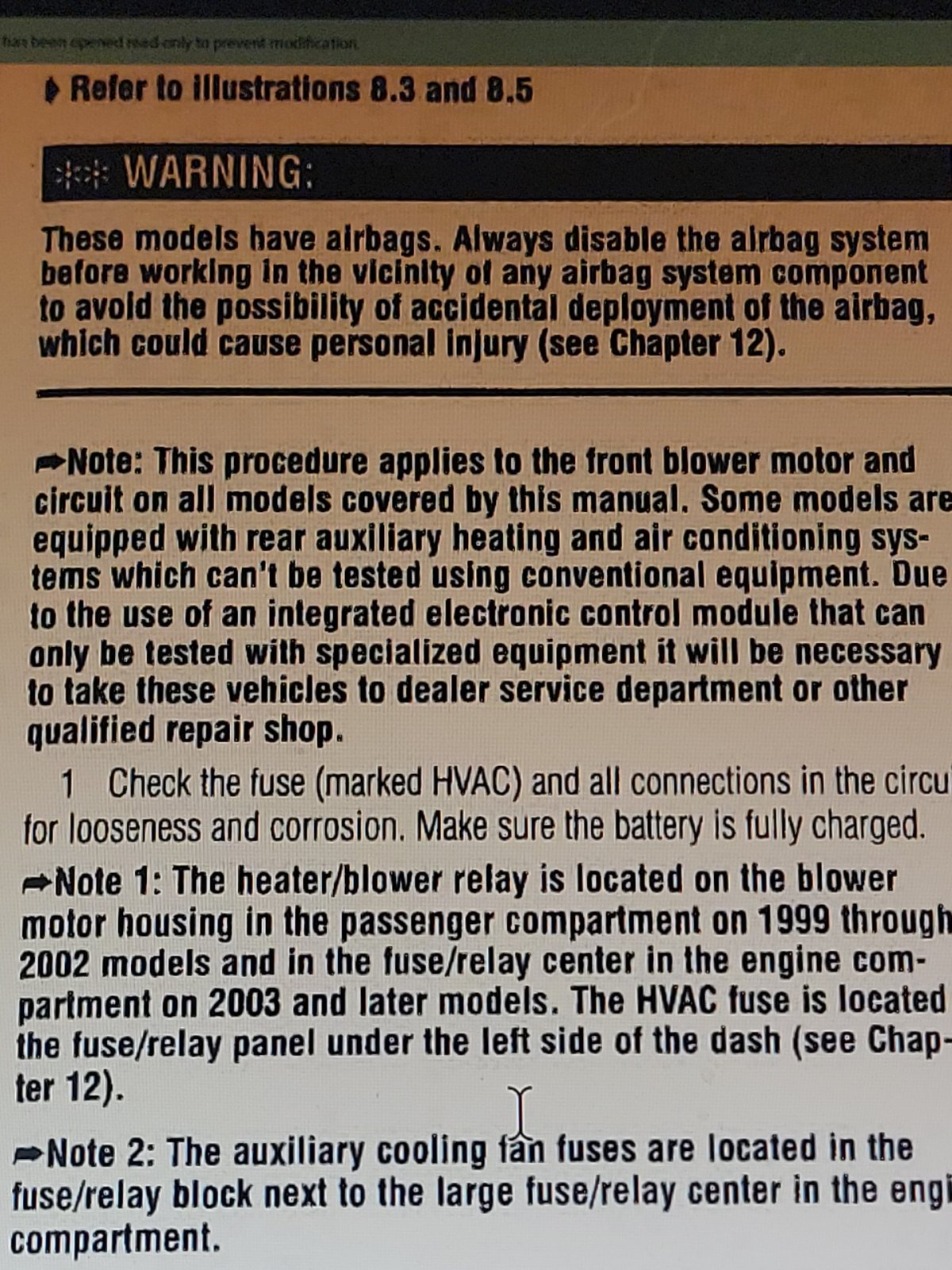

Time to get out the shop manual and bi-directional scan tool and follow the troubleshooting guide after pulling the internal
No lie, book says with this issue take it to a dealer/ shop with equipment to troubleshoot it. Ill update when i get a solution.
