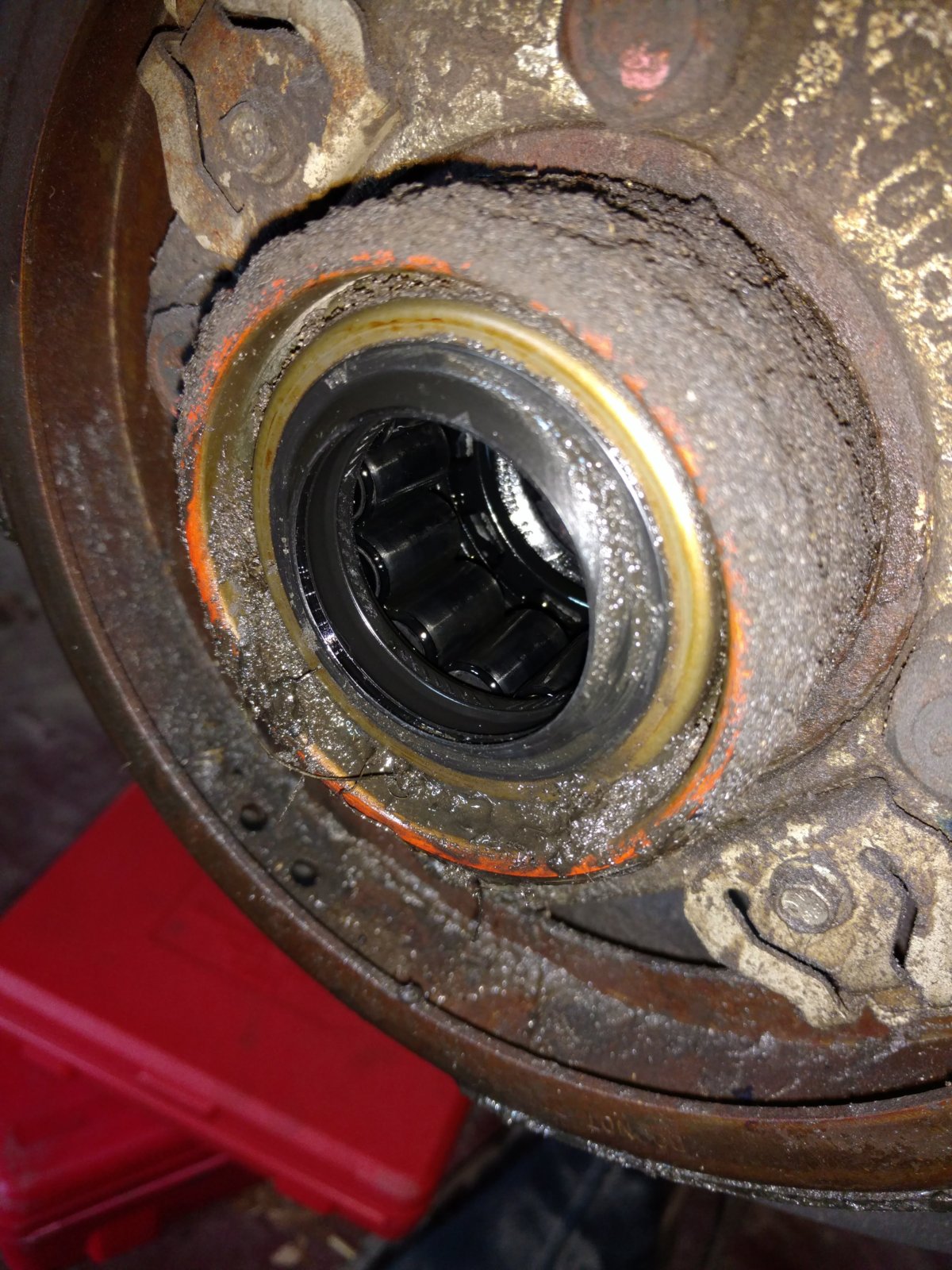

So this is my first vehicle with a solid rear axle. The seal actually looks fine to my inexperienced eye. The shaft has some grooving in it where the seal was though.
If the seal really is fine (I'll replace it anyway, obviously) and not causing the leak, then the next suspect seems to me to be oil sneaking past the grooves in the shaft. I assume there must be some remedy for this short of replacing the otherwise-fine shaft? Fine sandpaper all around?

Mine had one groove, just wiped it down and put it back in. No leaks so far. I wonder if all that mud and debris did your seal in? Ohh, forgot to mention that the oil probably ruined the parking brake shoe on that side but you'll know better if it still holds the truck still afterwards. Mine was soaked on that side and both were glazed over. Someone previously probably drove around with it on and overpowered them.
We have a 120 mile round trip tomorrow so I'll take a look at it on Friday and see how the new seal is holding up.

Seal may look good but its def done, riding in the same spot for so many miles, new one will be tighter just be sure to be very careful sliding axle back in, dont just shove it in and slide along seal, support it the entire way, as in, don't stop half way and let it rest on the seal or even withe the spined ends, when you first put it through, very easy and slow. I take some new gear Oil and run it around edge of seal before insertion....
X2, for what its worth I would also change out the bearings aswell since you are already there.
