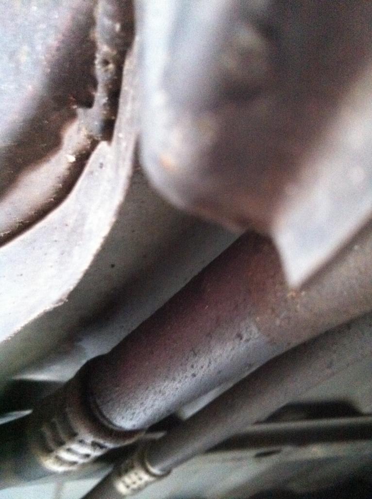

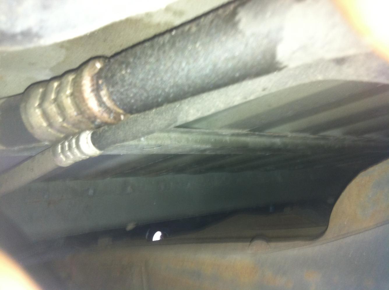

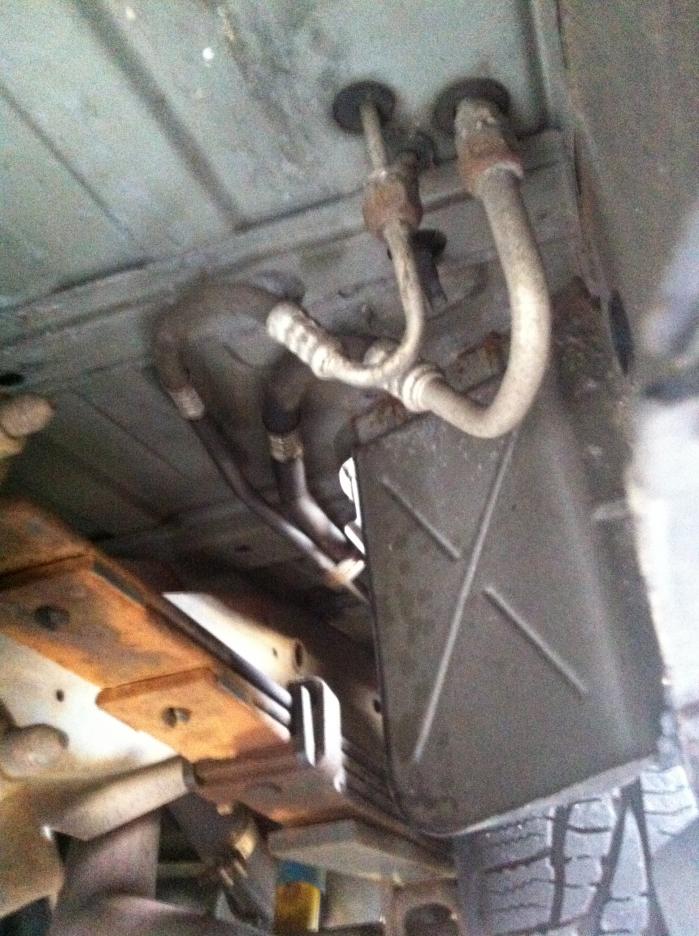

Thanks for the reply sunlitcomet!
I attached a few pictures of the hoses. The wider one seems to be the culprit.
You can see still see the stains from the last attempt to recharge the system, it all leaked out in about 5 minutes.
Also, do you have any idea how much a repair like this would cost? ball park of course
Thanks again!

The one that ends in 50 appears to be the correct one. Other than the cost of hose replacement you will have to find a local shop to discharge what is left in the system and when you are done ave it evacuated and recharged. I shop will probably discharge for free. But will maybe charge less then $125 to recharge and test as long as you cap off the hose/lines from front right away you can probably keep the accumulator /drier you have now.

Not looking good so far. The part I received (ending in 50) attaches perfectly to the rear evaporator, but looks to be about half the length of the hose that is installed. It is still at the mechanic, so hopefully he can work some magic.
