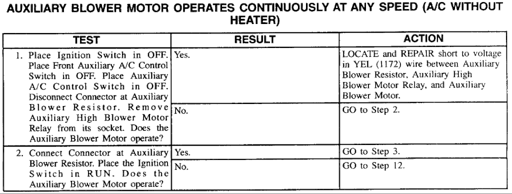

As for the rear blower, here are the diagnostics from a 1998 for the rear blower operating continuously. I'm not sure how you get the switch out of the headliner, but it seems like it should just pop out.

That is fantastic! Thanks!
I need to pick up a test light. When they say cavity they're talking about pins in the connector?

Yep. Or use a multimeter and see if you get voltage.

Looks like I might have a bad resistor! Unfortunately it's been quite awhile since they were made. Anyone know where I can find one? Part gmc 15 80835
