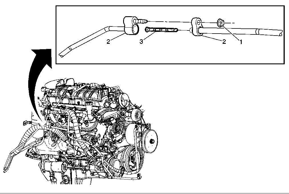

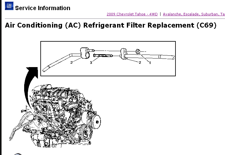

there is an ac orifice tube that could block the flow of refrigerant to the rear evaporator.
that's in the front.
It's somewhat of a weird looking thing, really just a screen.
When I did my AC I ended up just cleaning it and reinstalling since i couldn't find a pn listing for it, then it turned out to be a metal screen.
I checked my FSM for mention of a expansion valve in the rear, and there is one.
The "filter/Screen" location
