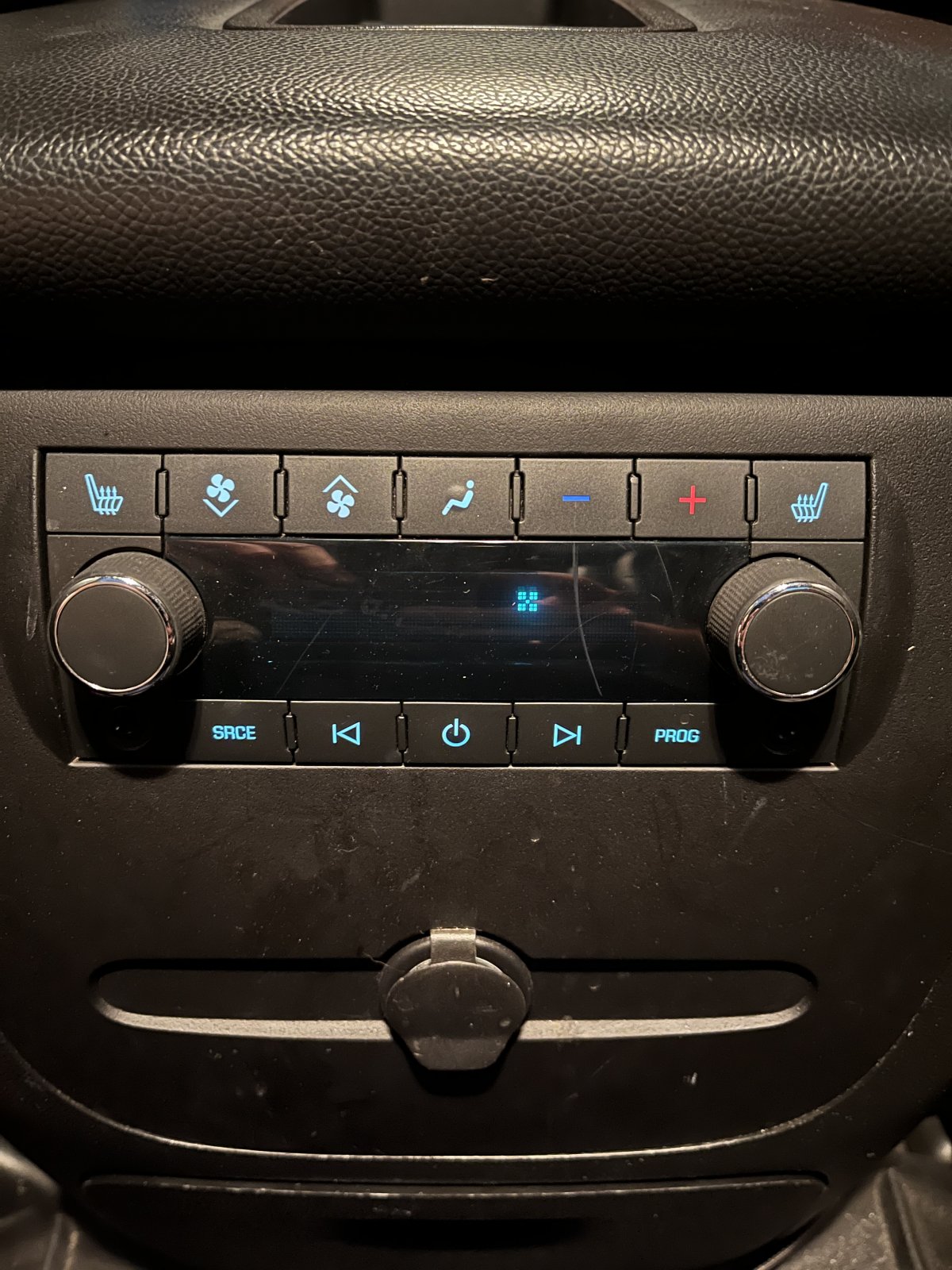

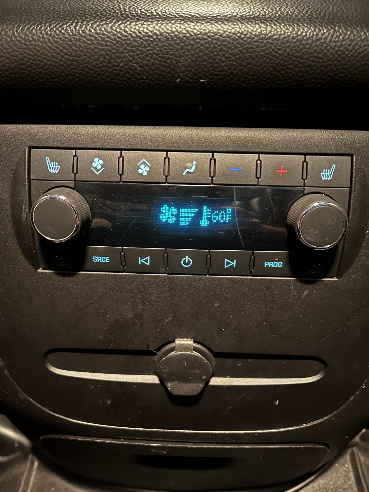

Also, the rear climate control panel seems to be doing strange things. When any button is pressed, it'll show the full display of temp, fan speed and vent selection. After about five seconds, the duct selection part goes away. It'll come back and respond accordingly if you press the button to cycle through the options. Pic with it missing:
After about 10 seconds, the whole display goes blank except for this:

I'm not in a huge rush to get into deep diagnostics with it yet. Just fishing for ideas. I'm thinking I should start with the control panel since it appears there's a definite problem there.
