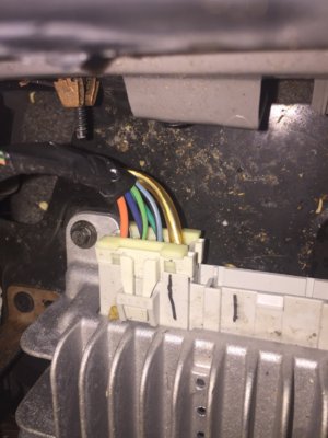

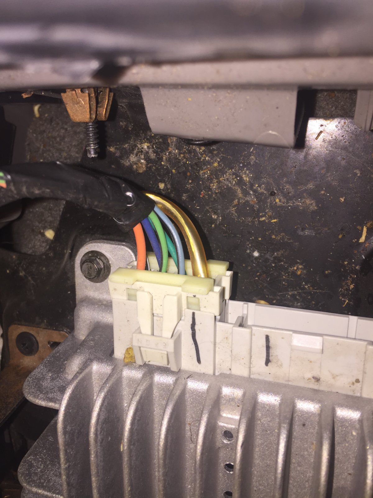

What I need is to know the pin out at the amp that will turn it on. I assume I need to hit it with a +12v in one of the wires, does anyone know what one? It’s a silver amp with 2 connections. (see photos)

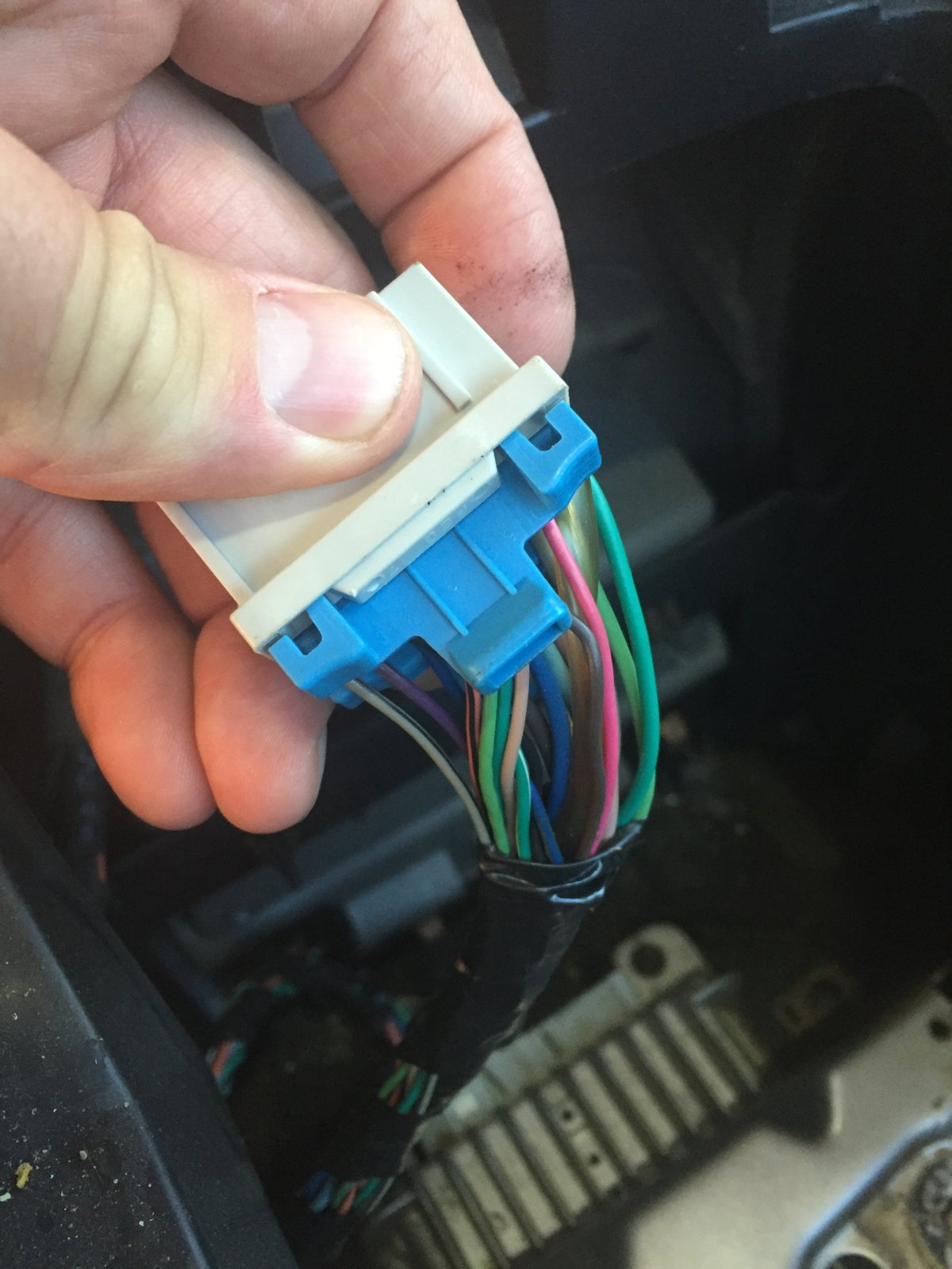

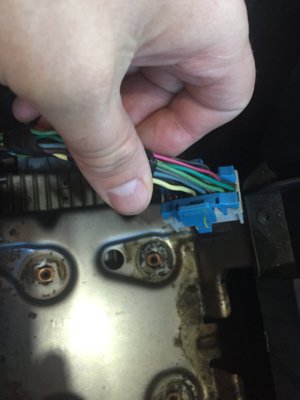

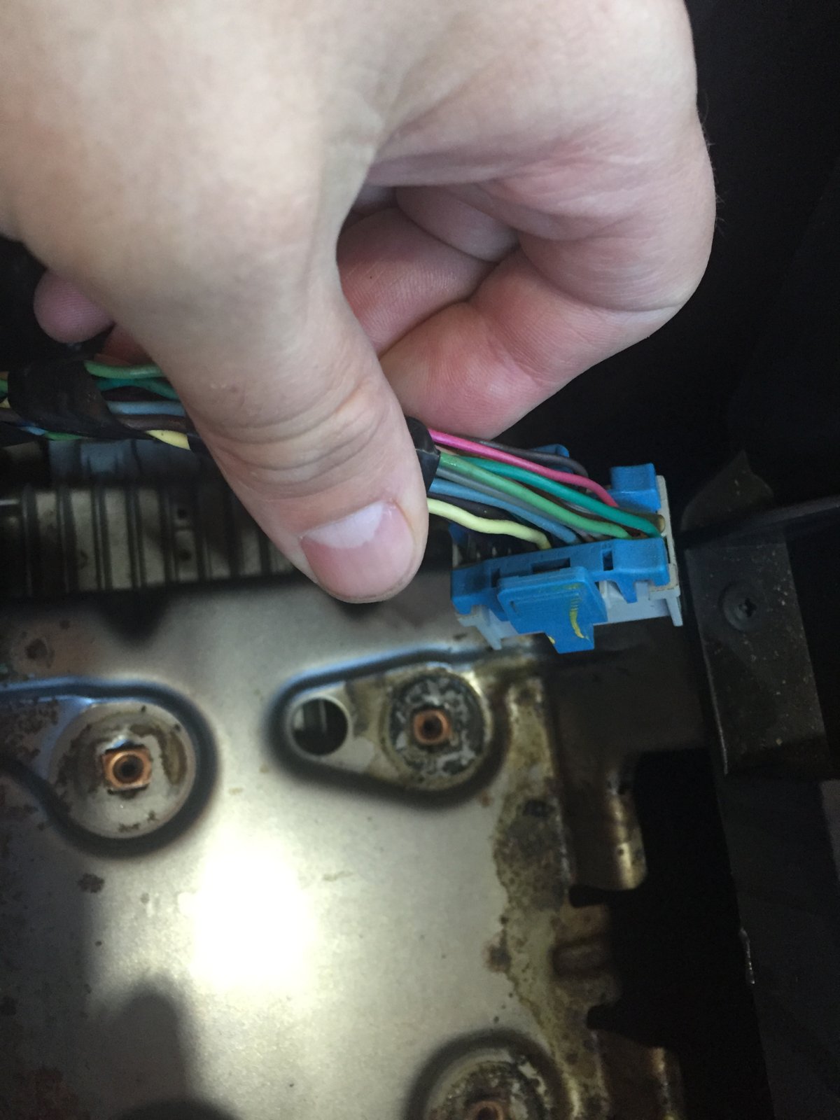

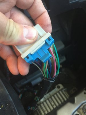

So its the pink (ish) wire at the head unit plug that when hit with +12v turns on the amp. i did a redneck fix and just made a jumper cable from amp on power up wire on the head unit to the pink wire in the factory harness. Seems to work pretty well by i am still going to order the RP5-GM11 so i can use the steering wheel controls. I'll let you know how it works out.
