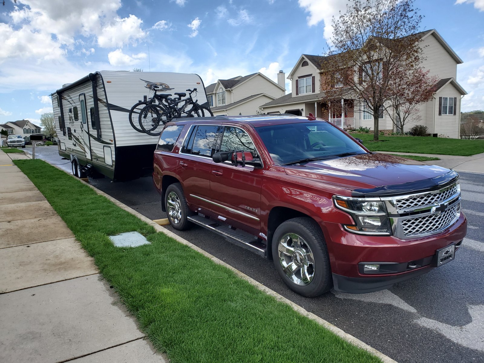

Thanks for the feedback guys. Trailer is about 25’ hitch to bumper and weights about 5500 fully loaded and I will be using a WD system.
Lyon
Aug 2, 2014
604
23
With that set up you should be just fine with the RST Tahoe. You might even prefer it. The new 10 Speed transmission is really nice.

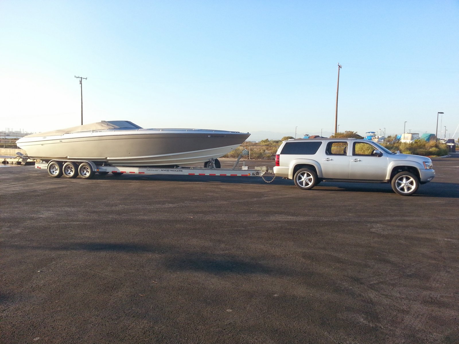

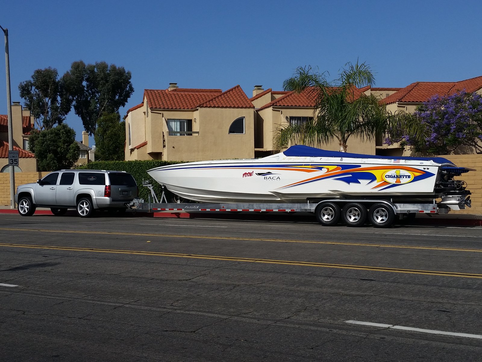

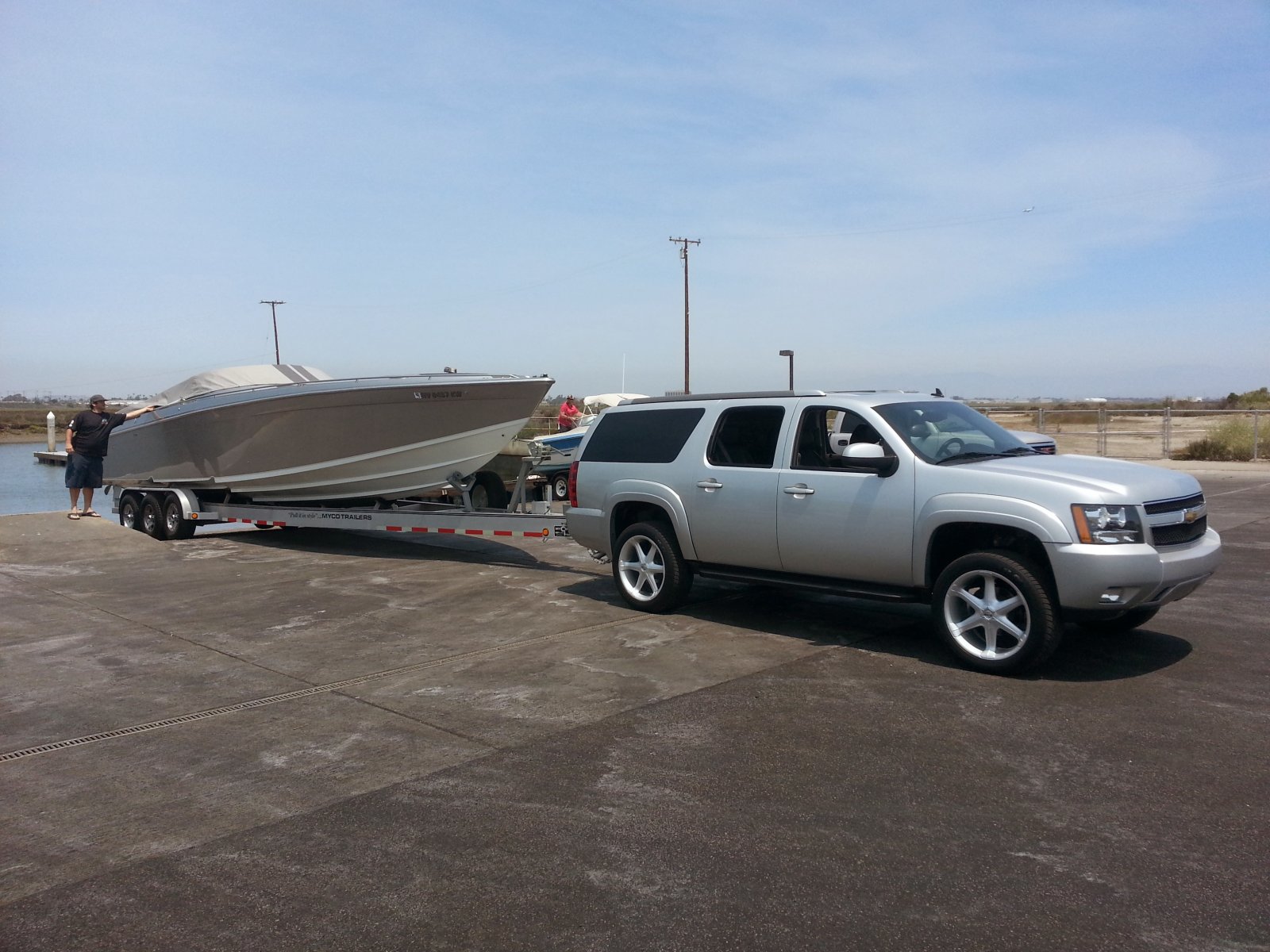

I think the Suburban/Yukon XL pulls pretty good, I think the extra weight in the rear seems to help grip better pulling a boat up the ramp etc vs a truck with an empty bed.
Never had any issues pulling my boat which boat and trailer were probably around 9k lbs.
With my old Suburban I pulled a couple 38 footers just local around town, definitely relied on the trailer brakes working properly for those moves! The silver Formula in the pics attached was a 38 Fastech with Arneson Drives and the thing probably weighed 16k lbs boat and trailer. Was a heavy you know what! Sub actually pulled it fine, however stopping was relying on good trailer brakes and a good amount of distance.

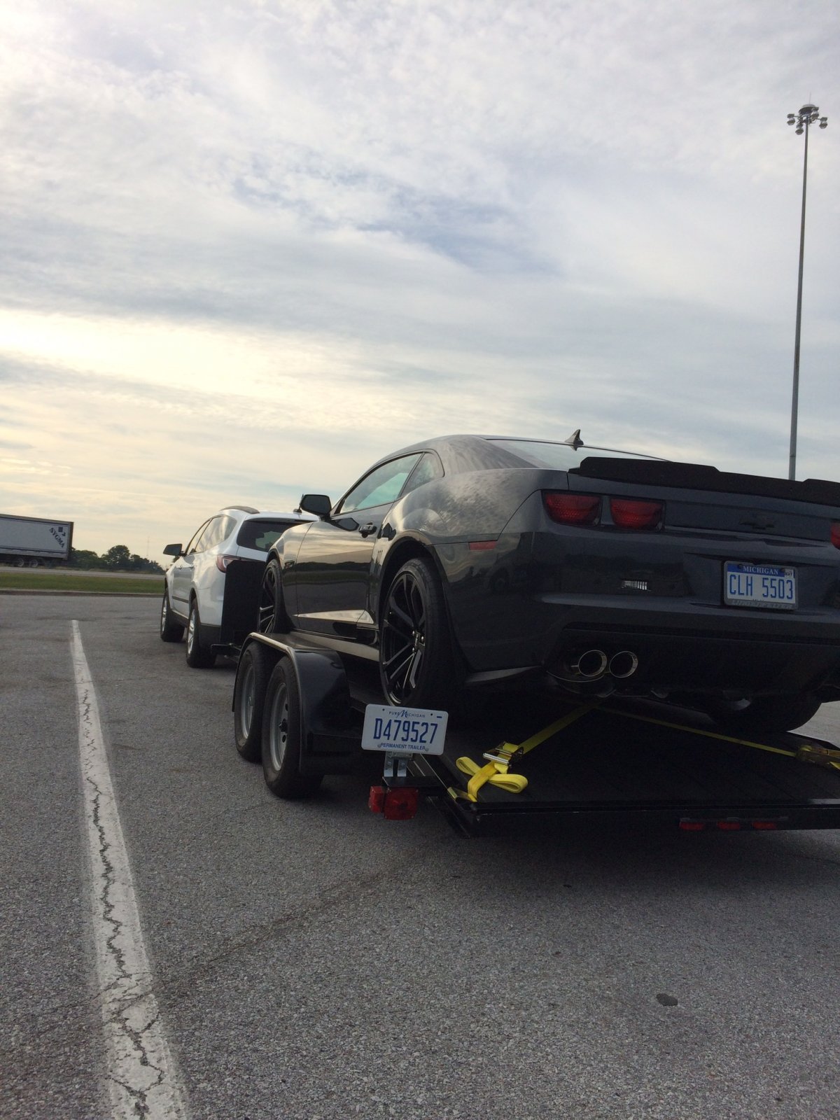

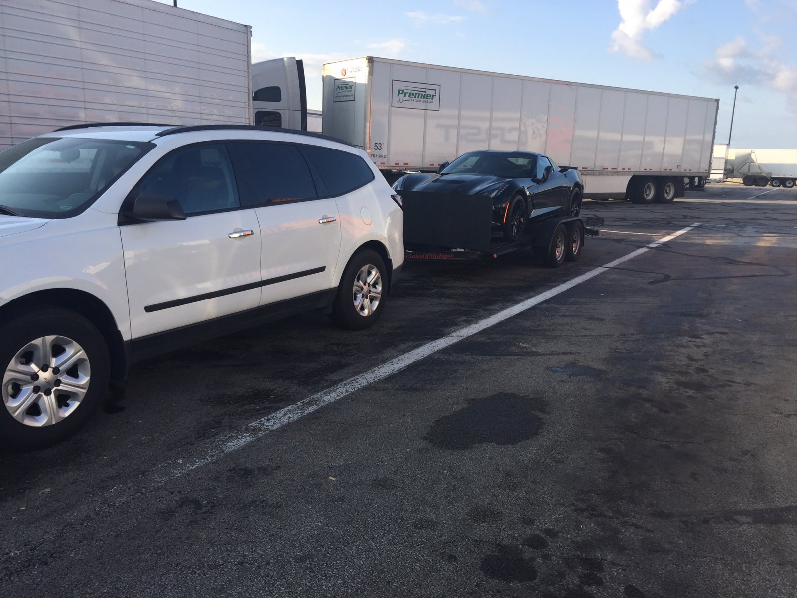

No need to worry. My 3.6 Traverse did the job, the 5.3 Tahoe doesn’t even feel like it’s pulling anything. My trailer is about 1900 lbs, camaro is about 3,900 lbs and the vette is about 3,400. Tahoe went through the PA mountains last August, fully loaded and towing, AC blasting, no sweat.
